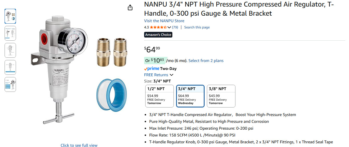

The pictures of the regulator. It looks like 3/8, but I have been wrong once or twice. That regulator looks to be 3/8 NPT. Get a larger one. At least 1/2 or even 3/4 inlet and bush it down. The orifice inside that regulator is like 3/16. It’s definitely restricting your flow. Pressure is one thing, but you need flow and pressure.. Ask Jimmy @ChelanJim I love spending other people’s money :money_bag:.

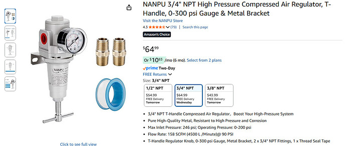

This is a good one. I have used it for years.
It is like the old saying, “You get what you pay for.”
I have this one and it is very good. It is just a regulator:
https://a.co/d/0oZ2OT1

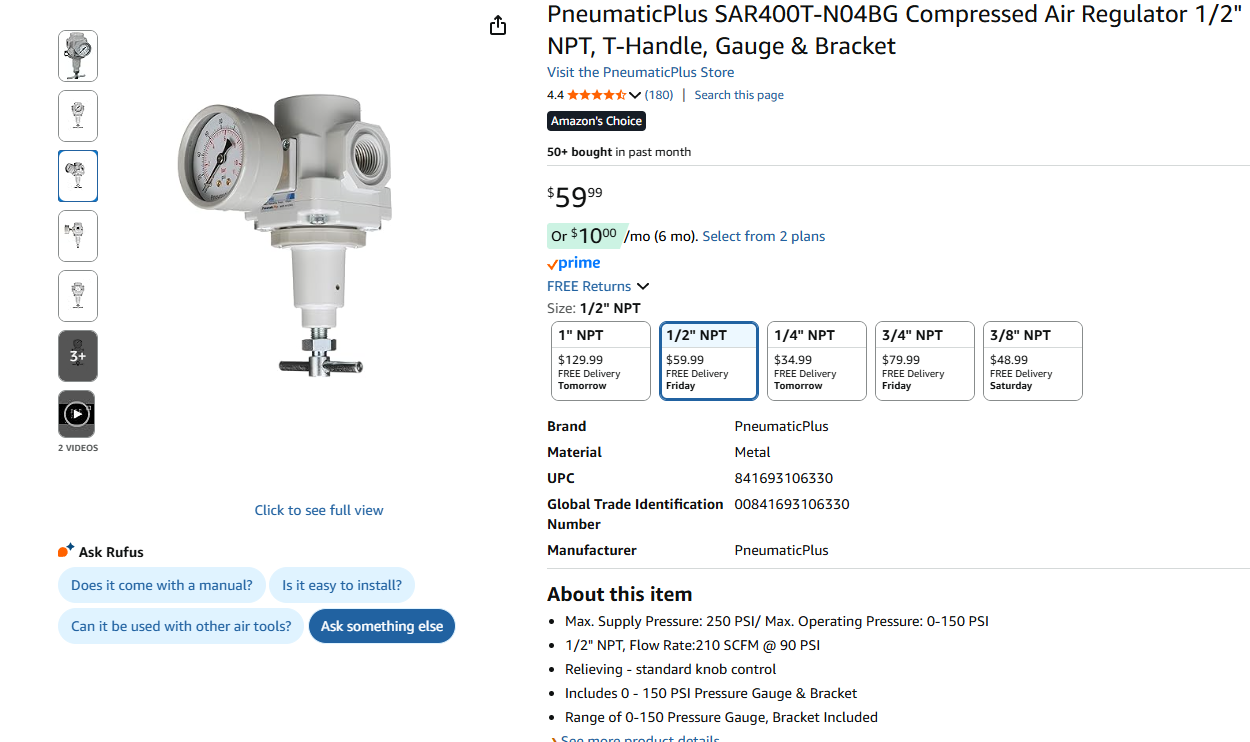

I also have this one:
https://a.co/d/9f9kZPj
