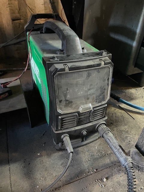

Crossfire pro Everlast 102i air pressure dropping too much?
Alright, I have the 102i with duramax torch and hypertherm consumables, an 80 gallon Puma 3 cylinder air compressor 140psi off 120 psi on. I’m running about 15’ of 1/2” id air hose with a harbor freight air dryer. I have a new 1/2” input/output pressure regulator on the back of the 102i which replaced the unit that came with the machine. I have tried bypassing the air dryer, but pressure drop did not change.
My problem I am having is mostly during the pierce on 1/4” and 3/8” mild steel, metal shoots up at the consumables during the pierce and builds up on the shield and its no bueno. I have done all kinds of testing on pierce delay and pierce height. I have to have the air pressure set to 87 psi to see 74 psi when the torch is flowing air. If the pressure is set at 88 psi on the everlast it will go into a no torch fire mode. I have been able to trick the air system which allowed me to run 77-78 psi on the torch when flowing and the piercing was consistent and worked wonderfully. I am at 4,000 ft elevation and relative humidity is pretty steady at 15%. I know I have more than enough air compressor based on research.
Does this air pressure drop seem too much with the air setup I have?
Is there something I could check that is common that might block air flow and create the 13 psi drop when the torch fires?
My goal is to get the pressure not to drop so much upon cutting. Thanks.

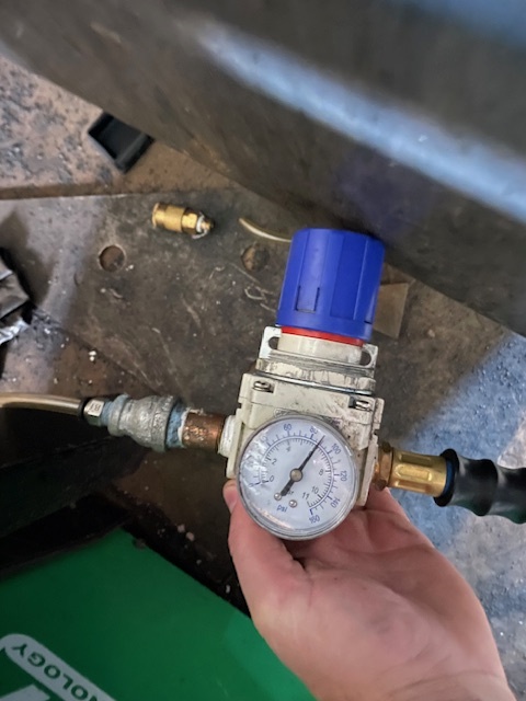

I currently have 13psi drop with the 80 gallon tank full (140psi). Can anyone tell me the psi with airflow off that you have to achieve 75 psi while air is flowing so I can confirm my air pressure difference is out of the normal range?

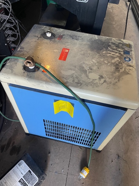

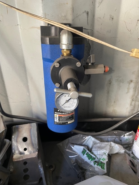

I currently have the air dryer and filter bypassed to see if that harbor freight dryer and filter was impeding flow. In fact everything has been taken apart, but I will include pictures of the components that I had working together, the pictured merlin air filter was taken out of the loop a while back to avoid the smaller air fittings.
Also the shop has been run hard lately, but that’s a good thing. It would be nice if there was enough room to push a broom in there. Please, if you have filters and regulators you prefer, let me know. The dryer does not seem to be the culprit as nothing change when I removed if from the loop.

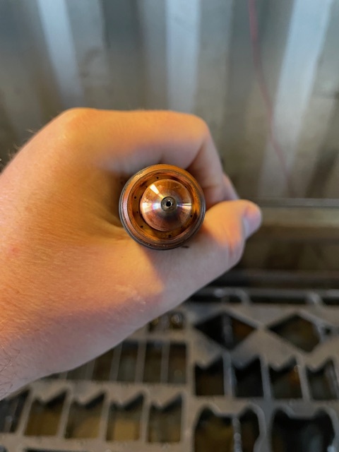

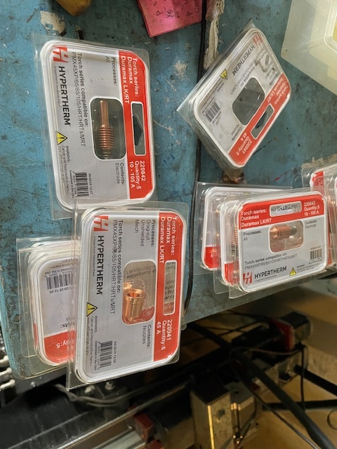

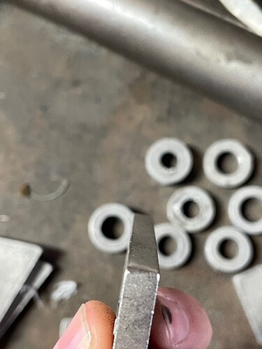

Hypertherm electrode

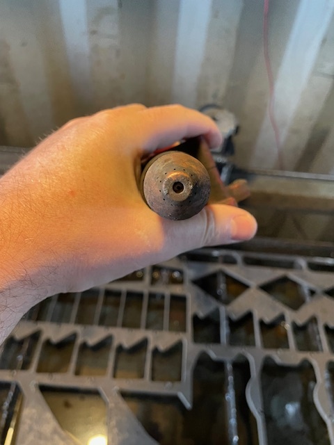

Hypertherm 45 amp nozzle

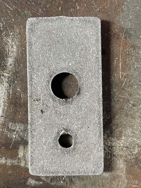

Example of the slag I get built up on the shield when metal blow back. I pause the program, clean and repeat when it’s acting up.

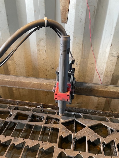

Magnetic torch holder leveled out with table and you can see the ground wire (red wire in the background) from table to shop ground.

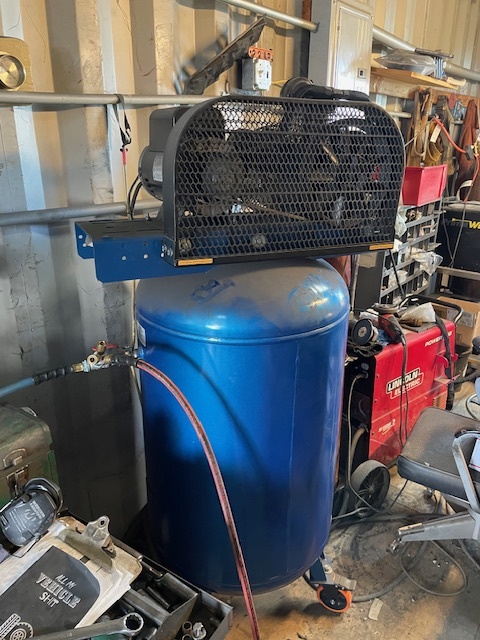

80 gallon Puma air compressor 140psi of on @ 120psi. 1/2” output to on/off valve. Has a auto tank drain that opens every time the compressor kicks on installed on the bottom of tank.

Harbor freight air cooler/dryer. 1/2” in and out. I use soapy water to look for leaks on all fittings and inspect for debree when installing

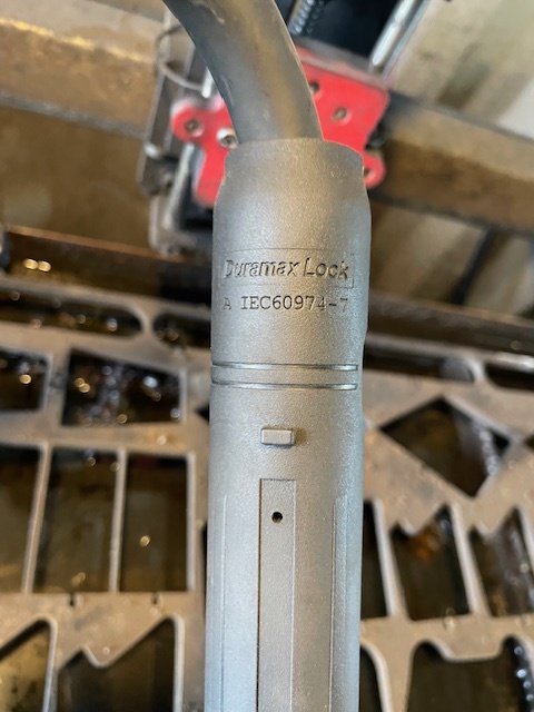

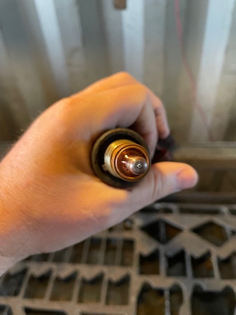

Duramax machine torch adapted to Everlast
1/2” regulator and little supplied hose out to back of plasma cutter

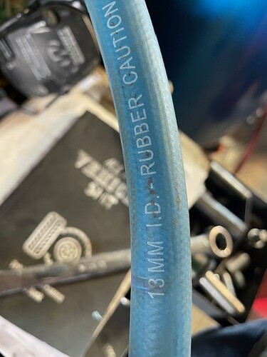

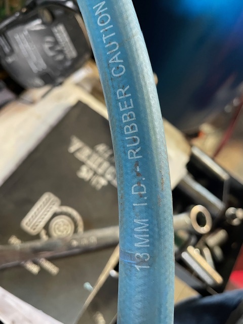

Blue bird 13mm ID hose in, I believe 10’ from tank to regulator
The Everlast 102i with broken front handle…

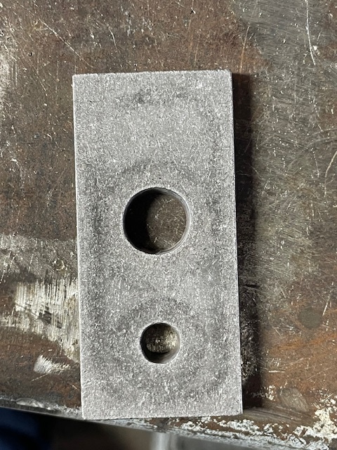

1/4” mild steelCut edge after being tumbled
Consumables I’m using
Air filter I currently have bypassed
more cut quality pics

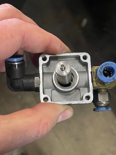

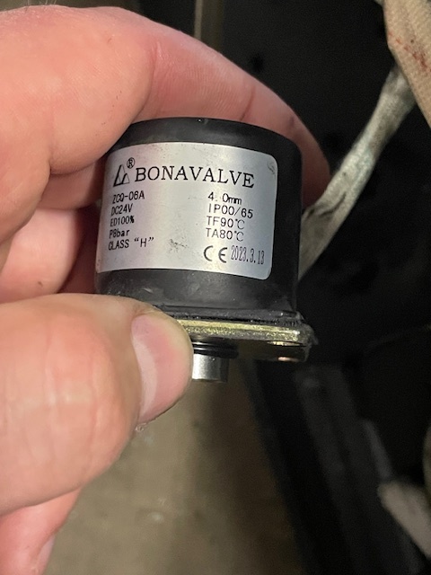

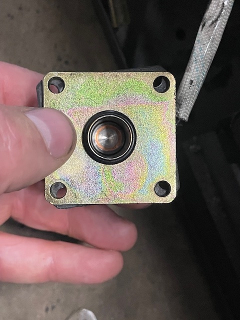

Lucky me, turns out it was nap time (granny visiting) so I went out and pulled apart the solenoid. I don’t see a screen. I took some pictures. Would you guys recommend blowing off the inside of the machine with pressurized air while the case is off?

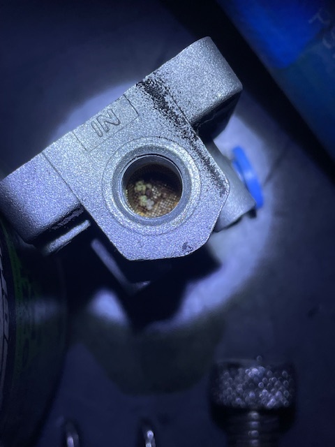

Take out the inlet fitting. The screen is in that port.

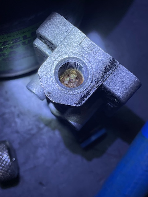

Thanks Bigdaddy2166 and everyone else! I just used a 5/8 wrench to unscrew the air inlet side of the solenoid and low and behold I found this! I have not identified the substance or cleared the screen yet, but it is partially blocked. Pretty tough to hold the flashlight and take a pic at the same time…
Bammmmm! That’s your issue.
Man I sure hope so! I definitely think that’s it too. I’ll clear it out and and put it back together on Monday. It’s been such a great tool even with this problem I’ve managed to make it work. I honestly couldn’t believe how well it worked when I figured out how to fool the air system and run more pressure. Really excited for Monday. Nap time is over so it’s time to exercise and feed the family.

Any recommendations for a good air filter I could run with 1/2” in and out? I saw someone talk about a motorguard or something of that nature?
I see you have a chiller so a good dessicant filter and a motorguard will be a trick setup.
Also what looks to be 3/8 copper line feeding this setup is to small in my opinion. That compressor may need a adapter to jump up to 1/2.
