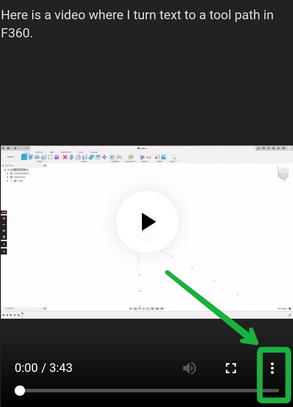

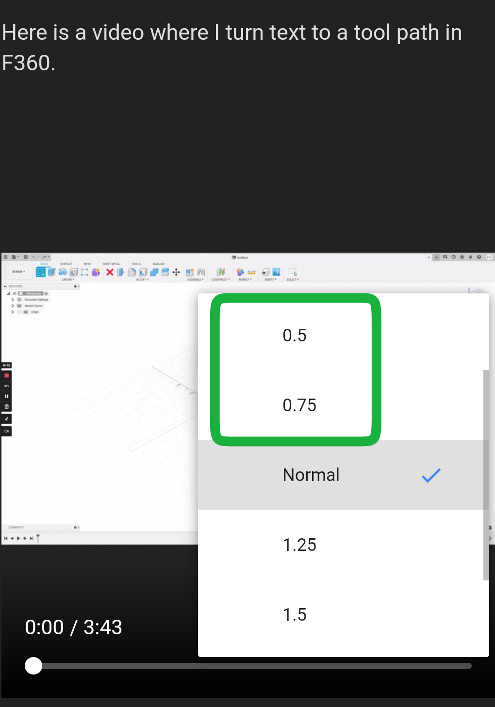

Is it going too fast?
Here’s how to slow it down

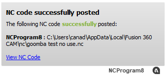

Now I get through post process, I click post and I am not able to save it to my computer, am I missing a step?

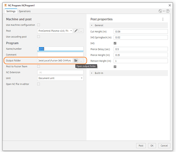

When you hit post it will save to the output folder
mine is here . the circled part is a different name for you.
when you post this message pops up briefly in the corner.
This is your “Save” folder

Or in fusion 360 you could choose a different output folder.

Under the Post heading, the field is blank. I don’t see any option for Firecontrol (as shown). How is this done?
In listed options, I see nothing for Langmuir or FireControl.
you have to use Fusion360 or Sheetcam with the post processor for Firecontrol in order to do anything…
I’m not a Fusion user, but I’ll try to help. You have to click on the file folder next to the post field. Then select “local” and find the folder where you downloaded the Firecontrol v1.6 post processor from the Langmuir downloads page. Perhaps @TinWhisperer could be of more help with the exact process.
You’ll have to go to the langmuir homepage and download the post processor for fire control 1.6
