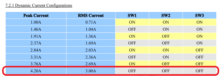

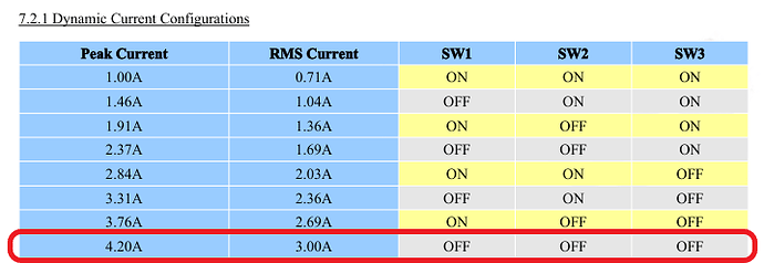

I have trouble following those charts:

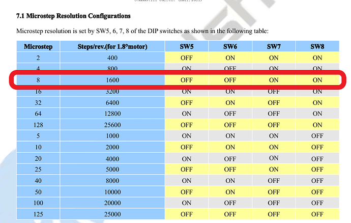

On one of the manuals for the TB6600, it seems to indicate that if the only DIP switch that is “ON” (Switch 2) would indicate:
So to mimic this on the DM542 I would turn on switch 7 and 8 to get the correct steps?:
And then these switches (1, 2, 3) would all be off?:

As you have found the switch encoding is different, so, yes, use new switch settings to get the same value (8 microsteps), 3.76A peak (SW1 ON)
Finally, the motor winding assignments MIGHT be different, I don’t recall, but easy enough to change. My recommendation, if you’re not sure, loosen the couplers before you turn on the motors to verify correct operation (prevents jamming of Y axis).
