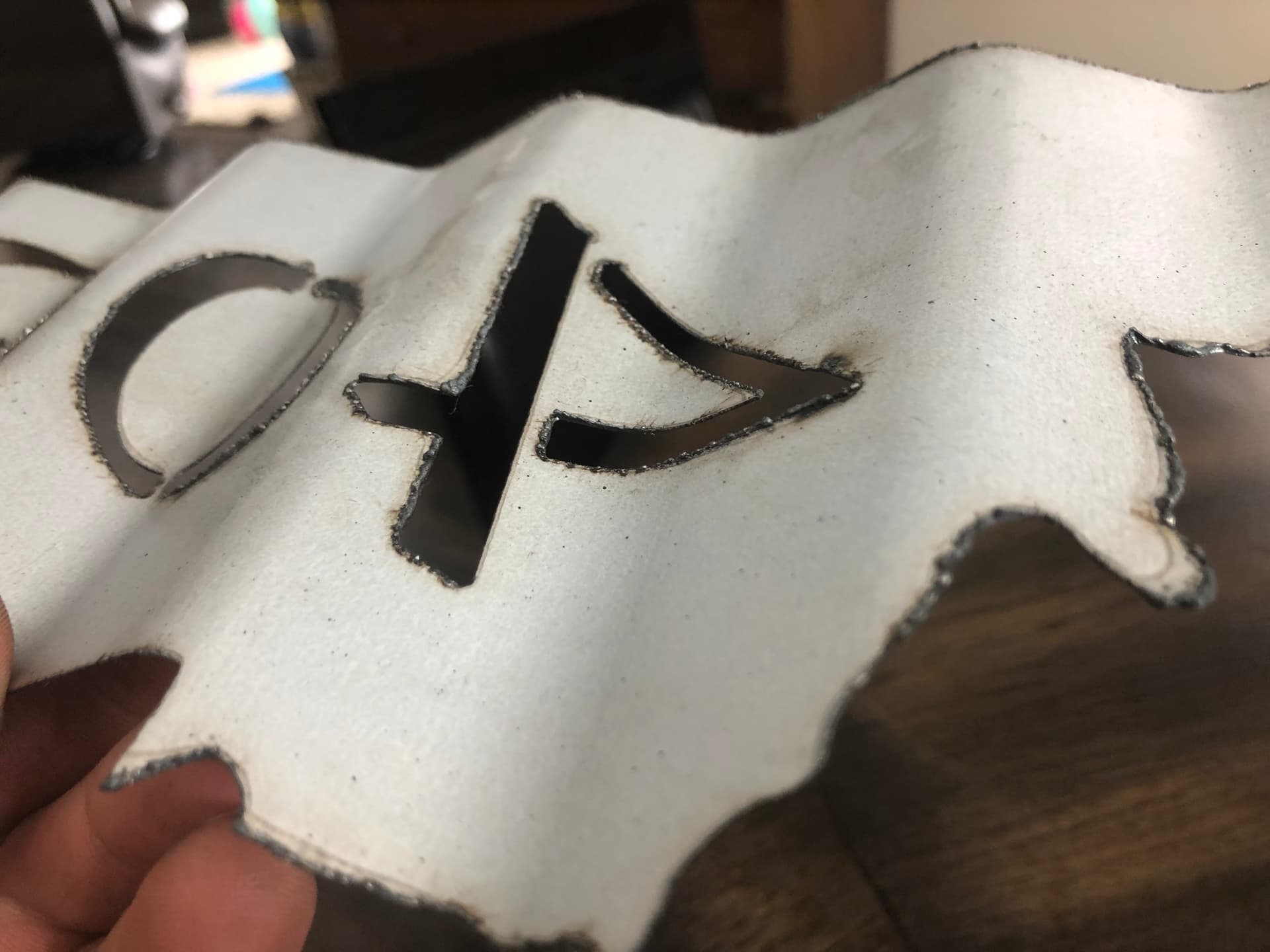

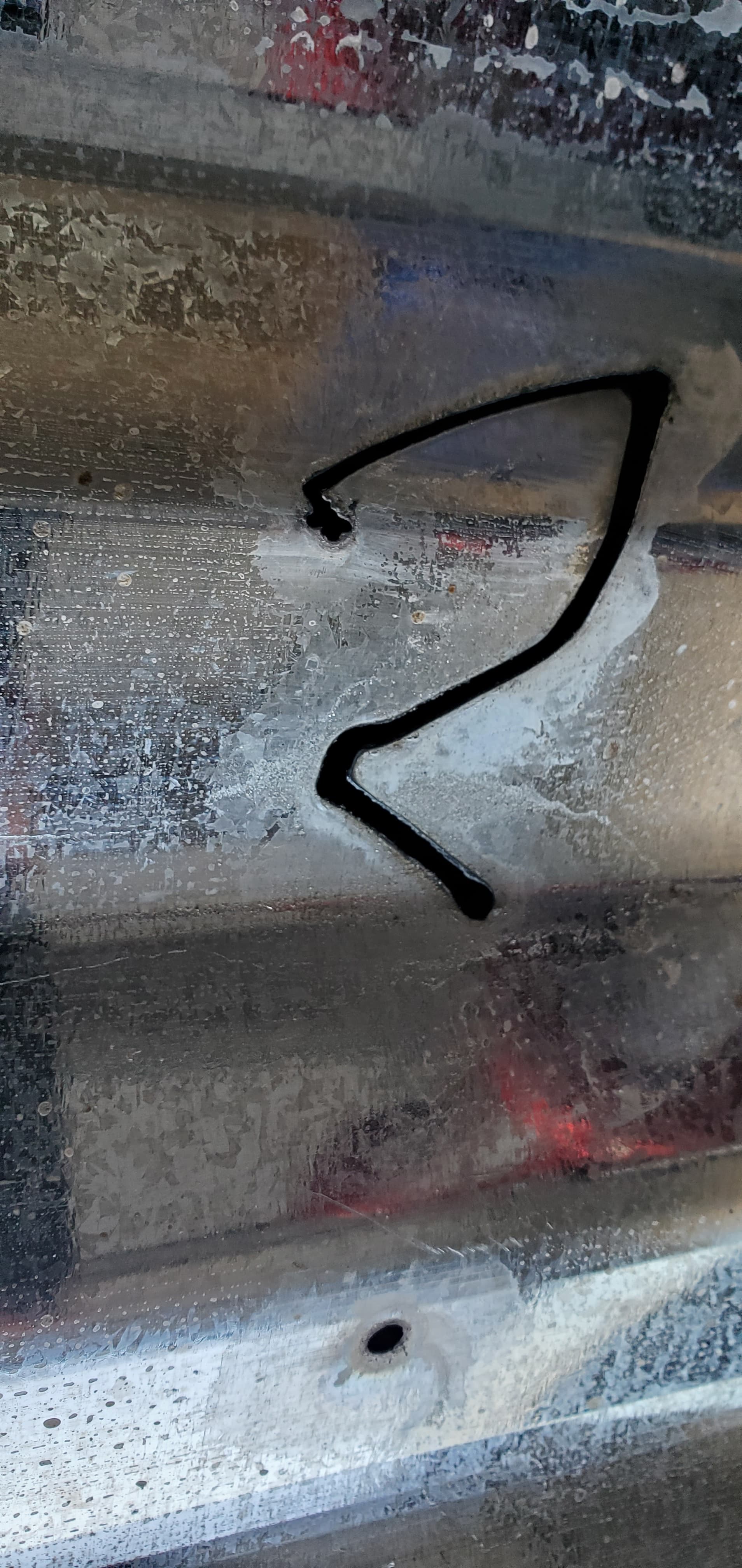

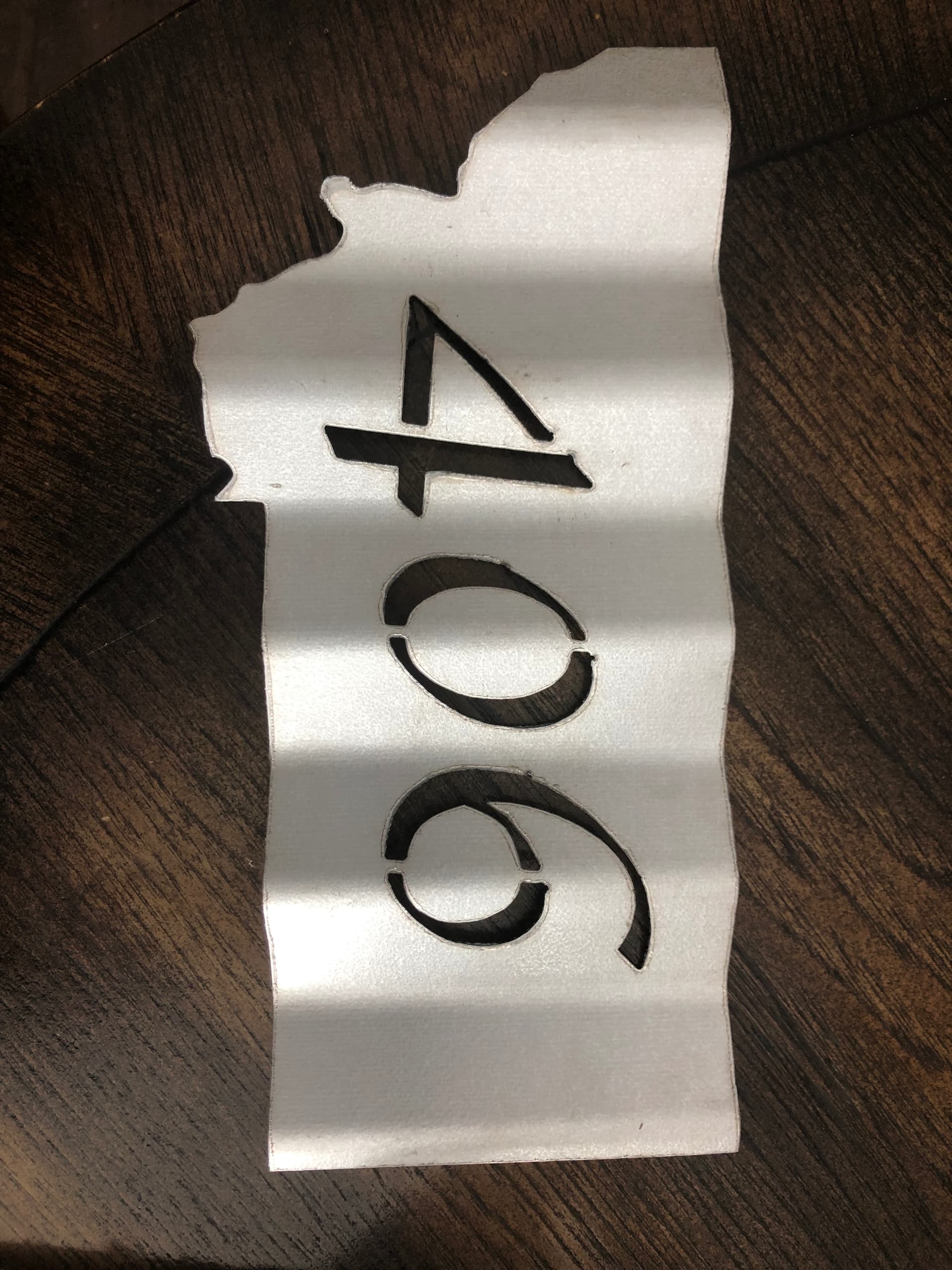

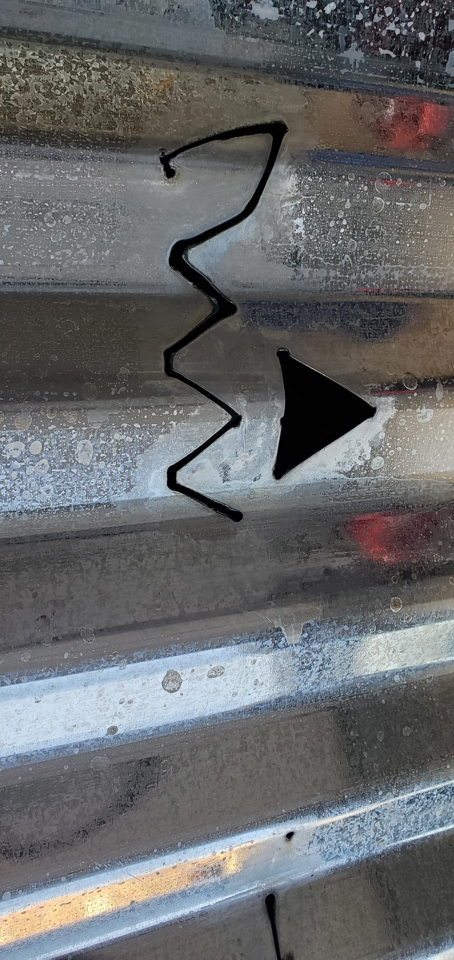

Has anyone had any luck cutting corrugated steel cant seem to get it to finish a cut keeping losing the torch fire

Corrugated Galvanized Steel 31-Gauge i will have to look at my settings when i get home seems like it trys then other times it seems to burn threw to quick and loses the arc
Fire control has a long first pierce delay. I always get a error on first pierce.
I cut the hearts at 20 amps best I remember and not too fast I will have to look at the speed for that tool.
You do need to go into the THC settings and change the z axis speed.
If you are cutting and losing arc definitely override you speed and try a faster cut as well as turn down your amps some.
To cut the corrugated I turned down to 20 amps, 40ipm, and had best results with THC settings 110v nominal, 45% x travel.
