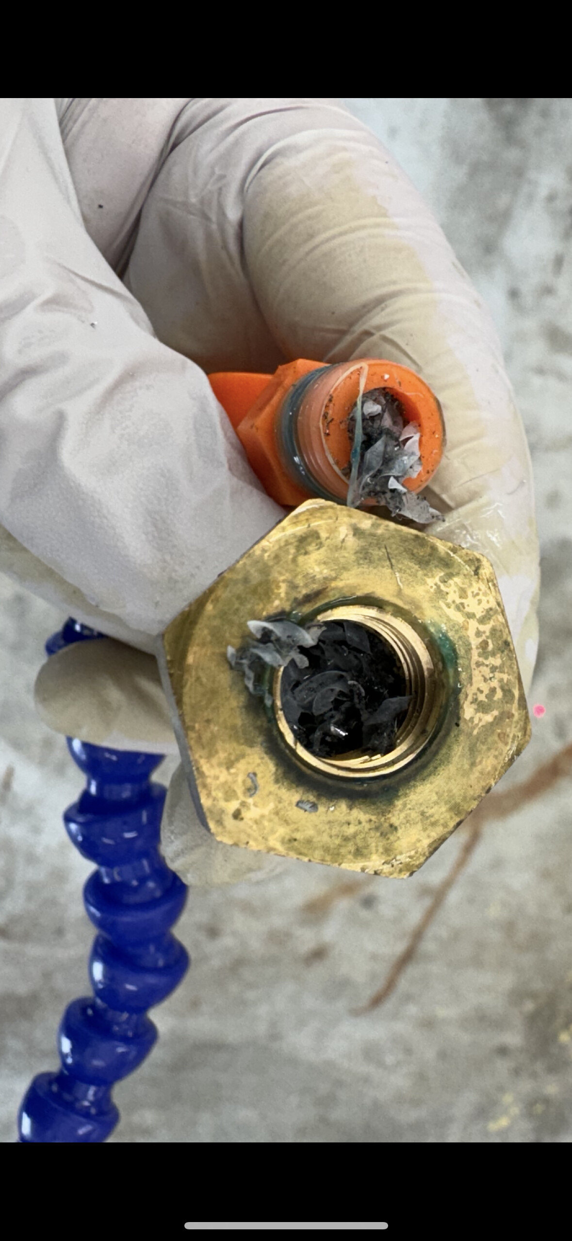

I’m running into an issue with my coolant flow dwindling and eventually coming almost to a stop. I’ve been running the machine off and on today for about a total of 1 hour run time. It’s gotten worse as I run operations, shorter and shorted times of proper flow.
-I’ve got plenty of coolant.
-The pump IS running.
-Turning it OFF and then On will give it a boost for a short time.
-The pump isn’t clogged as far as I can tell. “Maybe further up the line?”
Thanks!

Here’s what the exact cause of my clog was.
For further information, I was using a forum user’s suggested method of chip collection. Instead of having mesh grates on the drain (as provided in the stock coolant kit) the grates were removed and everything (chips + coolant) would drain into an additional basin that had a hole cut out in it. Once the coolant would reach the hole, it would drain out of the basin and into the normal coolant tub. I had failed to add a mesh screen to the additional basin and when cutting HDPE/delrin, those chips would float to the top and out of the basin. The pump had no issue getting these larger HDPE chips pumped into the coolant system and eventually built up at the flexible nozzle.
Additionally, I had added a wash down hose with a T fitting. At the junction between the T and the wash down hose, the wash down hose split from what I presume to be the extra pressure resulting from the coolant clog.

I did take the pump out because a clog was my first concern “or a failing pump”, didn’t find much evidence of bacteria, just a very light film on one spot. I was looking for chips clogging it also, but didn’t see much there either.
I ended up back blasting the entire system with air where the black hose connects to the brass fitting on the spindle housing. Took a few go’s, but it appears to have done the trick.
