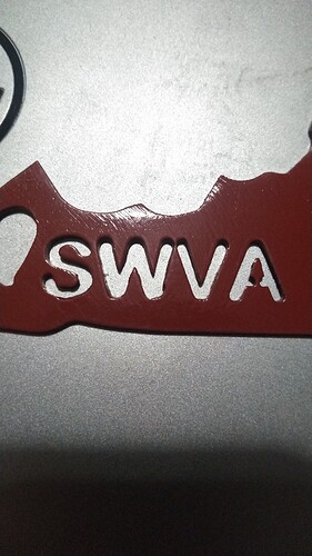

That circle you cut out too would have been the off cut.lead ins suggest that it would have been cutting the wrong direction. so what does the metal look like you cut the circle out of? That would be truly the finished edge.
Have you inspected or replaced your swirl ring. It feels like the chatters may be coming from the airstream somehow?
maybe i should switch the direction of the cut for the small letters? how would i get overlapping lines? i want to prevent this problem in the future. tomorrow i am going to do test cuts on several fonts using fusion 360. Is sheetcam more friendly on the letters? never used it before. I can navigate my way through fusion very well. I will recut the dxf file that you cleaned up and see if that helped. I find myself selling more product these days with personalization so i need to get this letter cutting issue resolved.
Swirl ring is clean, i can see through each hole and i have it in the right direction . circle cut looks very clean on the other end.

I imported your original file into Sheetcam and the only design issue I see is a very short open line near the bottom of the “D”. The letters are quite small and Sheetcam had some difficulty fitting my .2" lead in on them. It fit, but the pierce hole would definitely show on the opposite side of the letter.
May not be a air issue at all. Have you tried a different font? I have a idea how tall are your letters? It will be tonight or maybe someone else can now. We could do a small project with a few letter cam it out in sheetcam and in fusion then you can try to cut it as well.
I absolutely agree. Air setup is good. Enough on the air lol. I did notice that small line which did not get cut out. But I rarely use a lead in that long. I’ve had decent results with lead ins as low as .07 for the small stuff, but then again here i am with problems cutting out small letters. I have not seen anyone in this forum yet cut out smaller letters with RW45. Maybe I just haven’t come across them. I ordered the powermax 45xp and the fine cut consumables. Really curious on the difference that will make.

Huge improvement here with absolutely no change to settings. That would make this machine bipolar. I chose the 5 most used fonts I use. I noticed on the smaller letters they are not as smooth This setup makes cleaner cuts on letters over 1”. All 5 fonts have the same results. This was at .07 lead in btw
Looks clean. I might try to cut that earlier font on my machine this weekend see if it has any chatter effect.
Looks like you have bearings out of adjustment to tight /lose will cause chatter binding? Air will cause jagged cuts as well if air flow out of torch is disrupted by blockage from debris or damaged consumables as well.

Well I definitely keep having the THC problem again. It never wants to keep a correct cutting height no matter what. I’ve turned smart voltage off and entered several different nominal setting. I set the post process to have a variety of different heights in order to get the correct height. I just put a brand new 30amp nozzle and new electrode on and this is what I got after cutting 3 little letters
