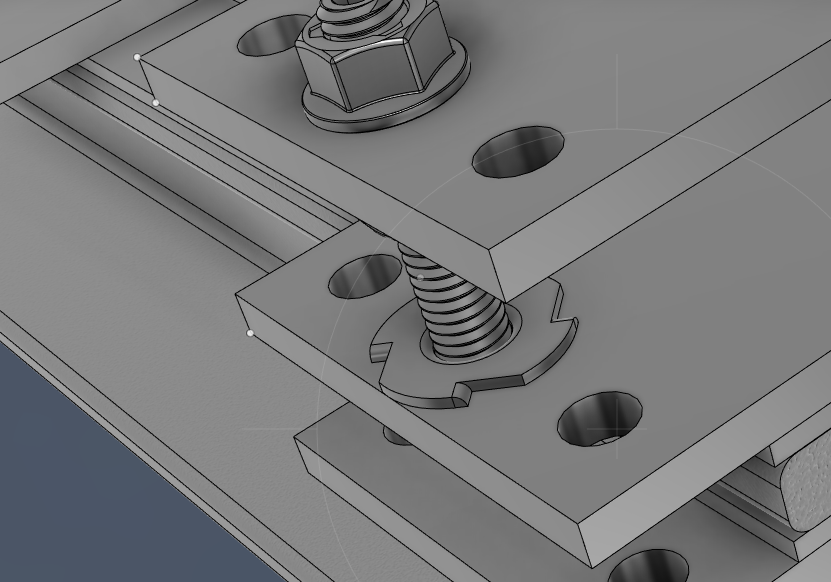

I’m working on threaded insert options, so no tapping. This is a screw mount nut, 1/4 -20.
Another options for T nut. 3/8 - 16.

Never seen a T-nut for steel, is it a press fit?
That one is called a t nut for wood, as it has prongs. Just put the slots for the prongs. Water jet has no problem making the prong holes. plasma is TBD. I wouldn’t try to do press fit due to variance in holes even with Waterjet( waterjet holes can be tight one side, loose the other on press fit parts). I would only use weld nuts or t nuts with prongs to catch and not spin
This seems like a backwards method if you ask me. Did you know the prongs are made on a taper?
Are you going to cut a tapered hole for them to fit in?
How will you keep them from falling out?
I have used 10,000+ t nuts, very familiar. They are a placeholder till I know what I want to use but they can be held captive from the top with a plate that sits over the the flange, held down with a bolt although the weight is holding everything down. I am looking at various off the shelf methods for threaded inserts. You can’t cut a tapered hole on water or plasma, just cut the hold the size of the widest part of the prong, quite simple for water or laser, not sure on plasma.
Actually a plasm and water jet both cut tapered holes.
Ok, but it is not important to taper a prong hole. This part is from a CNC’d part with recessed flange, but principal is the same. Just drop in the tnut, hold captive on one or the other side if needed. Not applicable to all cases. But this is a bit digressed :slight_smile:

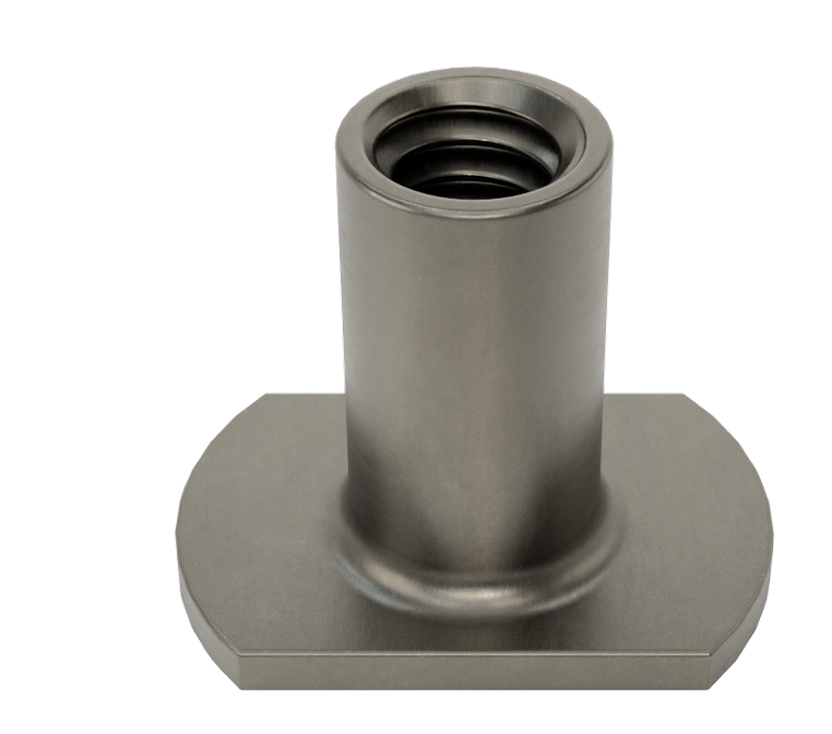

Here is a t nut with prongs in CNC’d delrin, works the same on CNC’d alum etc. Just push it in.
___ tnut in delrin

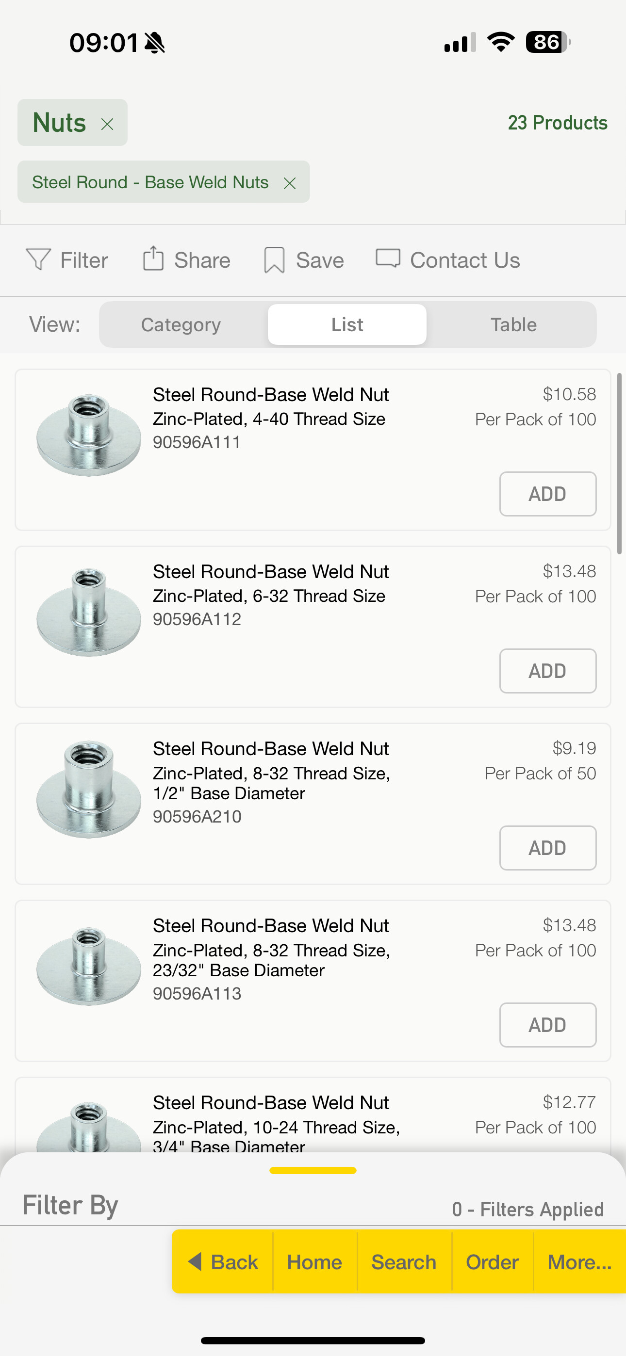

Yes I’ve used those versions as well but you have to either weld them, or hold them by some method to tighten a bolt. This is a similar weld nut I have used with flat sides, so its easier to hold this one captive with a screw head near it, or metal plate near it to make it not spin. Unless you are into welding these things.
Yeah that was for @Knick
Well that does seem like the way to use them, lets compare. Hold them from turning with a screw or flat plate. Mark where hole will be required, drill hole, tap hole, insert screw, done. = 10-12 mins unless you break a tap :rofl:
Or you weld them. Drop in hole tack as needed = 1 minute
