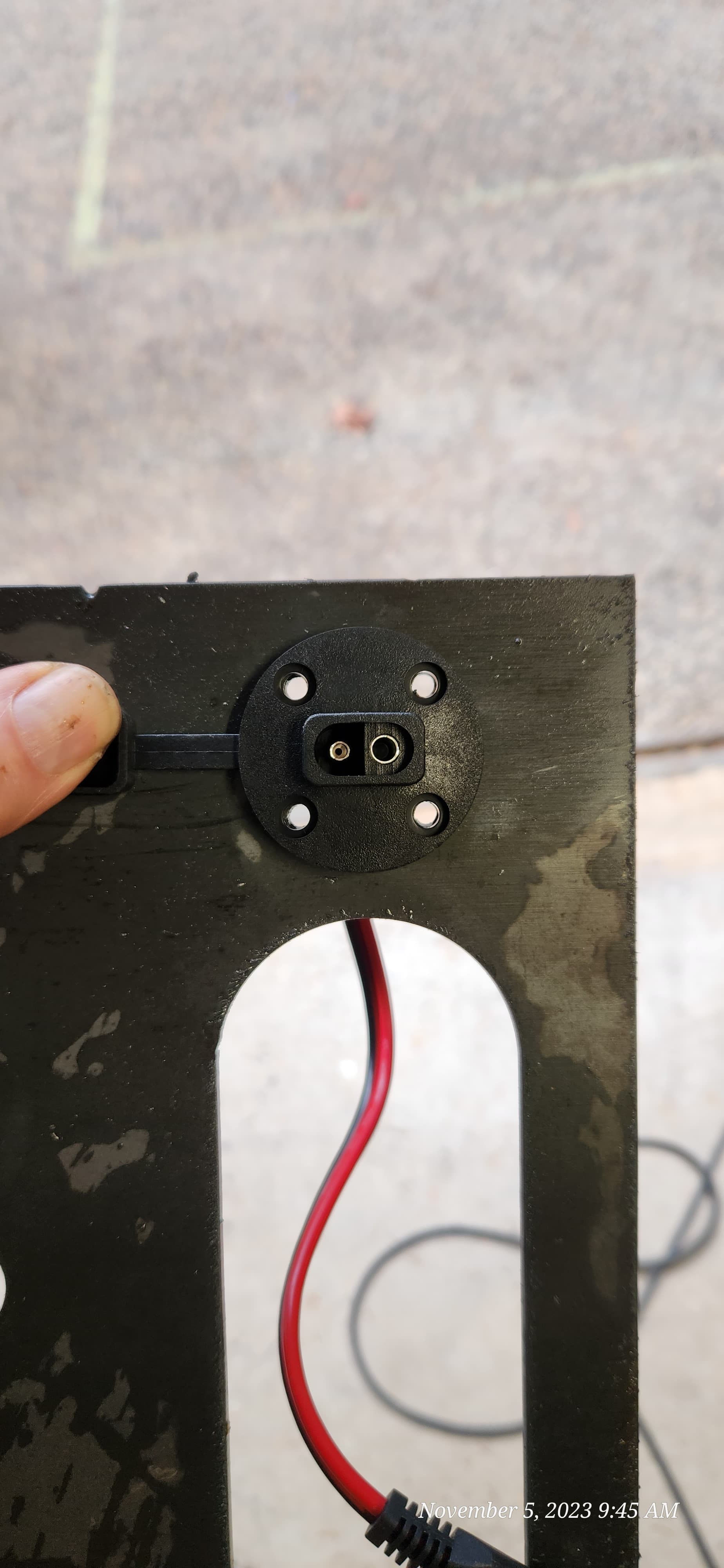

Still, it works for everything I need and my crappy PC handles sheet steel very nicely. However, as others have mentioned, a Plasma cut hardens steel and secondary cuts are not practical. I highly recommend the center punch method for marking holes less than 1/4". In the photo above, the slot is for an M5 bolt used to tension adjust a pulley. It works fine for that, but holes are sloppy.

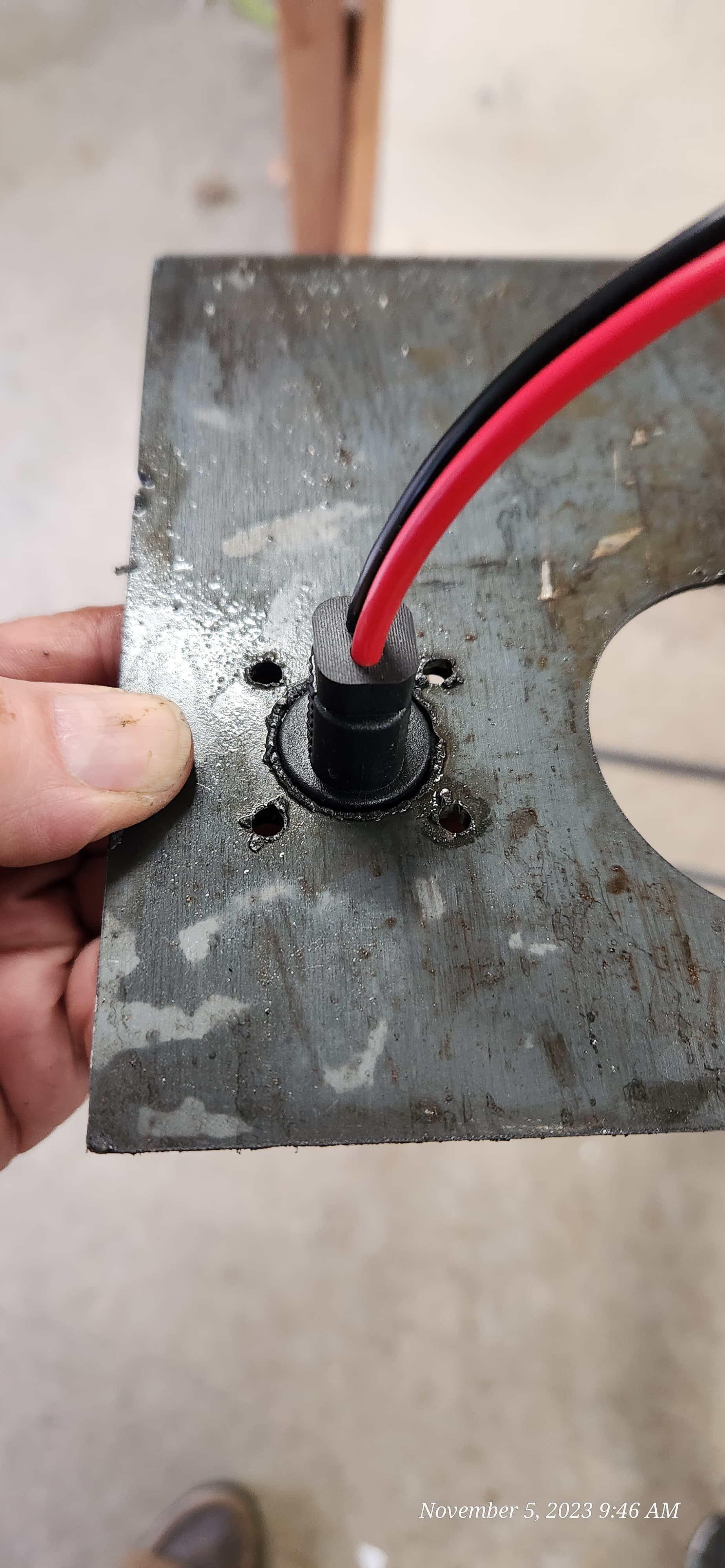

This is 12 gauge mild steel right off the table. I obviously did not clean it up for the photo because I wanted to show how cylindrical the holes are when slowing down the cut for better holes. This will result in more dross but it removes easily if your other settings are on target. The large hole has a diameter of 0.908 inches and the small holes are 0.188 inches (or at least that was the designed dimension).
One hit with the fireball tool and this dross was gone. No grinding necessary.
You can see there is minimal to no dross on the other cuts because the torch was moving at the optimal speed for the amperage and thickness of metal.

Actually the pictures I shared was the very last of a 500 part run. There’s was around 3 plus hours of actual cutting before that part was cut. I do believe it is possible to get consistent cuts over many parts. You cut much thicker steel so yes cut quality goes away faster.
Yes you are very right you can’t expect gold every cut that is also why I said people only share pictures of the best of the best
My reference was to not expect those results right out of the gate. After time and experience, then yes, that quality can be expected.
