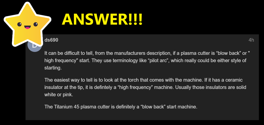

It can be difficult to tell, from the manufacturers description, if a plasma cutter is “blow back” or " high frequency" start. They use terminology like “pilot arc”, which really could be either style of starting.
The easiest way to tell is to look at the torch that comes with the machine. If it has a ceramic insulator at the tip, it is defintely a “high frequency” machine. Usually those insulators are solid white or pink.
The Titanium 45 plasma cutter is definitely a “blow back” start machine.
If there was only a way to remove all the garbage from these posts after they get derailed and lock them with the real helpful info like you provide would improve the search function 1000%.
Good job for Jimmy! :rofl:
Not bad but you would need to delete all the messages like this one that add no value
It must be since it’s redundantly consistent with the previous posts that had already answered the question. Well, the bit about ceramic tip is new, but I’m not sure that is EXCLUSIVE to high frequency machines. It could also apply to contact type start plasma cutters…
