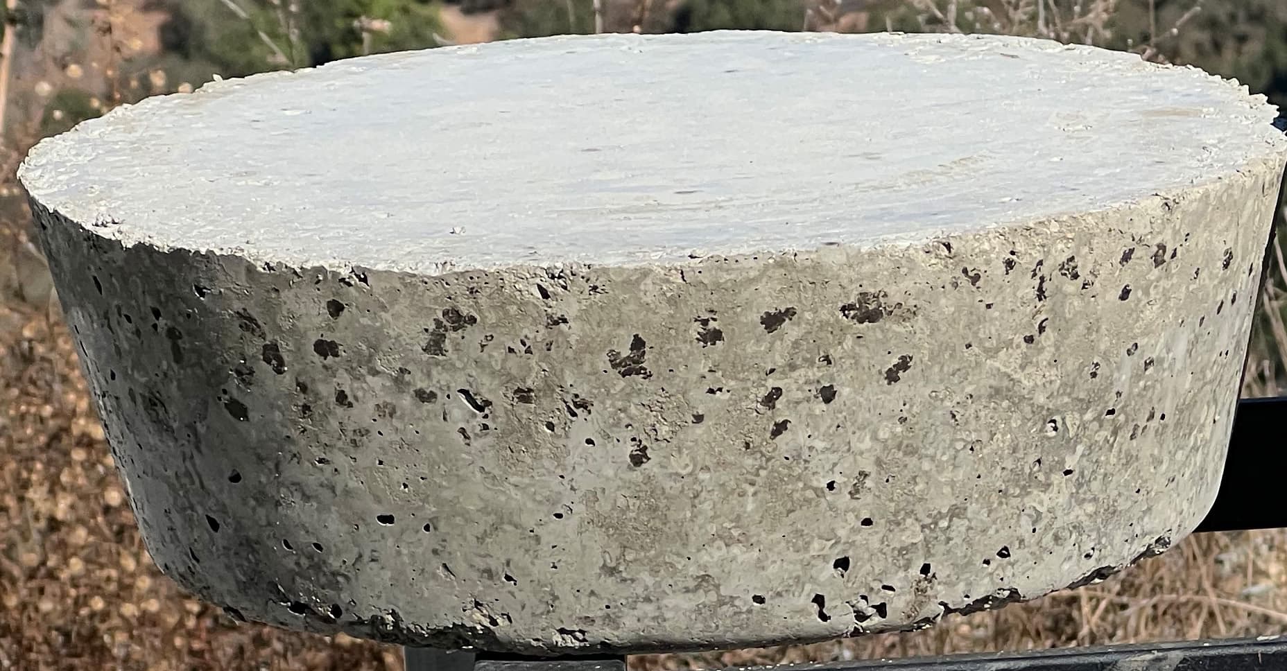

I know that there have been a few discussions about concrete, but I did a test pour and wanted to share my findings.
Bottom line is that using minimal water makes an extremely stiff mix which makes it almost unmanageable.
On this pour I used the max amount of recommended water, 5 pints. I used a concrete vibrator and mallet on the sides of a small plastic mold. Flowability of the material was virtually nonexistent. The results were less than satisfactory with voids still present and a lack of workable cream on the surface and sides of the form. Gravel still in contact with the sides of the mold in spite of malleting.

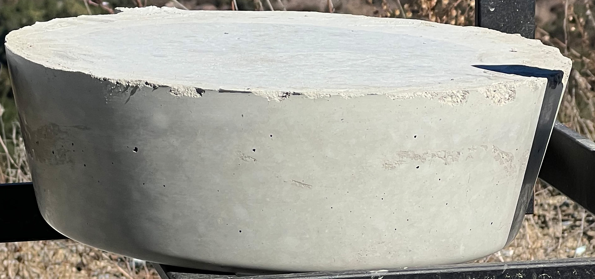

On the second pour I added a ½ table spoon of sugar to the water. This extends the set time of the concrete and greatly increases the flowability of the mix. Same mix, same 5 pints of water, same process:
Sugar acts as a retarding agent against the chemical reaction between the water and cement in the mix. One of the side effects is increased slump or viscosity/flowability. Sugar has no deleterious effects on the curing properties of the concrete according to my research and my test seems to bear that out.
Materials Used:
Concrete Mix: Quikrete Q-Max 50#
Sugar: .25 Ounces / ½ tbsp - ā‰ˆ 0.1% by weight of cement content in mix
Mold: Plastic Oil Drain Pan
Tools: Cement Mixer / ¾ HP Concrete Vibrator / Rubber Mallet / Wood Hand Float / Small Steel Hand Trowel

I didn’t use a slump cone, but I do know the difference between having to scoop and pack the mix into the form verses pouring, which was the difference between the 2. I didn’t need an accurate slump reading to observe the differences. The workability between the 2 was night and day.
And you’re right, a pressure test would be the only way to confirm the PSI. I do not have a Schmidt Hammer handy.

I have to say the teaspoon of sugar is a great idea. Will definitely add it to my mix. I would not have believed it, till I saw the photos that JDE put up.

it will allow the concrete to have smooth sides…like the picture above…
