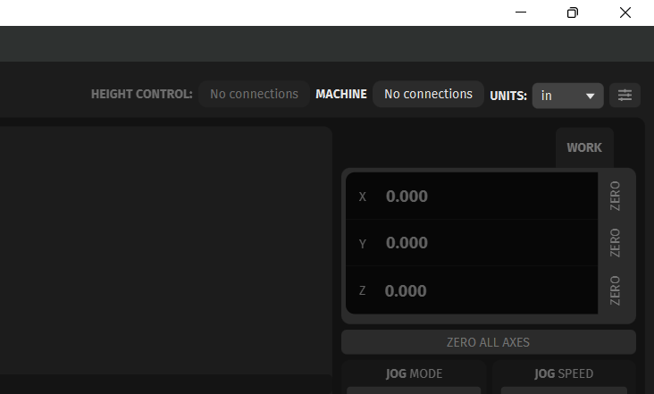

ok i downloaded compatibilty and when i pull up crossfireit still says there are no connections
Now we are getting somewhere. Do you have the USB cable connected from the computer to the table?

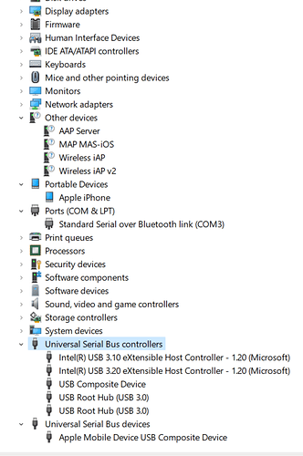

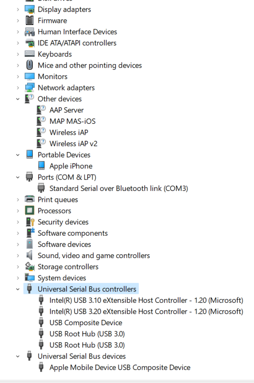

usb is connected to the laptop, its like there is no signal/communication coming from the panel to the laptop. laptop device manager shows no signs of change when plugging in.
attached is a grab of the device manager with panel plugged in
attached scfreen grab of firecontrol showing no connection
Does the USB port on the machine light up green when you plug in the cable? If not, try another USB port or USB cable.
Scroll down to the Connection Troubleshooting section on this guide. CUT with FireControl | Langmuir Systems
I have tested all ports with 2 cables, and plugged in my phone to each to make sure the USB port is functioning, and all are.
OK. Does the USB port on the table light up green when you plug in the cable. This indicates that the USB is connected and receiving power from the computer.
Very similar to this USB problem.
Power transfer but no data transfer.
