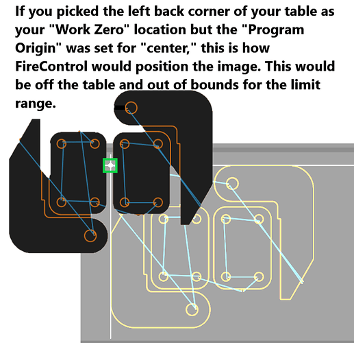

Edit: I think what you’re referring to is the corner where the program starts on your design. That is the origin point that is set in your CAM program. You can also change that in Firecontrol by clicking on the “set program origin” button. That will bring up 5 green squares on your drawing. One at each corner and one in the center. Click on the one where you want the origin to be.

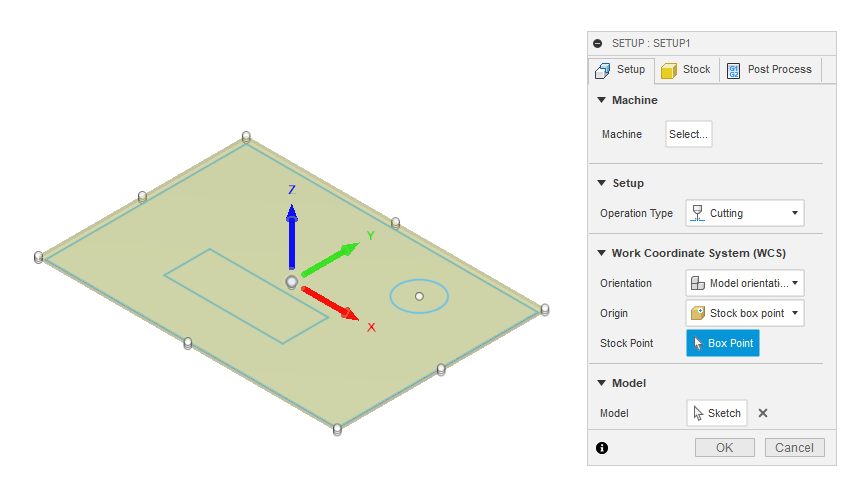

So when setting up in Fusion instead of using center start with upper left on initial layout correct.
Wherever you set that origin(I think it’s called something else in Fusion) is where your torch will be when you zero it in Firecontrol.

It is called “Stock Box Point” and by default, it sets up in the center. (Most people move it to the bottom left corner.)
If you wanted to plan to set it to the back left, you would do this:
But I agree with David. Don’t get hung up on that. Pay attention to FireControl and the table. If you always start your design by picking the “program origin”, it won’t matter what Fusion set for the “Stock Box Point.” By setting the ‘program origin’ after loading the gcode file, you will be over-riding Fusion’s Stock Box Point.
What David and I are trying to say is that you need to pick spot on the metal where you want your design cut out. Position the torch at an estimation of a corner or middle of the design and “zero all axes” (which sets “Work Zero”) with the torch in the location. Then confirm by pressing ‘program origin’ that the chosen green box represents that same relative position of your design.

Edit: For clarity sake, Fusion is still calling it the “Origin” but you can specify the origin by a number of ways. “Stock Box Point” is set as the default “origin” and that can be changed to a number of different options/pointers:
