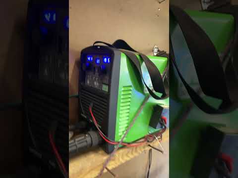

Everlast wanted me to jump in 1 and 2 on the back of the machine but I don’t see that. I switched back to the hand torch and unplugged the CNC controller on the back, unplugged from the vim box, switched the plasma cutter to unlock or not CNC, pulled the trigger and nothing. When I let go of the trigger the post air starts.
Looking at the machine it’s set at 42amp, when I pull the trigger it drops to 23amps but nothing happens, no air nothing. Then letting go of the trigger the post air starts
Video
One and two are the top two. All Everlast Pierce starts at 23 amps. This is regardless of the setting.
Pin one and pin two are just a switch. When they are connected, the torch fires. No polarity.
Have confirmed that the CNC torch is not defective? I don’t see your work clamp in the video. Please show me a picture of the lights on the front of your machine. The one should be on CNC and the other on auto restart. Work clamp on the metal being cut is mandatory. Plus you are holding it way to far off the metal to initiate and arc. Actually place it on the metal and try.
One more thing you have confirmed that the electrode moves up and down with your finger inside the torch? The video shows the hand torch.
When using the hand torch trigger did you take the machine off CNC mode? The way you are testing the trigger needs to tripped at the CNC port. If the machine light says CNC.

I completely removed the Langmuir hardware (CNC plug and vim box) and operated the plasma cutter as a stand alone machine. It wasn’t on CNC, just a regular hand held plasma cut method and it didn’t fire. The ground was on the work piece as well.
Everything worked fine a month ago, it just sat for a month with no use and now it doesn’t work.
