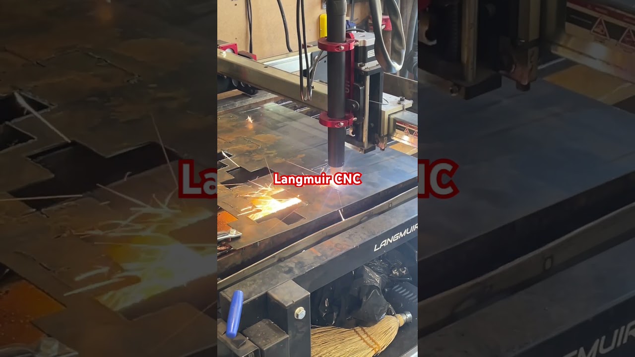

Call Everlast. With that information you definitely had a cutter issue. I was not aware it had been working. Sorry.
No worries. I did email them with the new info. I figure by doing the in jumper that’s by-passing Langmuir. But also disconnecting everything and pulling the hand trigger should also be as good as test. Thanks for all the guidance! I’ll post back
Good luck my friend :+1::crossed_fingers:
If the machine torch was pilot arcing then the hand torch will also. You should have these settings on the plasma cutter. Lock off, Tip saver, post flow 20, 65psi with air flowing from the torch. Also check the fuse.
Like I said, if you want me to walk you through testing it give me a call.
Thank you @mechanic416 !! George was very kind in helping me via over the phone :pray:
Turns out it was a bad electrode. After swapping the torches I was using the same electrode. Even after trying a couple of new electrodes, they were bad as well. So moral of the story, buy good quality consumables :sweat_smile:
