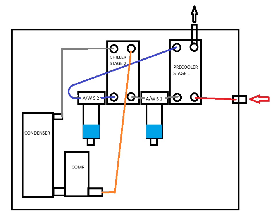

Humor me….
Why couldn’t this be made using these inexpensive Vevor heat exchangers, a raspberry pi with an arduino and cheap front panel display, a few thermocouples, and a thermostat/relay?
And would you run a water line into the exchanger so the heat can be rejected?
Depending on your incoming water temperature it would be a good option to get your air temperature down to 55 f maybe?
From your diagram it looks like you’re going to run a DX system
I was thinking just a typical fan mounted condenser for the refrig system.
Why only 55F? What’s the magic in the harbor freight system that gets it to freezing temp?
DX?
If you were just using groundwater by itself instead of a DX system
Refrigeration
Direct Expansion, got it, yes that’s the intent. There’s no water in the loop, just compressed air and a refrig system. Heat rejected to air. Or am I completely upside down in thinking that these heat exchangers wouldn’t work with refrigerant on one side, compressed air on the other?
Idea is that hot/wet compressed air is precooled, chilled (hopefully to really cold <32F), dropping out all condensate, then using the dry chilled air to precool the incoming instead of wasting the work.
Hopefully not.
You don’t want to get into a situation where you end up causing a frozen plug.
I’m sure it would work. It freeze up monitoring would be a concern
Would be monitoring the outlet of the 2nd stage anyways for fault detection. Would just need to pulse the compressor to keep it above 32F, with some buffer so the condensate doesn’t ice.
Out of curiosity. Do you think at the end of the day this will function better than a readily available refrigerated air dryer?
:man_shrugging:
Just a thought experiment as to what could be put together if a refrigeration system already existed (mini fridge etc), and $100 was spent on some heat exchangers. I’ve crunched no numbers on it, and don’t even know what size refrig would be necessary. I just can’t see why they’re $600 at the base/entry and $X000 for the larger name brand systems. Also I figured using a regen system would help with work loss and efficiency of the system as a whole.
