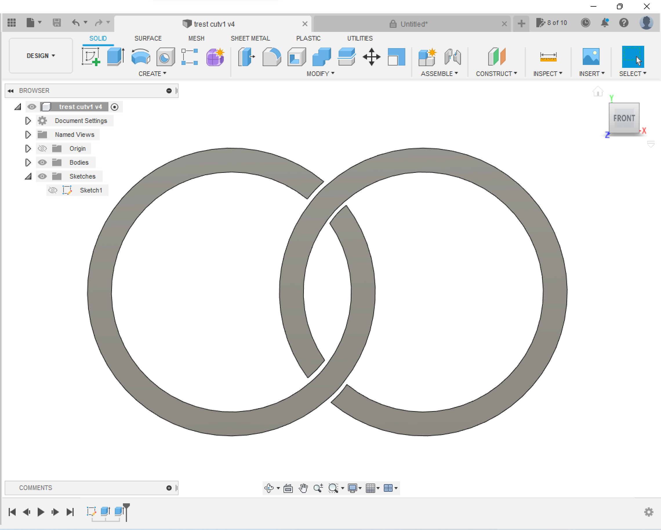

i couldnt get this image where i needed it to go. somedays im great with computers. sometimes nothing works. for some reason it kept inverting the colors and doing weird crap. i recreated the drawing in fusion and im going to go run it. the file is completely smooth it does not have all the segments like the file i originally posted. i think it came out much simpler because no inkscape complications. ill keep you posted. thanks.

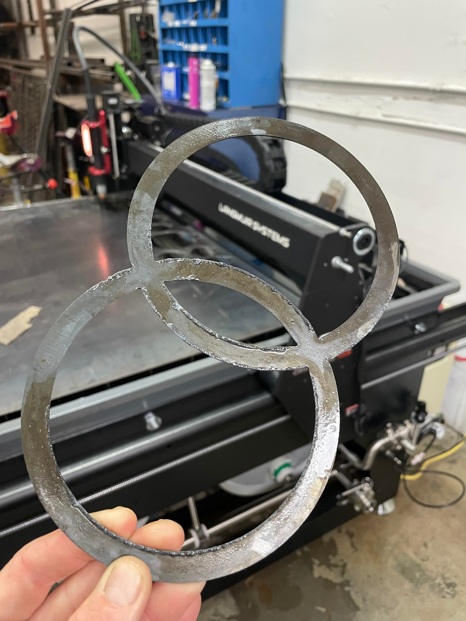

i just cut some rings they ran perfect here is a photo. this was 100% made in fusion360. i then separated the rings to cut two ring segments and it is still slightly pausing on the nodes where i patched the rings apart. i am not certain if this is normal. either way a big improvement. so i was told that i need to clean up my inkscape files manually in fusion before i do my final 2d and post. is this something that yall do? or a better question may be, when making semi complex custom signs or cutouts what is your process? what programs? what are the ways you have had success? i dont want to set myself up for failure by using the wrong programs. thank you so much for the help.
trest cutv1 v4.f3d (133.4 KB)

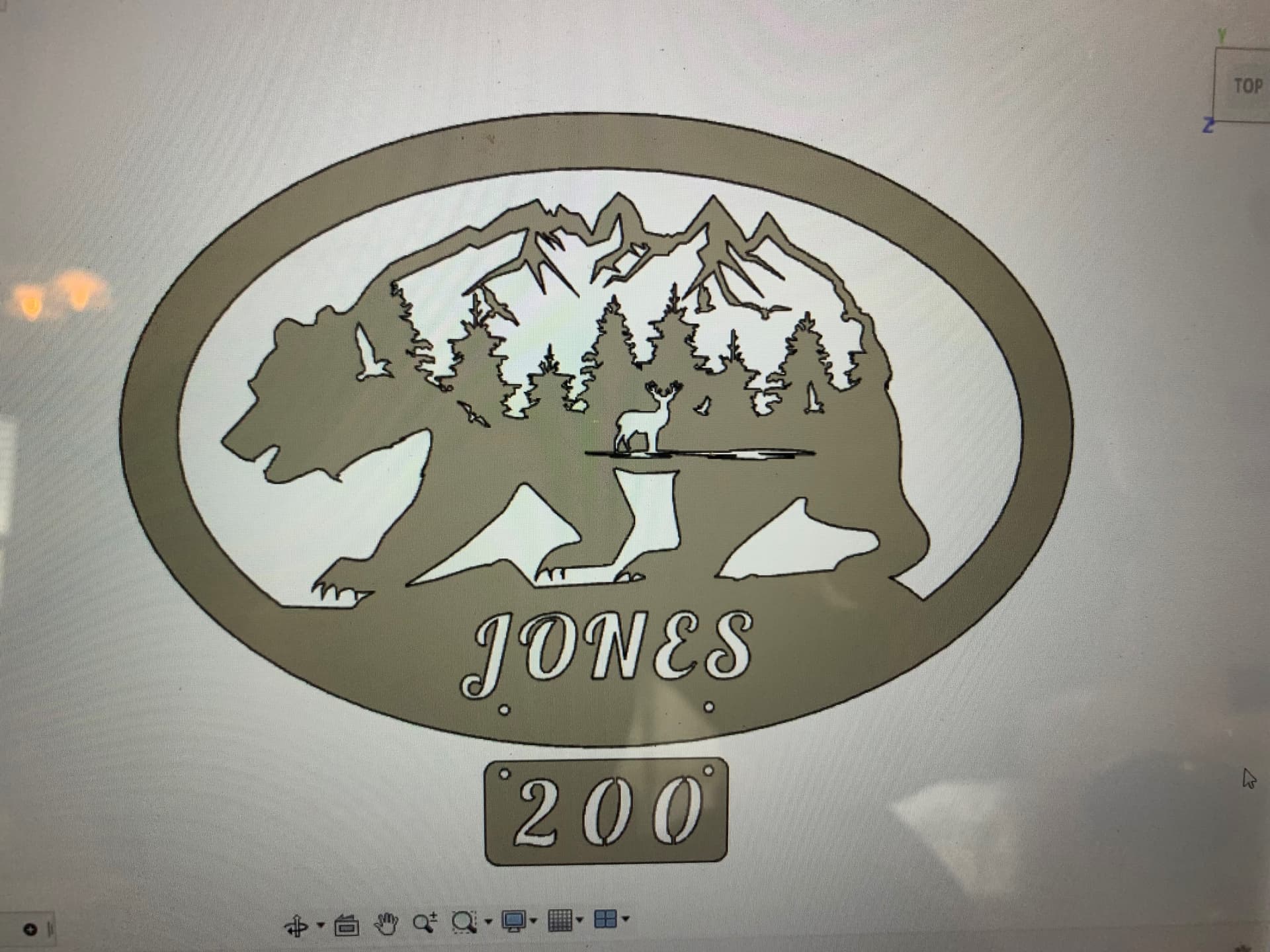

I made this as a housewarming present for my BIL.
I used Inkscape to simplify to remove nodes globally, then manually went through and removed more nodes that I could see were unnecessary.
I used Inkscape to create the “frame” and add text. I think it would be just as easy to do that in Fusion and maybe one day I will get to where I do it all in fusion, but I am not there yet.
I also had to modify and move some of the birds and connected them to the mountains and/or trees so they wouldn’t fall out. I added some girth to the mountains and modified trees and the deer and I did all that using Inkscape.
I considered adding a sun to the top of one of the mountains to connect it to the frame at the top. I was planning to mount this to a wood backing so I figured it would be okay without it. If I were to do it again, I think I would add the sun.
Finally, I used fusion to find the open paths, extruded it and ran it through the manufacture process in fusion to do the CAM

Here is a snip of the dxf as downloaded from Fireshare
