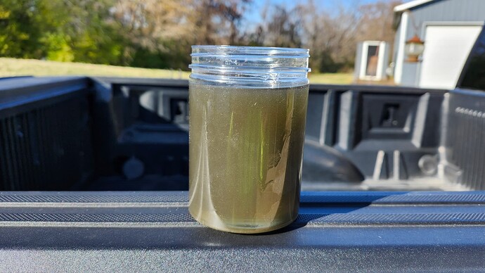

I’m absolutely convinced the pump is a refurbished unit, and badly refurbished at that. I’m generally really easily satisfied with things and will let a LOT of things go so long as ultimately the item does what it’s supposed to. When we installed the “new” pump it was pegged out on oil pressure again. The tech called Eaton who manufactures the pump and they said “run it for a half hour or so and see if the pressure comes down” which after about 10 minutes it did. Eventually it down to about 55 PSI which is within spec. Wasn’t super happy to see it doing the same thing but it did come down to a place where I wasn’t worried about seals and O-rings. However, the paint on this thing is horrible. It’s flaking off all over the place, they oversprayed onto the sight glass which by the way was only finger tight. And the oil, it literally looks like dirty pond water. This pump has presumably never been run before and it looks like the oil was just scooped out of a dirty pond. I’m going to post pictures of all this, maybe I’m just expecting too much but FFS this kind of money I expect a lot. Anyhow, have a gander at the pics and let me know what you guys think. I sent these pics to my the very nice lady who had the misfortune to be assigned my case (one more thing I’m actually really happy with, I’ve been assigned a specific person to deal with which makes everything that much easier instead of having to explain it all to a different person every time). She sent the pics to the person who handles parts and QC and she is going to get back to me when she hears back. She did say she was certain it was in fact a brand new pump but she doesn’t understand how it could possibly look the way it does especially the oil. I’ll keep you all posted.
The oversprayed sight glass, I just swapped it out with the good one from the original pump.

That oil is something else. Never seen oil that looked like that… especially not new oil. Maybe some moisture in it making it look that way?

I guess I take it back. We had an old tractor that had gotten some moisture in the hydraulic oil and it looked somewhat similar to that. A little lighter color and more frothy but similar.
watch to see if any seperation happens with the oil overnight…talke pictures of that again…take a picture of new oil beside the oil you pulled out…
I would also video using a magnetic pen tip and dipping it into the old oil…see if you pick up particles…
I would also run the pump and do work for a day or 2…log the time if you can…then change the oil again…see the difference…
What I see with the paint peeling is that it looks like this was rebuilt…seals were replaced and then wiped down and spray painted…as the paint is not sticking to places where you would have oil from repairs…

I’ll be talking with them on the phone tomorrow, I can definitely change it myself. The compressor will get a couple of days work in next weekend and then I’m going to change out the oil. I will also check the oil again tomorrow for any moisture precipitating to the bottom but I don’t think it has water in it. It “might” have some paint in it though which would explain the blackish tint. It definitely has metal in it but it’s break oil and that’s expected. It looked like glitter in the sun. I agree on the paint peeling, seems like it was just wiped down and spray painted. I’ll keep you guys posted.
Mine takes 30wt non-detergent oil. Moisture in normal motor will not separate, it just gets really milky.
Kind of like a milk shake, but I’m not sure on non-detergent. I am to lazy to research it :rofl:
You could always send it in and have it analyzed.

As far as the oil, they use this smart oil for there extended warranty but those pumps are shipped with “break in oil” and they want the break in oil to run for hundred hours before moving to their recommended oil

So maybe their oil just has a different look.

it doesn’t take a lot of water in the oil to make it look cloudy. The thing that bothers me the most is it looks kinda sparkly in the photos. I’d defiantly replace the oil. Might do so every week for a few weeks, just to make sure it’s flushed out.
It’s not the kind of milky you would normally get with water in the oil, it’s more cloudy/opaque than milky. I have the smart oil they recommend, the main thing is detergent free 30wt but I’m trying to use everything they recommend to avoid the risk of invalidating the warranty. There is absolutely metal particles in the oil, but that’s common for break in oil when motors first run and parts wear in. I agree Tin, this pump and the prior pump are most definitely not free of defects. I did do the relief valve pressure adjustment on the other pump and it had no effect. I’m thinking there may be paint in the oil journals which would explain the higher pressure AND the blackish tint to the oil. I might send it out for analysis, it’s not expensive.
