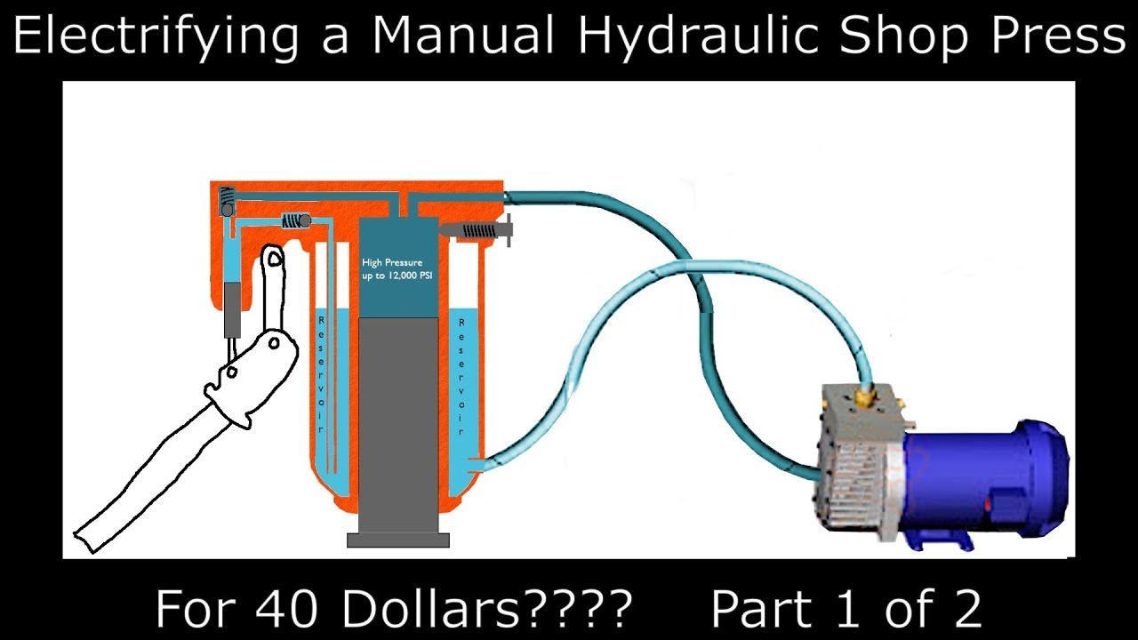

What I am looking for is changing out the hydraulic cylinder with a …More civilized …way of raising the boom without having flashbacks to my single days…
has anyone done this or seen this…not my single days…the conversion of the hydraulic unit…
This isn’t with a hoist but the principle is the same. Converting a ram from a manual pump to electric. The presentation isn’t the best but it covers the main points.
You can buy an electric hydraulic pump… there are some cheap options(Vevor) and not so cheap options.
For a hydraulic hoist I think it would be best to change the ram from a single action cylinder to a dual action.

Could you replace the jack with a pressurized air hydraulic jack?
If you are going to stick with the single action ram and use springs to retract you could just convert the ram you have following the process in that video and use an air/hydraulic pump.

@jamesdhatch the problem with the bottle jacks is they are usually 6" lift…the cylinder on the hoist has a 16.5 " lift range…
@72Pony now that is cool…i like the concept but not sure I need the spring retraction as it is heavy enough to lower it…but the foor pedal seems a little awkward…

nope…turns out it only fast lifts till it hits a load…then you need to hand pump…close but no banana…
Where are you reading it is only until it hits a load?
If the reviews…I think it is still working as advertised, just slower because it has a load on it. I have been using 20ton air/hyd bottle jacks for 20+ years and they run fast until it hits a load then it does take another quarter second to pressurize the air to actuate the motor.
If you want a rapid raise, then you have to go to a straight up electric hyd pump. $$$
I have a Vevor air over hydraulic jack on my 20 ton press that will keep going into it breaks something under air pressure. No hand pumping required.
Be prepared to change the air fitting. The one that came in mine was some weird formed sheet metal thing that didn’t resemble any air fitting I’ve ever seen.
I installed a air over hydraulic cylinder from Harbor Crap, works great no more hand pumping and still have full height of lift. I will get pick later today. Cylinder is 26" collapsed.
