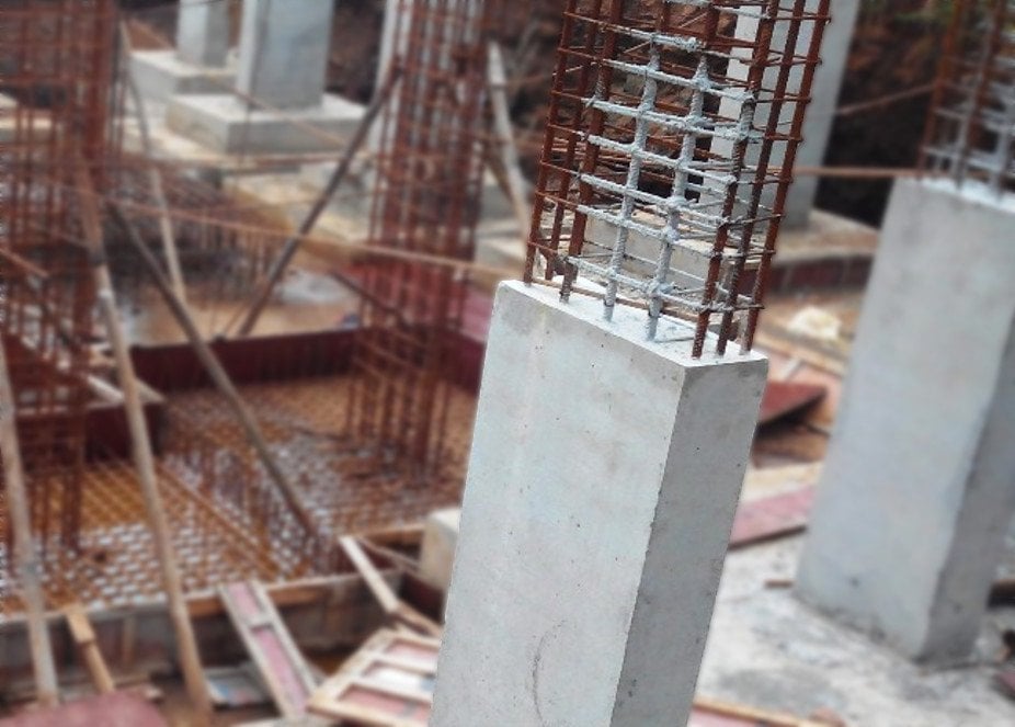

Answers are never simple. Tensile strength of concrete is only about 1/10th of it’s compression strength.
Why Does Concrete Have Great Compressive Strength, But Poor Tensile Strength?
