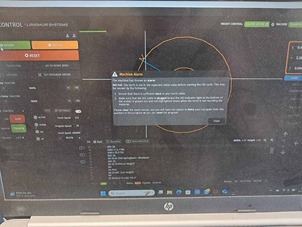

I haven’t been able to make my legacy crossfire cut. I’ve down loaded a file from Fireshare that says ready to cut and checked the box to not use IHS but I still get the alarm for IHS light on. I can dry run the program and the torch will fire manually. I’m still missing something but what?

I’ve tried it both ways. The last file I tried had the box for turning off the IHS and I did that. I’ve also tried selecting the “run as is” and the other box but neither turns off the light. You guys will have to bear with me. I bought this unit from a guy 4 years ago who said he would show me how to operate it. He came over one night and couldn’t get it to load and I never saw him again. When I finally got time to mess with it this winter, after I retired, I found a bad driver board in the enclosure and had to buy the upgraded Firecontrol electronics to get it to operate. I’m trying to figure out Fusion at the same time but it seemed like it would be easier to down load a file from Fireshare the was ready to cut. I know I’mmissing an important step. I just don’t know what it is.

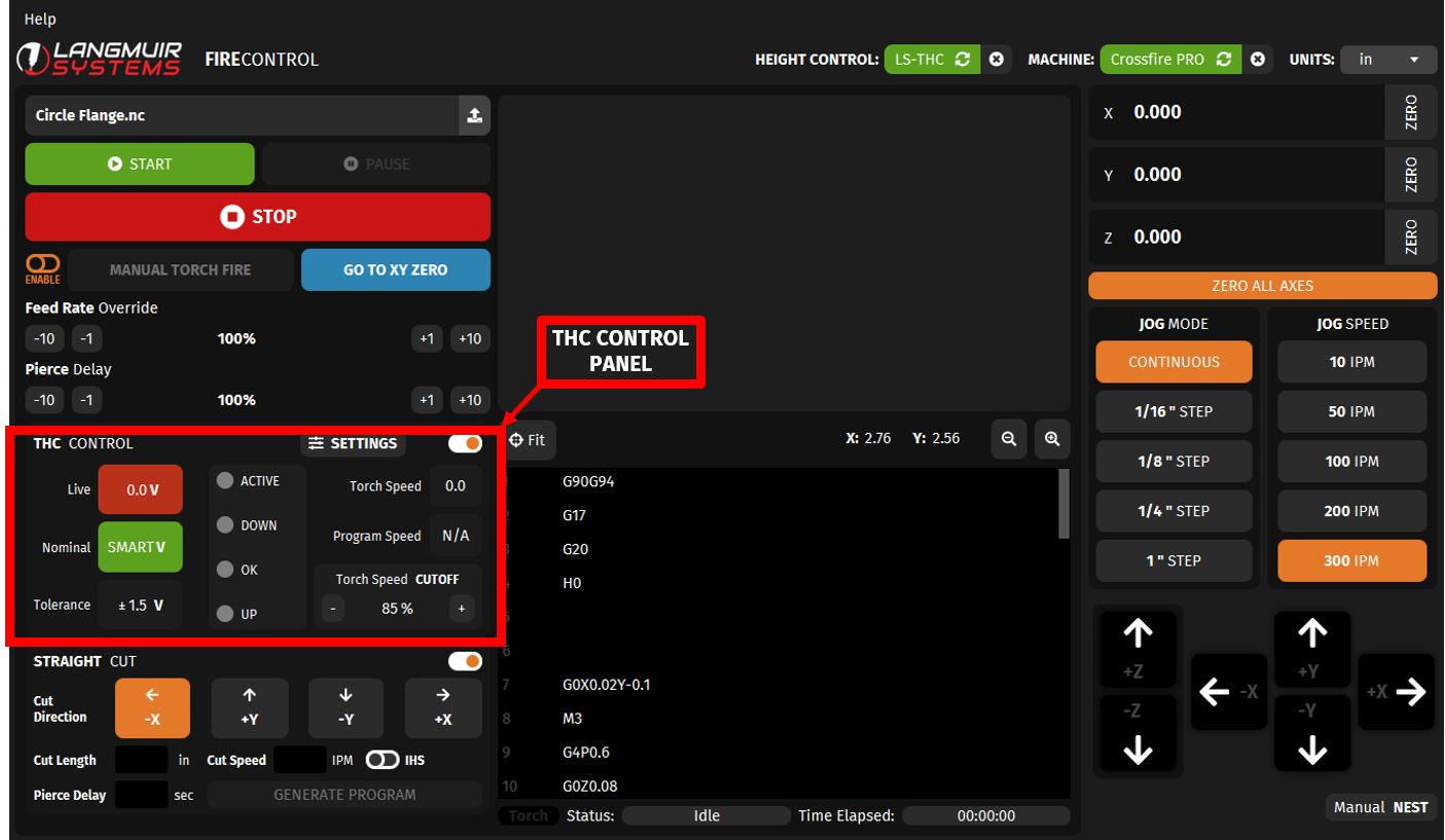

does it happen if you try to disable the ihs and thc in firecontrol? or are those options greyed out since you don’t have them.
I don’t know how I would disable them, I haven’t found a button for it. Part of my problem is that my table is in the garage but I don’t have good enough service out there to do much. I don’t know what Firecontrol will do until I go back out there and plug in.
you can disable thc, if it’s not already greyed out, by moving the slider to the right of SETTINGS.
I thought there was a slider for IHS as well, but i didn’t see it.
Can you post a screenshot of the error message that you’re getting?
It doesn’t make any sense that you’re getting an IHS error when there are no IHS commands in the file.
The THC control is grayed out, I never see the box you outlined. If I go to straight cut, it does give me the option to turn off IHS, as shown in your screen shot. Obviously, it doesn’t affect what I’m trying to do.
This is a screen shot someone else had used in another post, I borrowed it because it’s the same one I get.
That should not happen on a machine with no Z axis and no Z axis commands in the code.
