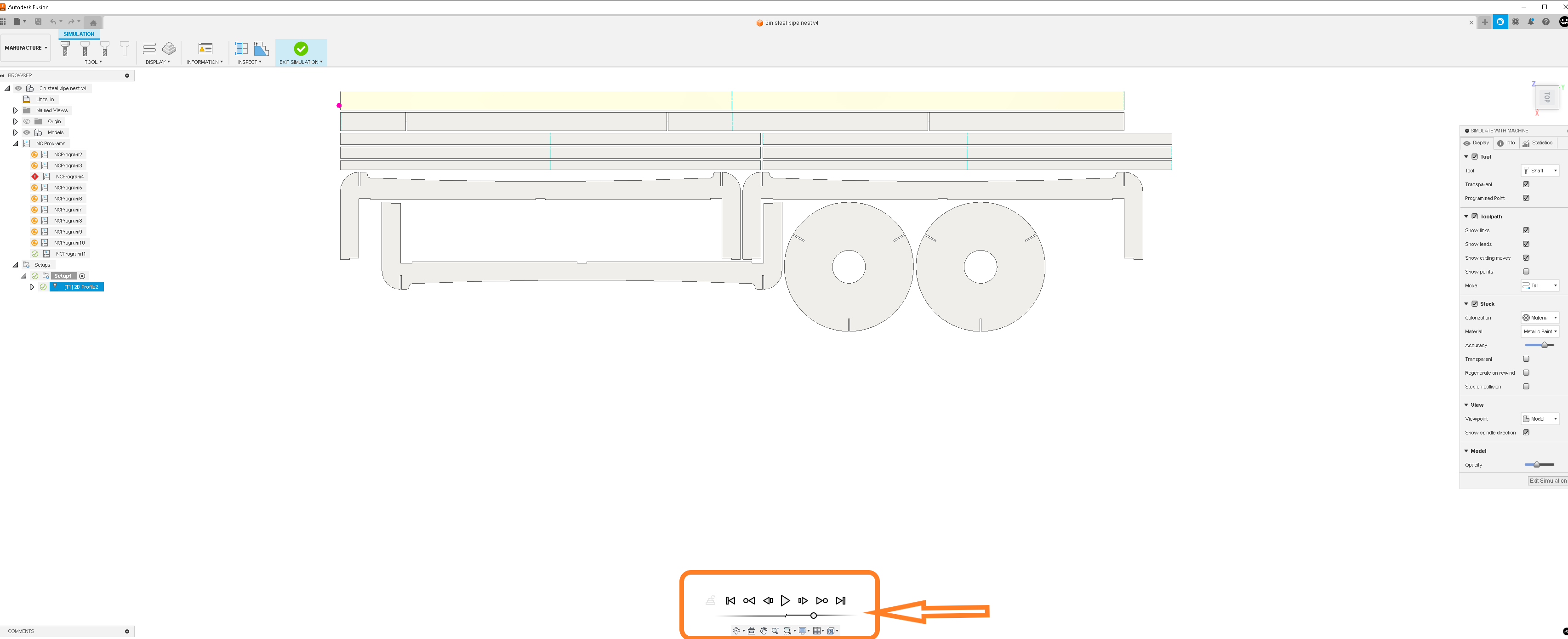

This is my second project with my cutter. I have tried to get through the Fusion 360 manufacture multiple times and I cannot get it to where it will simulate the cutting (which I did successfully on my previous project) and I am assuming you need to do so you verify it will cut. It looks like I have the cut paths correct, but when I run the simulator, it just sits there when I hit the start button. I have attached the .SVG file I am using and also the .nc file.
I am at a loss and any help would be appreciated.

I first glace the file looks good

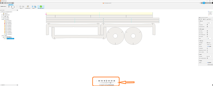

check out the simulation speed slider. sometimes it can be so slow it looks like its not moving.
A simulation is not necessary to get cutting but it is a nice double check of the work.
I’ll agree with @TinWhisperer , you may have the speed slider set to slow. Try moving it to the right a bit to speed up your simulation. (If you move it all the way to the right, you won’t see the cut. It’ll just be finished.)

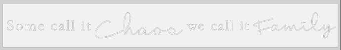

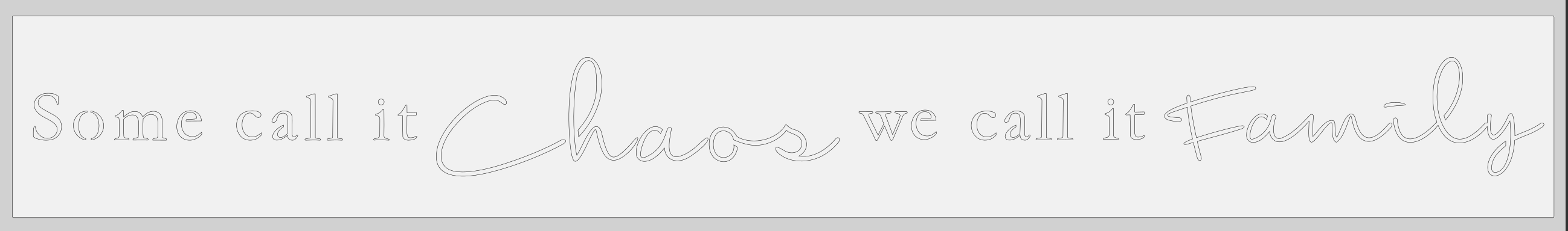

This is what it is supposed to look like. Also, when I tried to upload the .svg file or the .dxf file, they would not upload.

I figured out that I was not doing the settings correctly and as Simworrx pointed out above, the fusion file only had the exterior box on it. I played with it and got it correct in fusion, then did the setup and postprocess and it came out well. I really liked the NCViewer site that TW recommended, that worked great and my .nc file ran fine in it. I still wasn’t able to get F360 to do the simulation, but I’m home now and going to cut it tomorrow because the NCViewer seemed to run it corrrectly.
