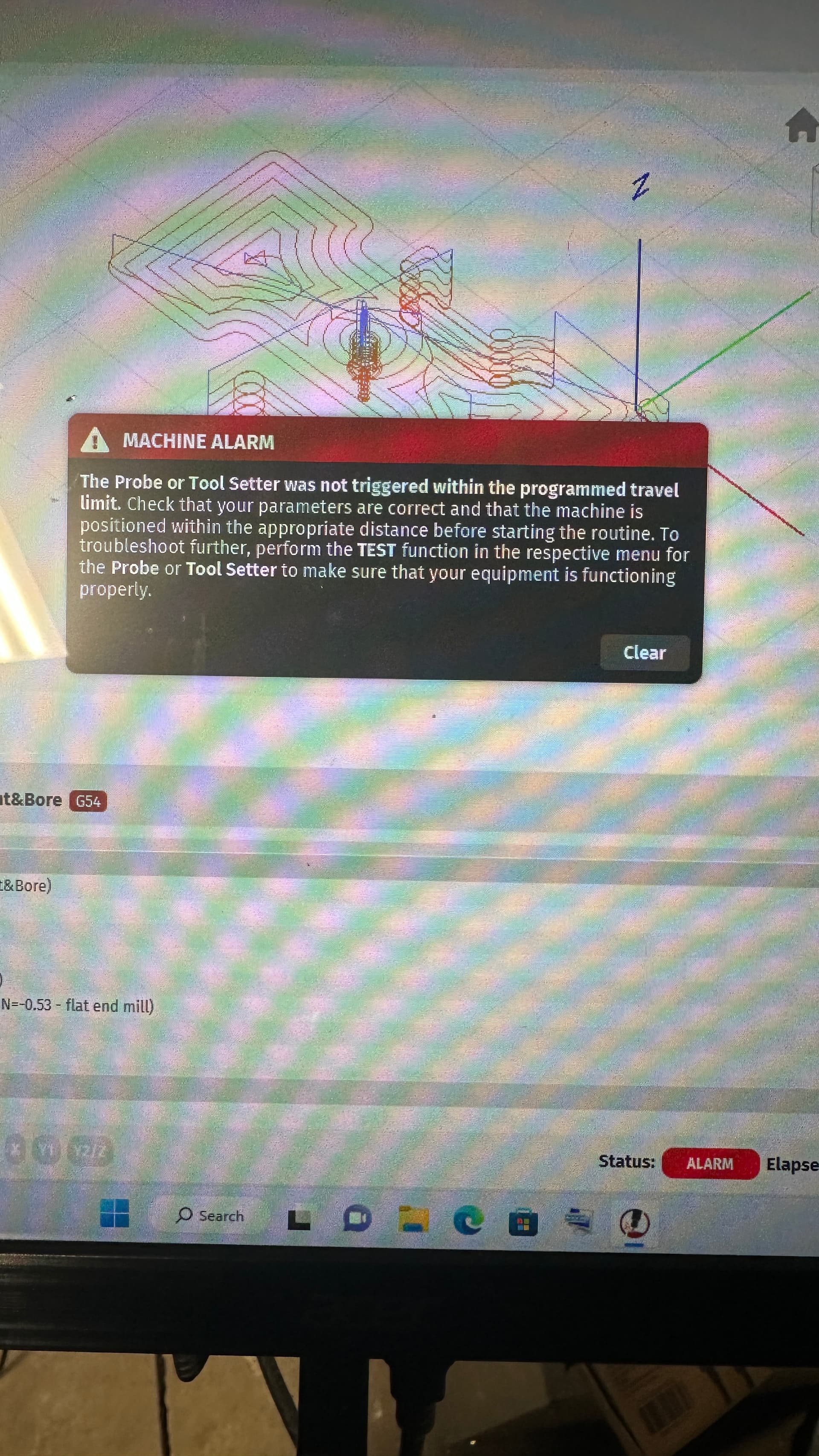

I have a couple questions I am confused about.
A) Can a motor miss steps while under a load?
  1. I am cutting parts that are the exact same
  2. I am using a stop block to do this so I am positive the part is in the same place every time.
  3. The tool is zero’ed out to the top of the part no issues
  4. I can run 1 or 2 parts then go back to Z zero and I am 1/8-1/4" above the next part.
  5. I have marked and checked the bit several times to make sure its not moving in the collet
  6. I can re-zero the bit with the tool setter no issue then run another part
  7. I can run 1-2 parts then the Z again loses its work zero and is 1/8"-1/4" above the part
  8. I go to re-zero with the tool setter and get an error message attached.
  9. If I rehome the entire machine again I can then zero the bit with the tool setter and return to work zero.
  10. This starts all over again
I cannot figure this out. It is as if the bit is walking in the collet but it is not OR the Z axis is somehow missing steps? If the bit is not moving in the collet I should be able to zero the z as many times as I want and not have to rehome the machine. I have almost 1.25" sticking out of the collet.
B) What is the limits for others here for the lowest the spindle can travel before its completely out of travel (-6.???). My Z negative is -6.27 machine DRO and I am out of travel. This puts my collet 2.25" above the bed. Is this normal?? If I have a bit sticking out of the collet 1.25" I am almost not able to reach the tool setter.
yes, what you are seeing is missed steps. I see it a lot if i am trying to do a heavy cut. i found the feeds/speeds listed are way to much and i can stall the motors. try cutting less and see how much it improves.

your width off cut will not affect your z zero for lateral moves. I would try dropping the plunge feed by half and see what happens, the machine alarm is weird but i assume it occurs while the tool is trying to reach the tool setter? If that’s the case then it makes sense as the machine believes its out of travel but it is not. Not sure how much time you have on the machine but lots of people had to back off their z lead screw bearing due to skipped steps under no load. Your z drive should solve it but I would try reducing plunge feed first for fun to see if it solves your issue.
