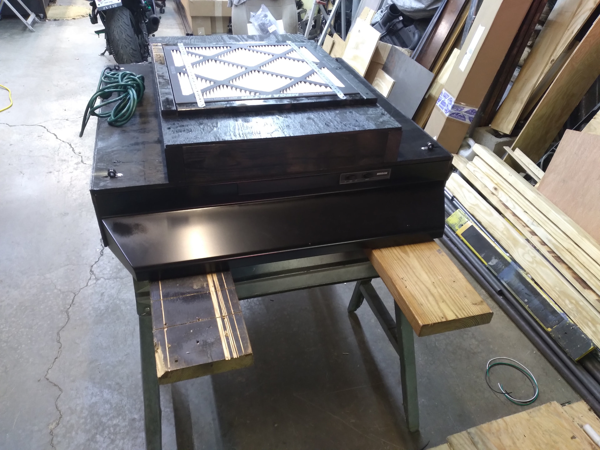

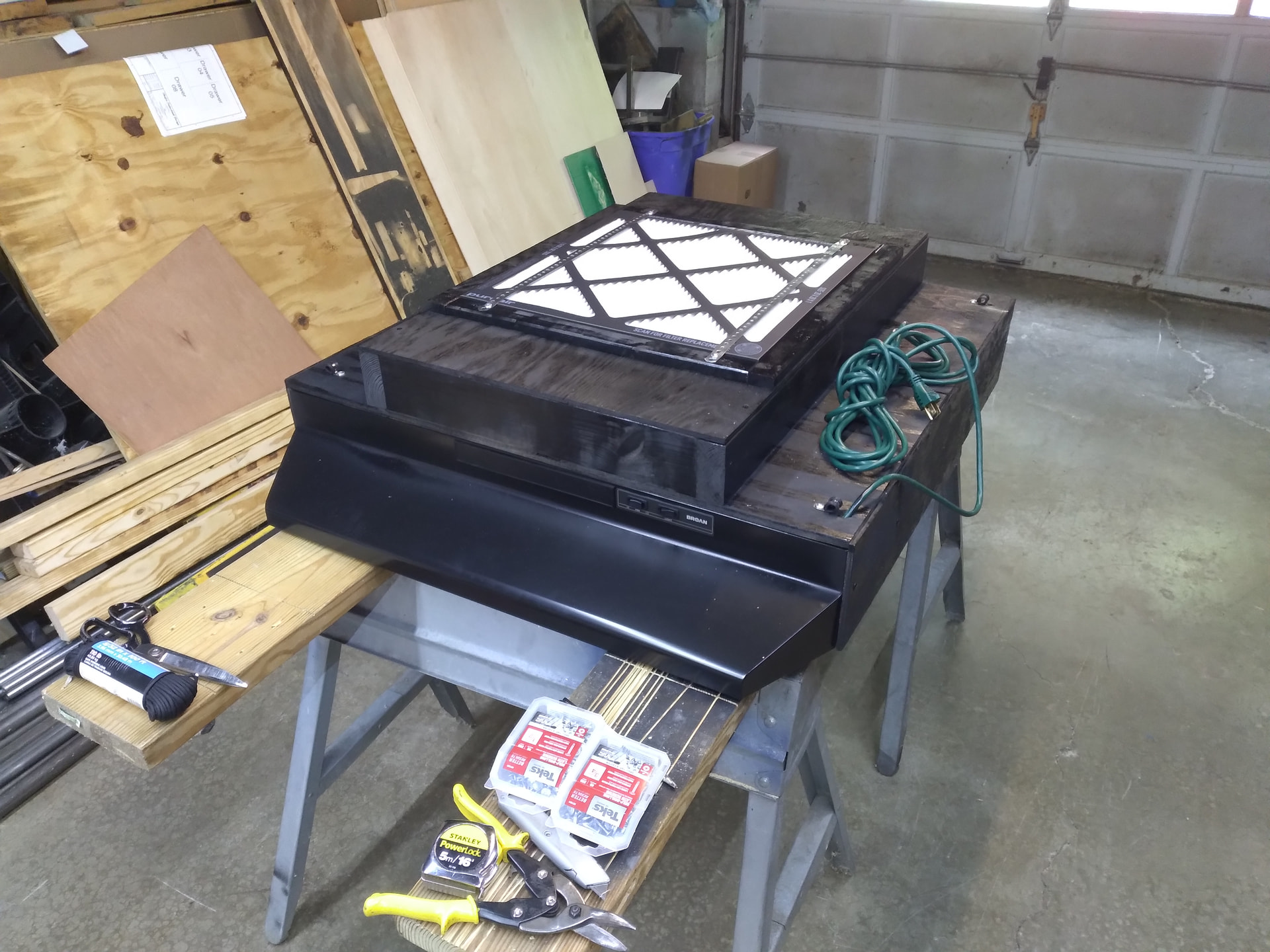

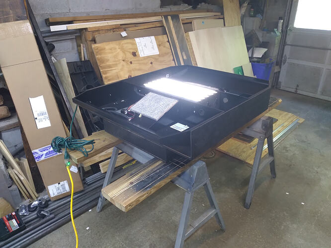

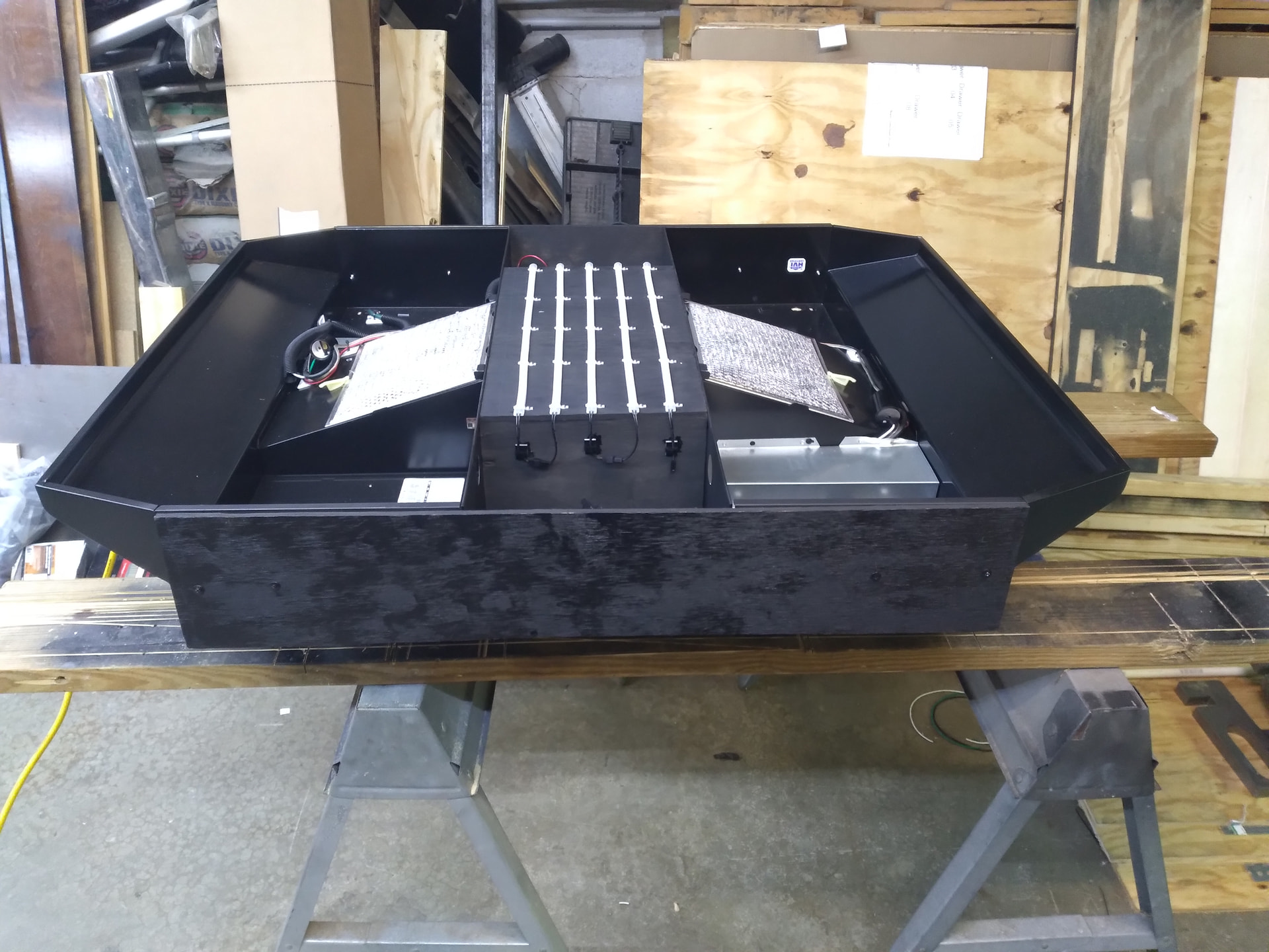

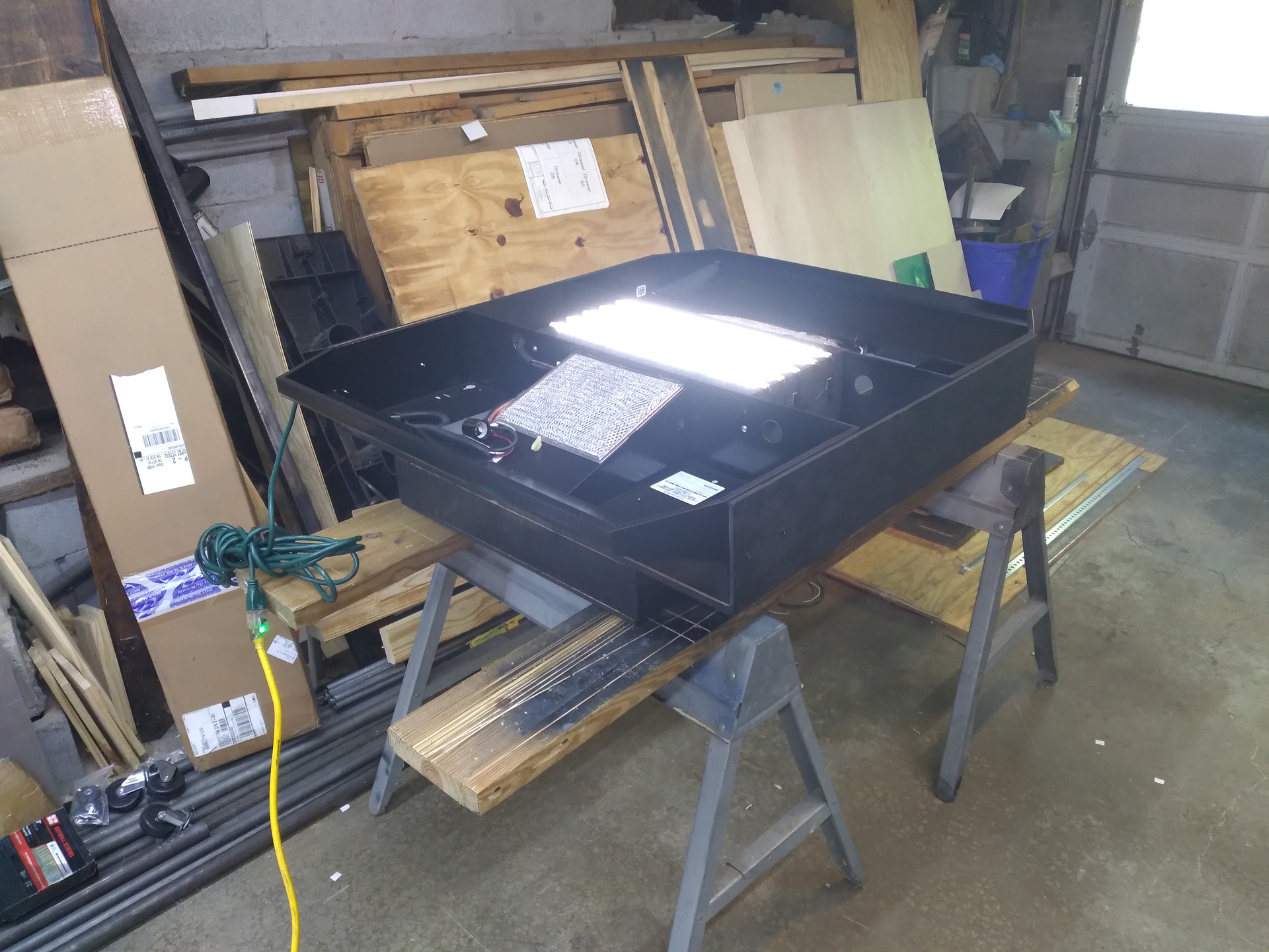

Built a plasma table plume filter out of two stove-range hoods

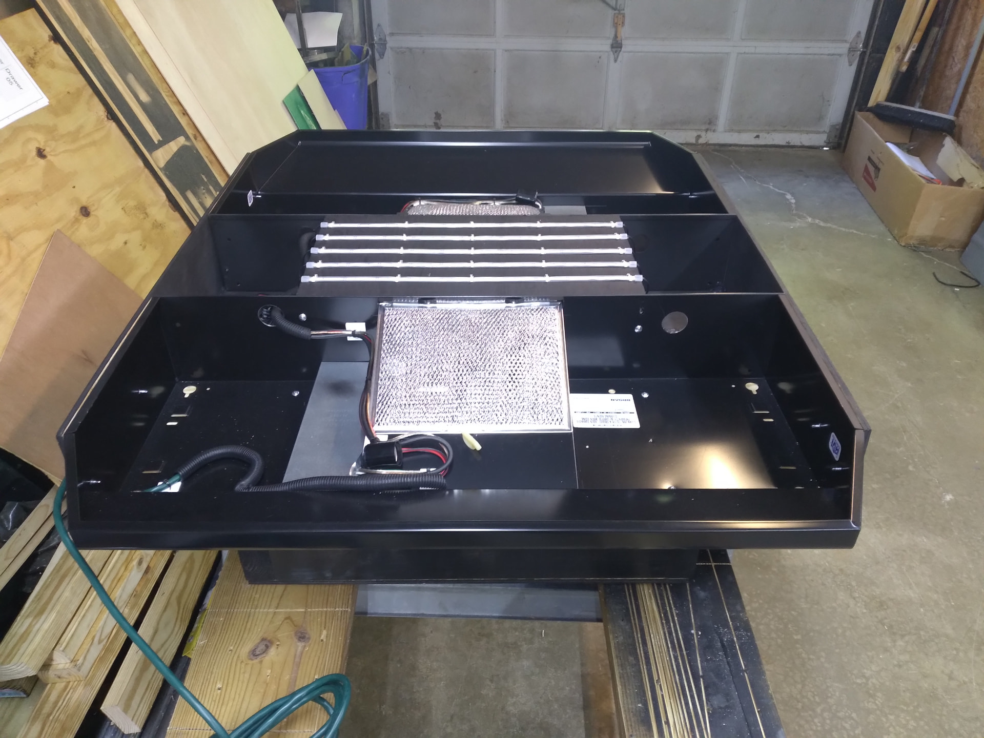

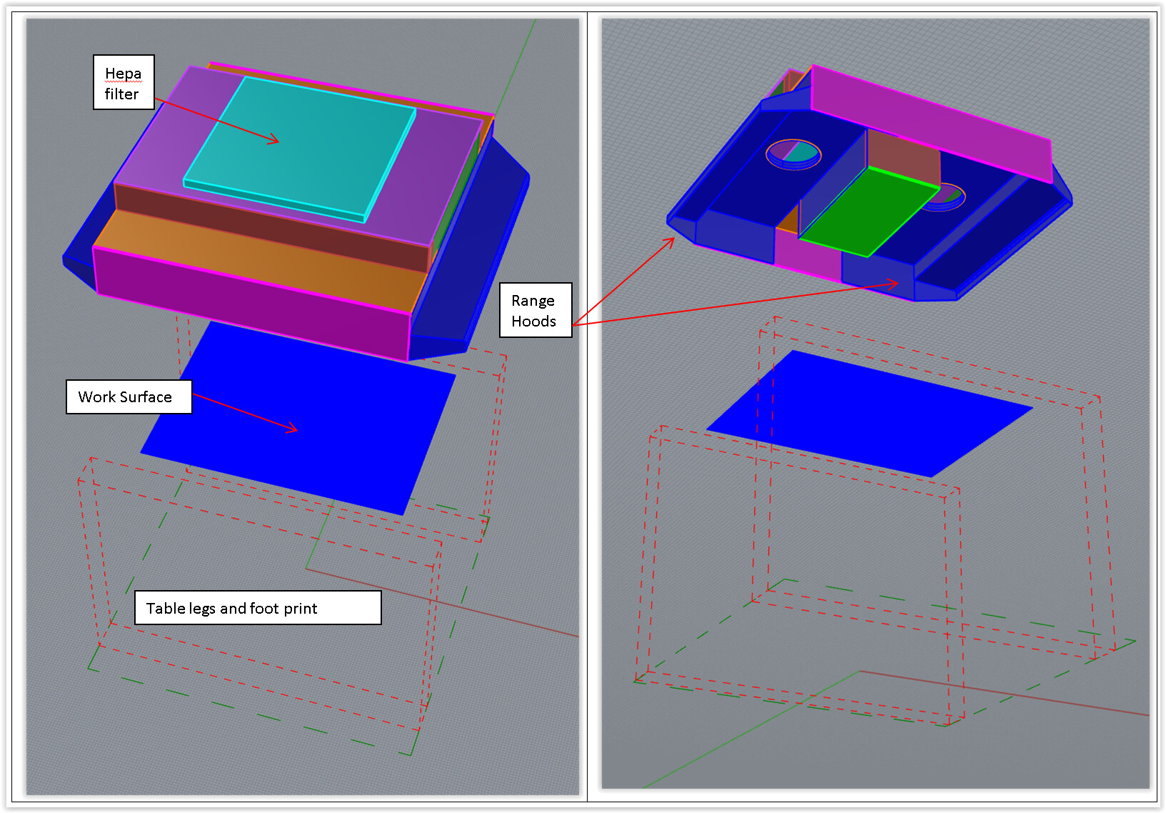

Built a plasma table plume filter out of two stove-range hoods. Added 5, 20inch LED strip lights. The light switches and Fan speed control switches on each hood are wired in parallel to it can be controlled from opposite sides. I used a 20x20 inch combo HEPA and charcoal (odor control) filter. Honestly, the water table captures almost all of it, but I figure if I ever cut some exotic metal then I will for sure use the plume hood.

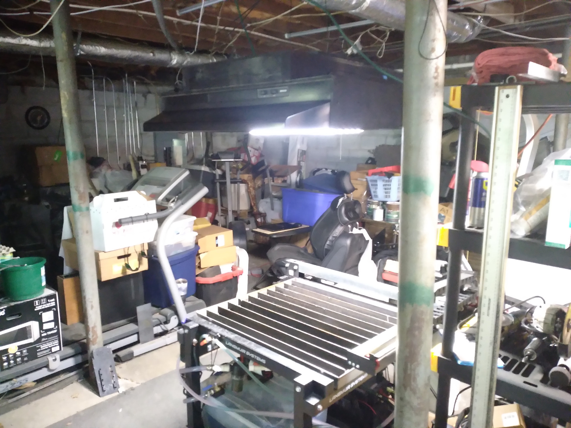

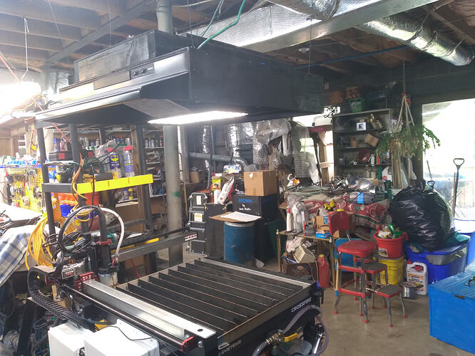

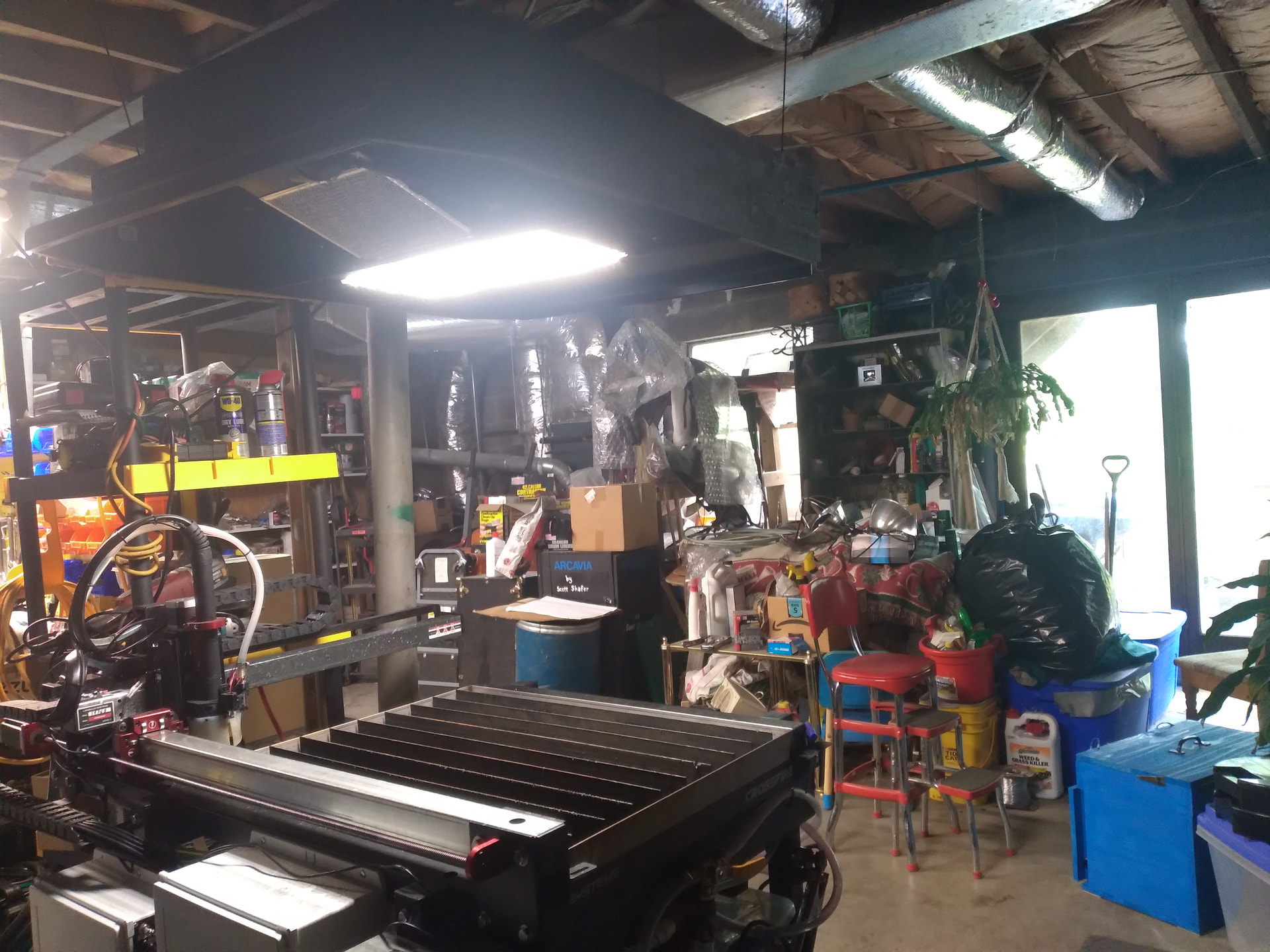

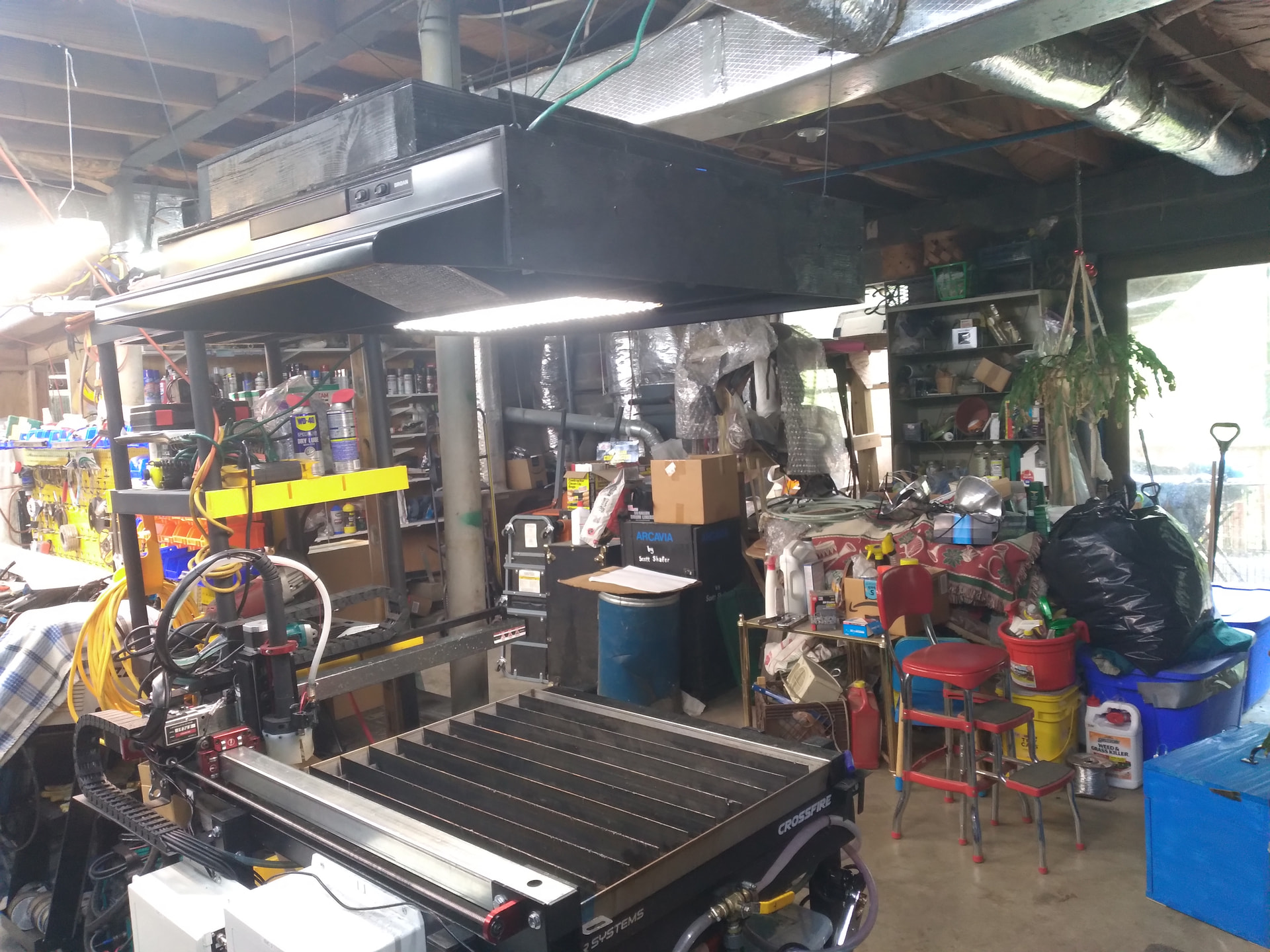

Finished installing my Filter/plume hood. I used two Stove Range hoods, and added LED strip lights. The airflow goes out through a Hepa-filter with charcoal to eliminate orders. For regular steel the water table catches most of the fumes, I figured if I have a long running cut, or some kind of more exotic metal that I can run the filter.
Poppabear, that’s a lot of stuff packed into that building. Just kidding. Organizational chaos like my shop. Vent system looks great. I have an exhaust fan in the wall above the table, but I dwell on all the fumes I’m breathing in while cutting stainless steel, chromium, and aluminum. At 70, I probably don’t have many left, I think to myself.
