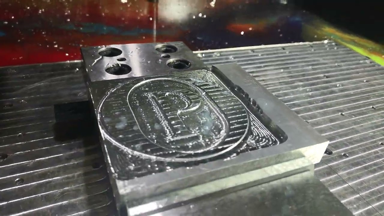

With some help with my mr1 problem’s Jake got me set up to start using this unit this is the first thing I milled
Just a quick test cut in wood before I trash some 6061 aluminum
