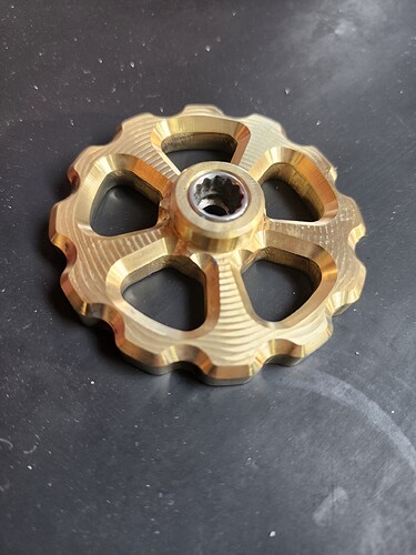

Bronze hand wheel

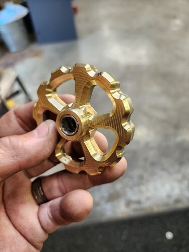

MR1 did an awesome job on this bronze hand wheel. Had to press in a 12 point socket to fit the stem.
That looks really good. Just out of curiosity how many tool paths do you have in this?

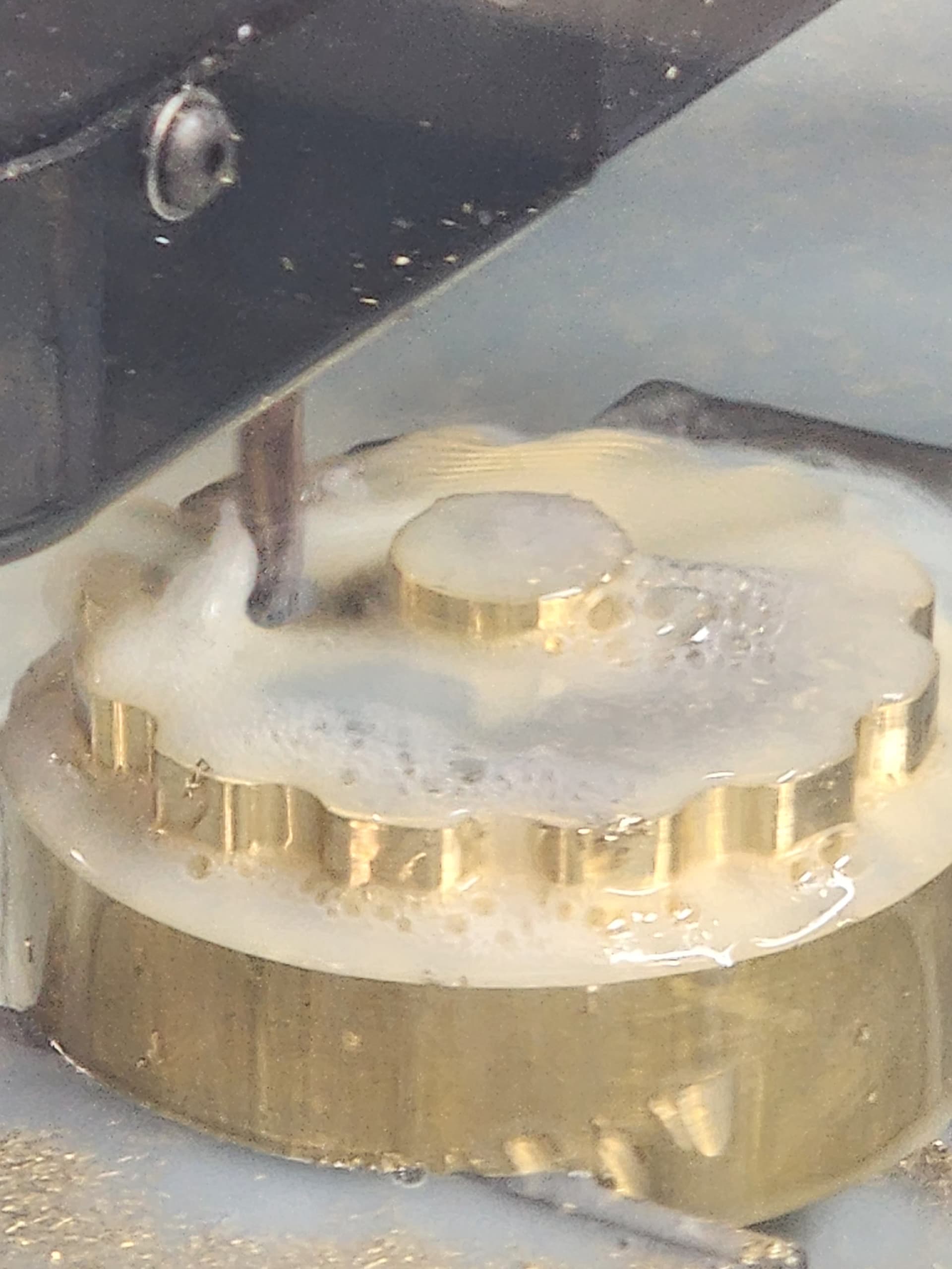

And let’s see the op 2 setup :sunglasses:
5 tool paths. 1 with 1/2 end mill, 3 with 1/4 endmill and 1 with 1/4 chamfer mill.
I don’t own the MR-1, but curious how the wheel was separated from the blank after first side was completed, bandsaw or lathe parting tool or something else?
Southbend Heavy 13 lathe.
