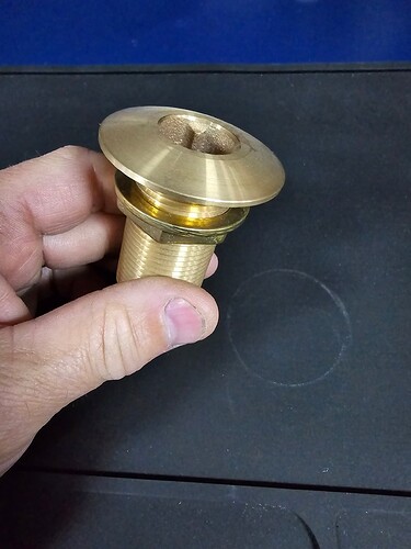

I might try and knock out some sort of adapter on the lathe and see if i can gasket it in. Either way, going to be a few weeks now before i can run this again.
This may be an option for you. Now, this is not NPT. It is a straight thread, but you can screw on a fitting with some gas pipe dope.
I have them in our store if you would like to give it a try. I would machine down the end with your lathe to fit into the drain.
Here is one I found that has a hose nipple cast onto it. It is 1".
They do make smaller ones if this is too large.

Ill check out those fittings, thats exactly what i was thinking. Looks like the hole in the bottom of the drain is 7/8" so ill see what i can find to fit that.
A 3/4 version of this has an outside diameter of the threaded section of just over 1"
