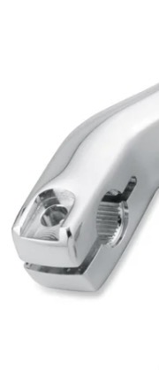

Curious if anyone has done any broaching on the MR-1 if so can you spread some light on that I’m trying to do something like this
The spindle doesn’t lock, so our only option is rotary broaching. There are a couple of companies that make them and they do run fairly well on lower powered machines. Polygon Solutions is the company I’ve used the most and they have quite a few serration sizes to pick from.
The down side to rotary broaching is that there is no sure-fire way to know where your splines will line up. If spline orientation is not a critical feature then it may be worth a look.
