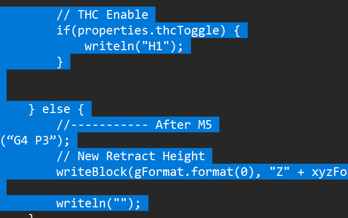

I picked up my Crossfire Pro used and am a bit of a noob. Wanting more juice for thicker cuts, I purchased the BTC800XP recently from Amazon for $617+tax. I read this post while I was trying to make the decision to pull the trigger. Being a bit of a noob, I didn’t understand what this 3 second delay really meant. For the benefit of anyone else considering the Bestarc, I’ll try to put the 3 second delay thing in terms I might have better understood before my purchase.
For example, my wife has me cutting some 24x24 monogram signs for some last-minute family Christmas gifts. As you can imagine, the cut path for the torch involves a lot of pierce/cut sequences. The first pierce/cut works just fine. However, when the torch moves to the 2nd pierce/cut in the pattern, the torch fails to fire and an error pops-up on FireControl software. Granted, you have the option to retry the failed cut and that will work. But, when the torch moves onto the 3rd pierce/cut once again it fails….and will keep failing on every pierce cut after that in the pattern.
This is all due to the 3-second post flow requirement the Bestarc has baked-in internally. Tobias, thank you for your original post and the leg work on the issue. Just wish I could have connected the dots sooner :slight_smile:
Some solutions…
  1. Modifying the FireControl-v1.6.cps file with notepad (it’s just a text file) as Tobias pointed out above. This is pretty fancy. When you load the file with those changes into Fusion 360, you will see the option to add your delay.
  2. Modify the FireControl-v1.6.cps by simply finding this line in the file… //————–After M5
    and then insert this line below that one… writeln(“G4 P3”);
    When you load the modified file in Fusion 360, you won’t see the option, it will simply add the 3 second dwell for every cut.
  3. Or you could leave those files alone and manually add G4 P3 in your gcode files. Like I mentioned before they are just text file that you can open with notepad. Simply look for the lines that are M5 and add G4 P3 on the next line.

Unfortunately, these solutions are really more like a work-a-rounds. When I ran my first file with the extra 3 second dwell instructions I was feeling like I made some headway. I thought, this may be ok after all. Then, I decided oh, I’d like to set the post flow dial on the Bestarc to 15 seconds. Bad move, this caused the next pierce/cut to fail again. I dialed it back to 5 seconds and things seemed to keep working. I would wait until I was on the final cut and I would turn up the dial to 15, which worked after the final cut. Now, all I had to do is remember to dial it back to 5 before cutting my next monogram. Hmmm….all I have to do is remember, this, that, and then this…grrr.
By this time, I had spent a full day chasing this issue and my patience had all but run out. So, the Bestarc was delivered on Friday, spent all day Saturday chasing, by Sunday evening it was packed back up, and Monday morning it was at UPS on its’ way back to the Amazon.
I really think if Bestarc can get that one thing resolved, they’d have a nice budget machine contender. I just couldn’t live with the on-going hassle.
Well, while it was a pain going through all of that, it was a great learning experience. It also made me feel much better about my Monday purchase….82i on the way.

So by theory this could also perhaps be an issue on the BTC500XP unit since it shares that same 3 second post flow. I’m unsure if you can initiate right after stopping by pulling the trigger again but it seems odd that the couple of youtube videos I have seen on it using a langmuir system failed to mention it at this time. I am still setting up stuff today and have a little scrap metal I can test on and see but thanks for the info on all this.
Is this what I should be entering if this is true for the bestarc btc500xp as well?
