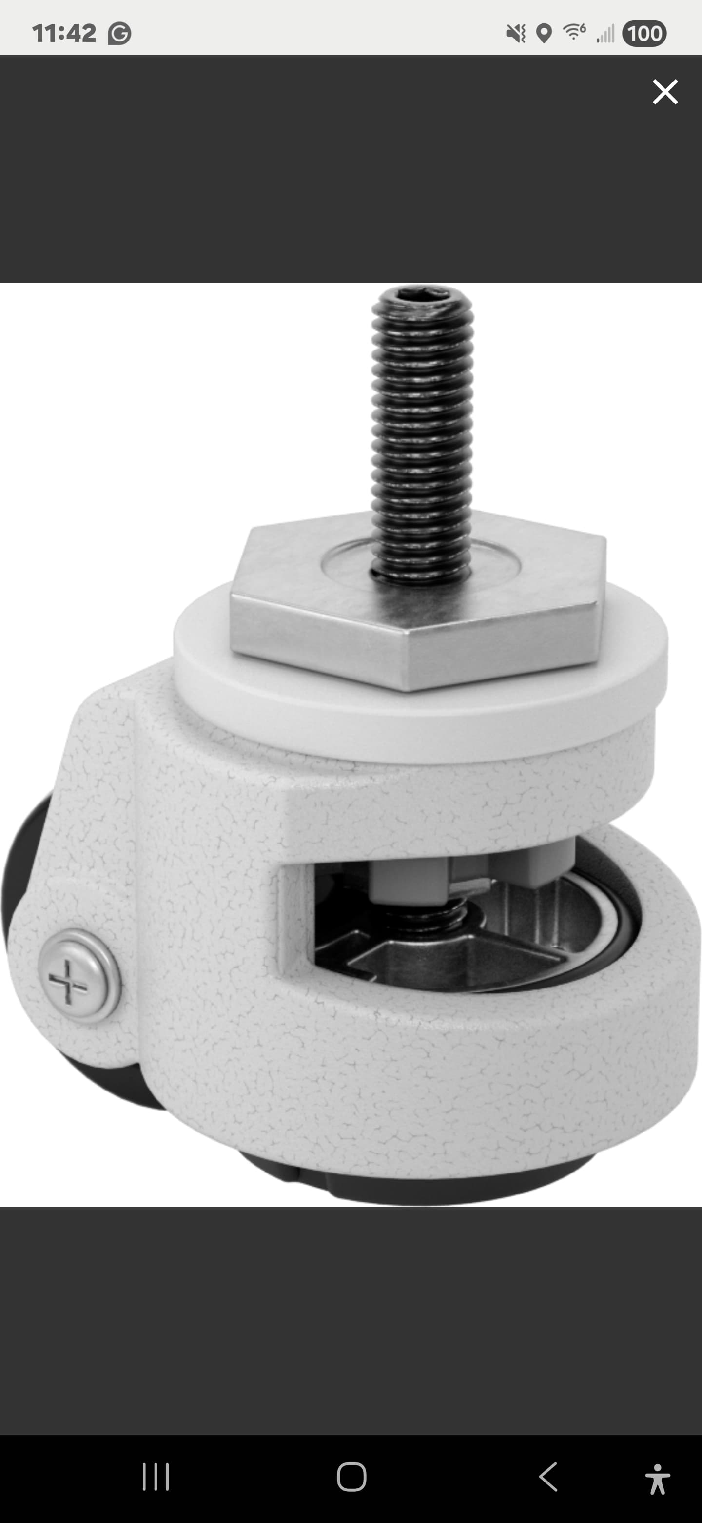

These are what I used. I believe that the threads on the table legs is M12 metric. Check this out before you buy them. 5 years now, and they work great still.
I have the same castors as BigDaddy. Keep in mind that the actual wheels have a relatively small size and really require smooth floor surfaces to roll well.

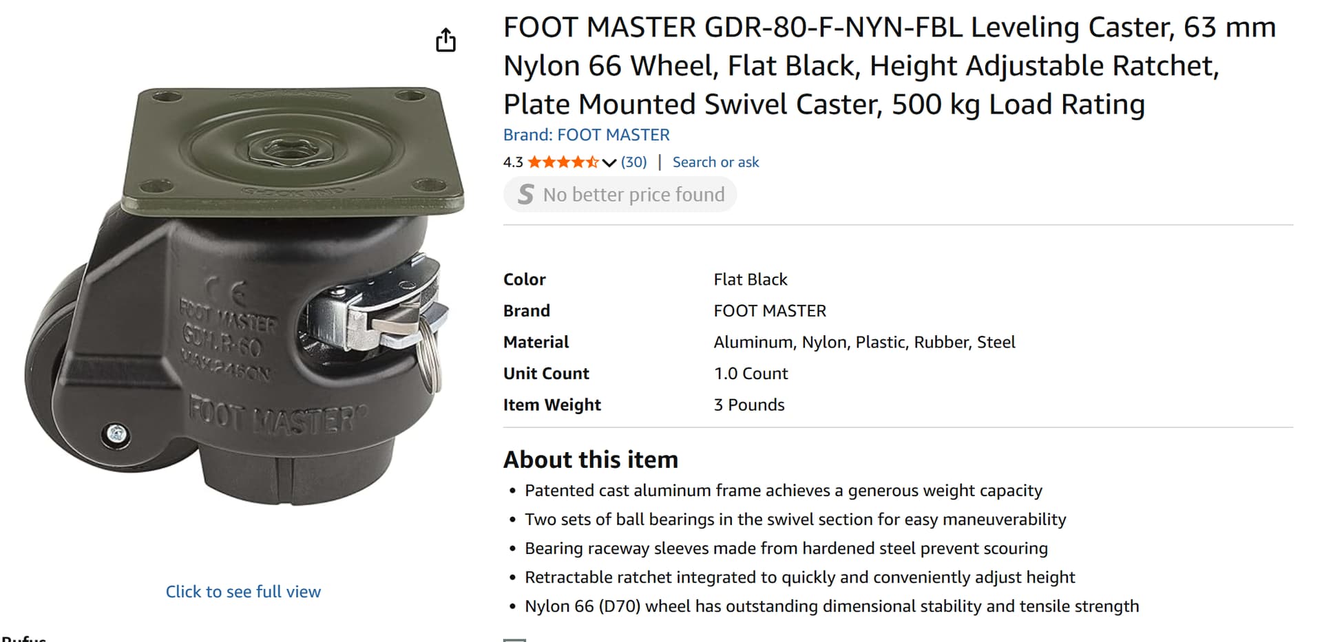

I have these…Amazon.com
The are more or less the same as the ones BD mentioned but the have that little silver protrusion which is the adjusting lever/rachet that slides in and out (the pic is the out position). May not seem like much but it makes adjusting easy.
I have the ones BigDaddy posted and the ones that follow in the picture. I like the pictured casters because they have a lever that pulls out to ratchet the mechanism, then pushes back in out of the way. I find that the adjustment wheel on the first is more difficult to move. Big difference is the mounting method - stud vs plate.
