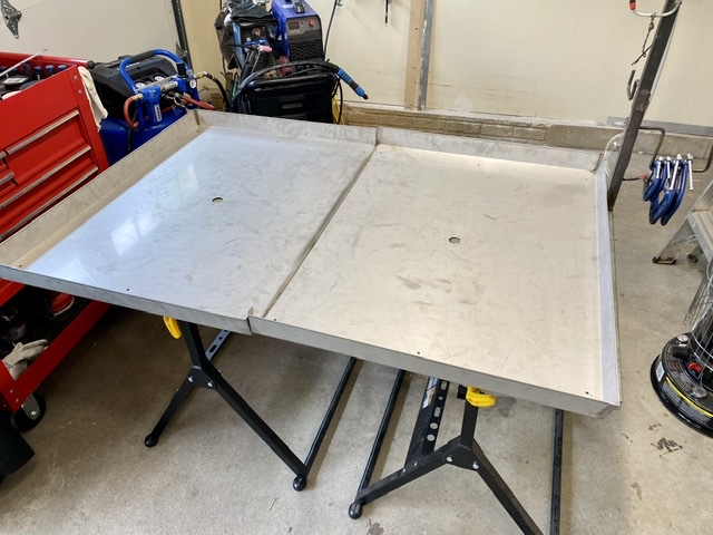

Finishing up the water table modification…removed the bolt seam, lowered it, then tig welded the entire pan into one piece!

I need to do that too.
Is the water pan stainless?

Yes it’s basically a 20-22 gauge stainless steel. When you start to weld it, do it in small sections constantly spraying it with water to avoid any warping. If you take your time it will end up perfect!
  • I used a 304, 1/16 filler rod with low amps on the welder
Hey thanks.
22 gauge 210 stainless
Well I guess I will give it a try. never welded stainless before. better go get me some coupons first and practice.
To make it easier since you haven’t welded stainless before, I would use the fusion method over filler rod. Run your tig welded at around 28-32 amps and make sure your tungsten is sharpened to a clean point. Also keep a spray bottle of water around so you can cool your welds as you go.
