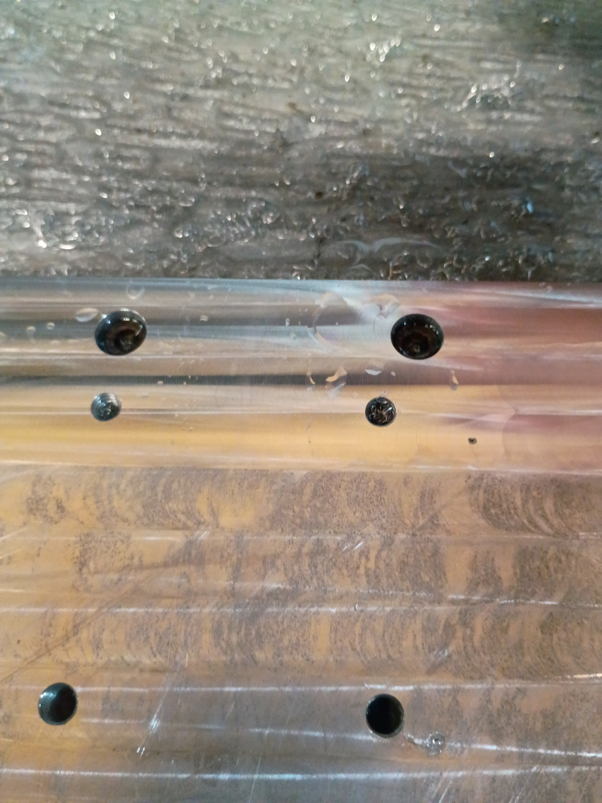

I built this last year and got it “good enough” for winter and little projects but now im actually doing production stuff it needs to be correct. I had this issue on the baseplate that when running langmuirs surfacing program with .5 in 2 flute i have lips on every pass. Like my nod is out. Y - with finger nail hits lip. Y + is not hitting lip.

Update, i shimmed the bottom bearings on the spindle side, this reduced the lip. I am going to get feeler gauges from the hardware store and cut down what i need and hopefully that will fix it
Sounds like you’re on the right track.
After adjusting the nod to get rid of any lip be sure to check your Z axis perpendicularity to X and Y. I found when I was adjusting my nod out I ended up getting some perpendicularity error showing up.
I had to back track and shim the carriage for my Z axis perpendicularity and also shim behind the spindle block to dial out the nod completely.
It was probably “close enough" for most of the work I put on this machine, but in the event I needed a really flat surface I wanted it to be dialed. I’ve held a few tenths parallel using a fly cutter to face parts, so it’s as good as I could expect for the cost of the machine.
