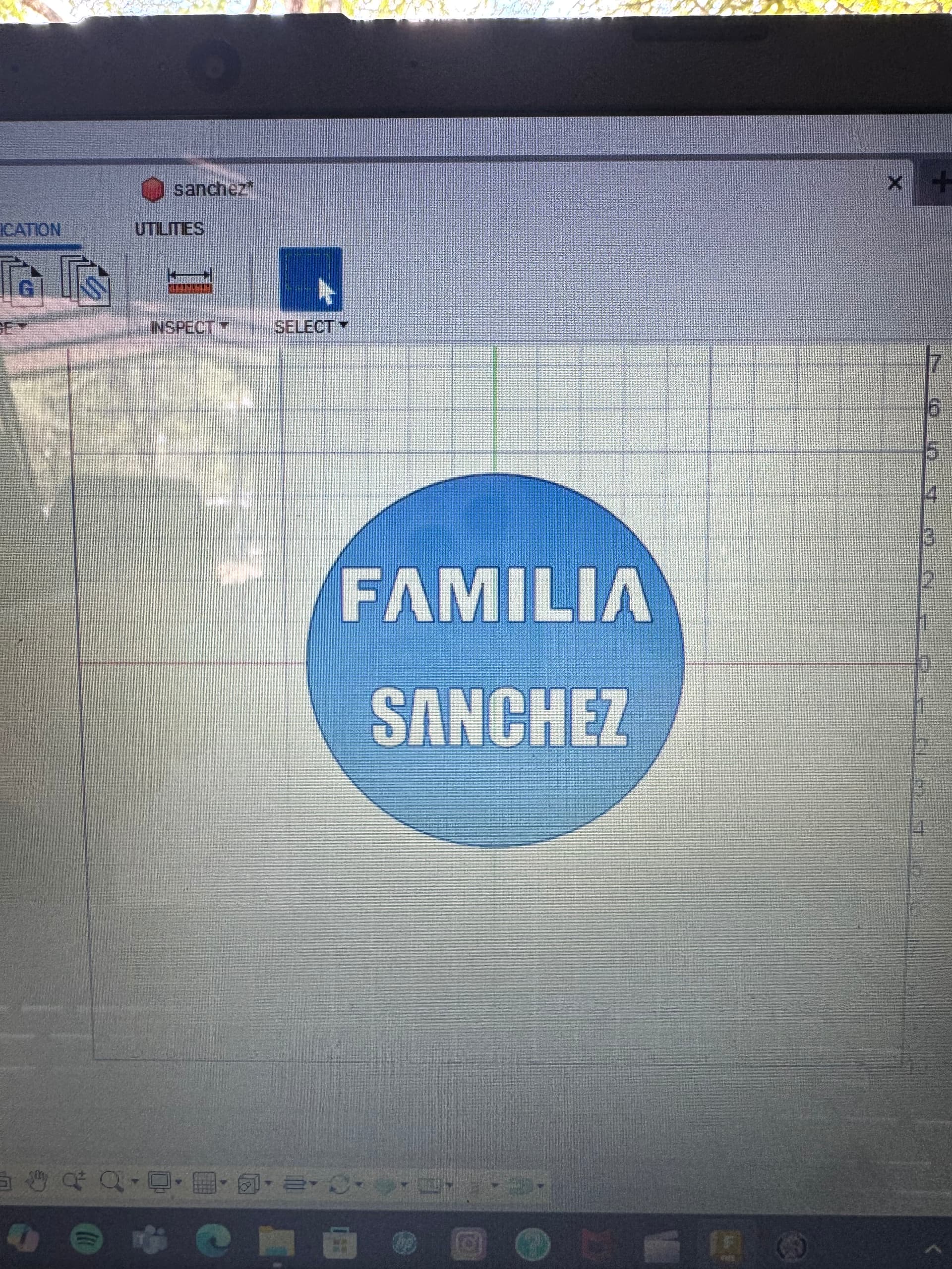

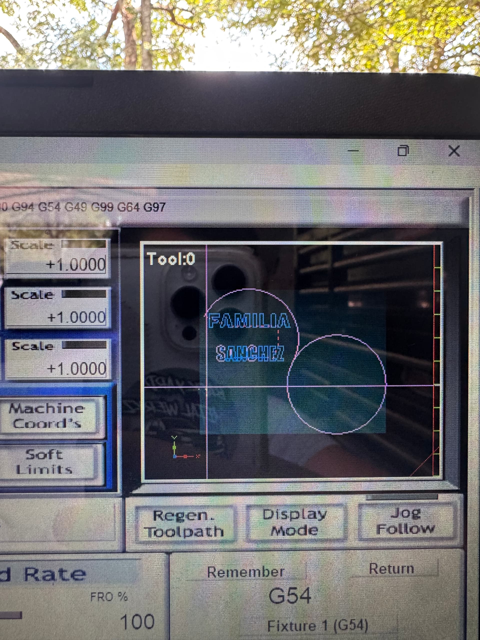

I am here seeking help on my gen one mach3 and autodesk fusion 360 when i go to make what i want to cut everything goes good but when I transfer it to mach3 the objects are moved what could be my issue
Your 2D vectors could be on different Z levels and slightly offset in X & Y. Once converted to a true 2D image by post processing, the offset could be huge.
When you view your vectors, make sure you are looking from one axis only (eg Top, Front, or whatever works)
