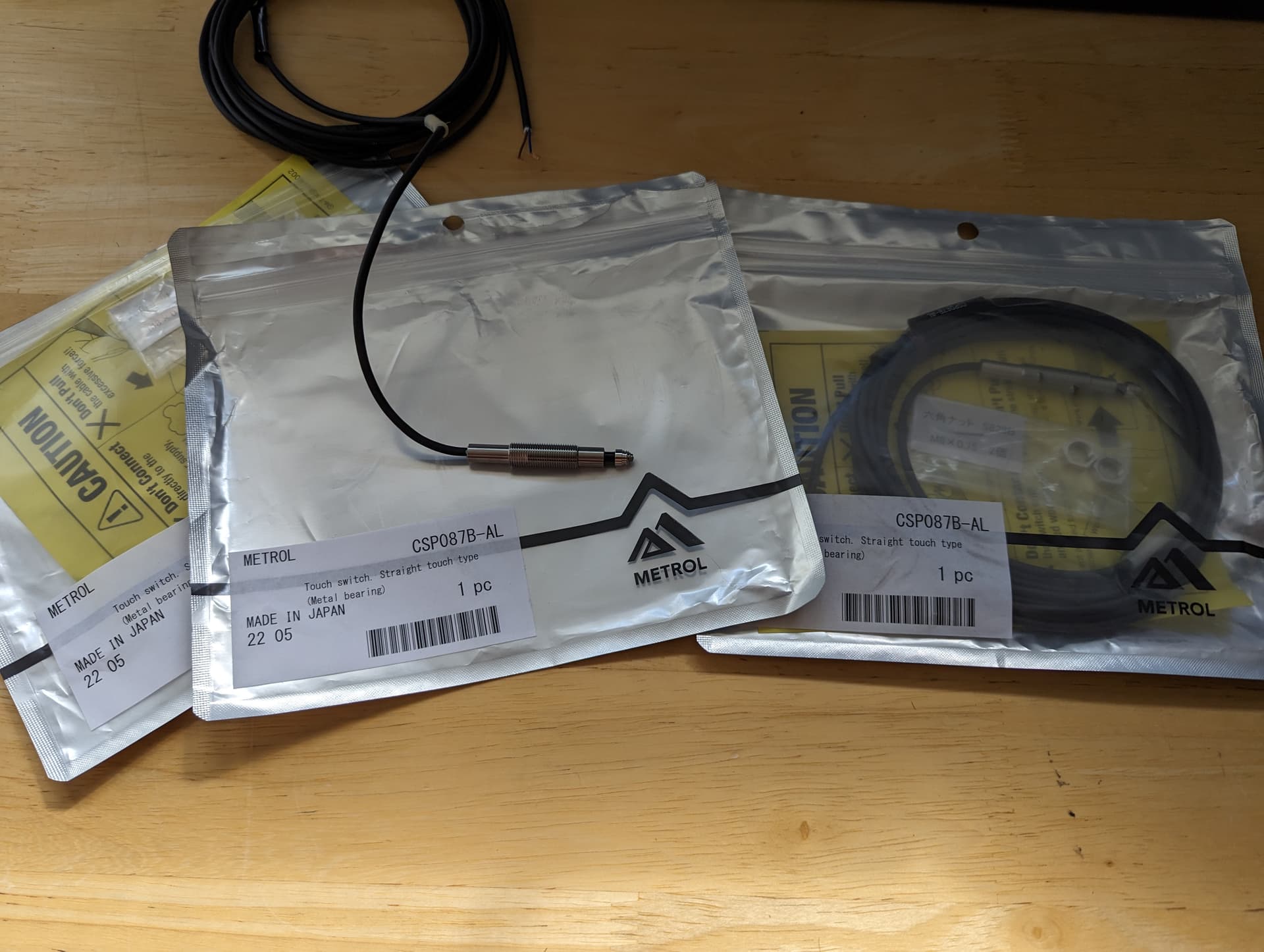

I got these in today.
Amos- did you wire them in yet and if so whats the wiring? Because of the led I assume the polarity absolutely matters. But I’m not sure what is positive vs ground on the stock wiring.
im pretty sure there is black and red wires, but its easily checked with a multi meter otherwise.
