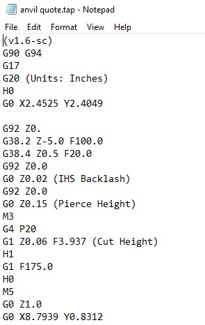

I’ve attached my Gcode that I applied to the following DXF file from Fireshare (Page 29, “Anvil Quote” - provided for reference anvil quote.dxf (398.8 KB)) and applied my gcode in sheetcam anvil quote.tap (144.2 KB); I’m attempting to cut this on 22 ga mild steel (would also like to cut out in 14 ga mild, too). I’m running a Primeweld Cut60 and I’ve not had any previous issues with other projects.

From your G-code you posted, here’s what I see -
G-code anvil
Your pierce delay is set to 20 seconds! (missing decimal?) Double check your tool settings. For 22 ga I would expect .5s or less. (.5s seems to be the minimum the FireControl hardware will accept. I’ve had some success with .4s)
Your plunge rate is at 3.397, 60 is a better setting.
Everything else “looks” ok.

I’m willing to bet the plunge fixes your issue. At that speed, the transition from pierce to cut takes ~1.5 seconds. Which effectively make your pierce 1.5 seconds longer.
I’ll also add that for thin gauge material, cut height can be a factor. SheetCAM adds .02" to your pierce and cut heights. (The IHS Backlash line.) You may wish / need to adjust accordingly.

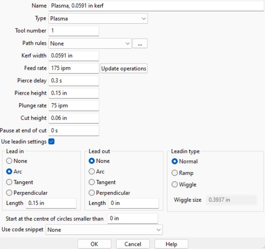

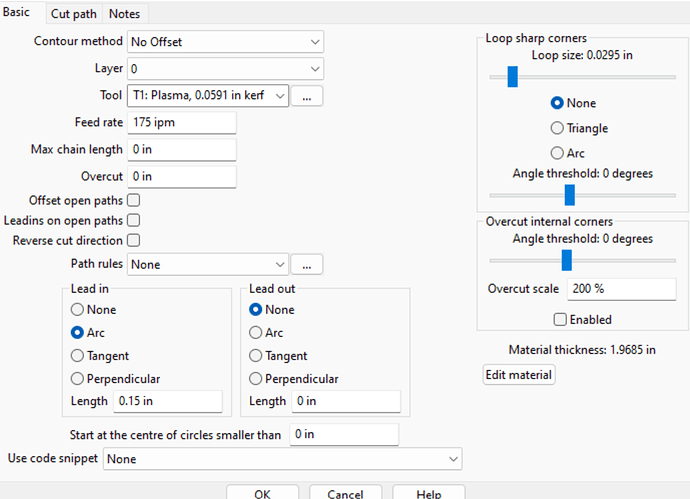

Any other thoughts? Here’s a screenshot of my operations in sheetcam:
The pierce delay is probably a bit too short at .3 sec. Try changing that to .5 sec.
What error message are you getting? If it is “Torch started moving before voltage was detected”, the problem could be with the divided voltage wiring.
Thanks for your support, DS690.
I have tried the whole gambit with the pierce delay, including .5 sec… for some reason, this one has been a doozy; I’ve cut other pieces that I have saved with no problem, but this file (and any new attempts I’ve tried) just don’t work.
When I get the error message, it’s the standard “Pierce Delay Error” message that you’re referencing.
Apologies for my ignorance, but could you expound on the “Divided Voltage Wiring” so I can investigate?
Thank you again!
