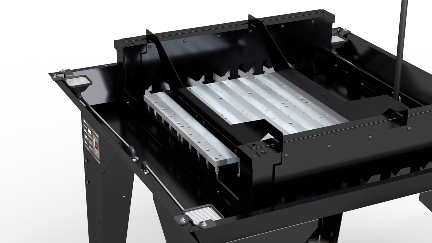

I was wondering if there are locator pin or holes for aligning the rails and the base plate?

The baseplate doesn’t actually have or need precise alignment to the XYZ coordinate system of the machine, except that the surface must be parallel to the XY plane. Thats accomplished by decking off the baseplate after assembly. Note: the baseplates are coarsely located to the Y axis rails by the baseplate positioners which can be seen in this picture:
The Y axis rails are made parallel and coplanar during assembly, so there are no dowel features to locate them.
