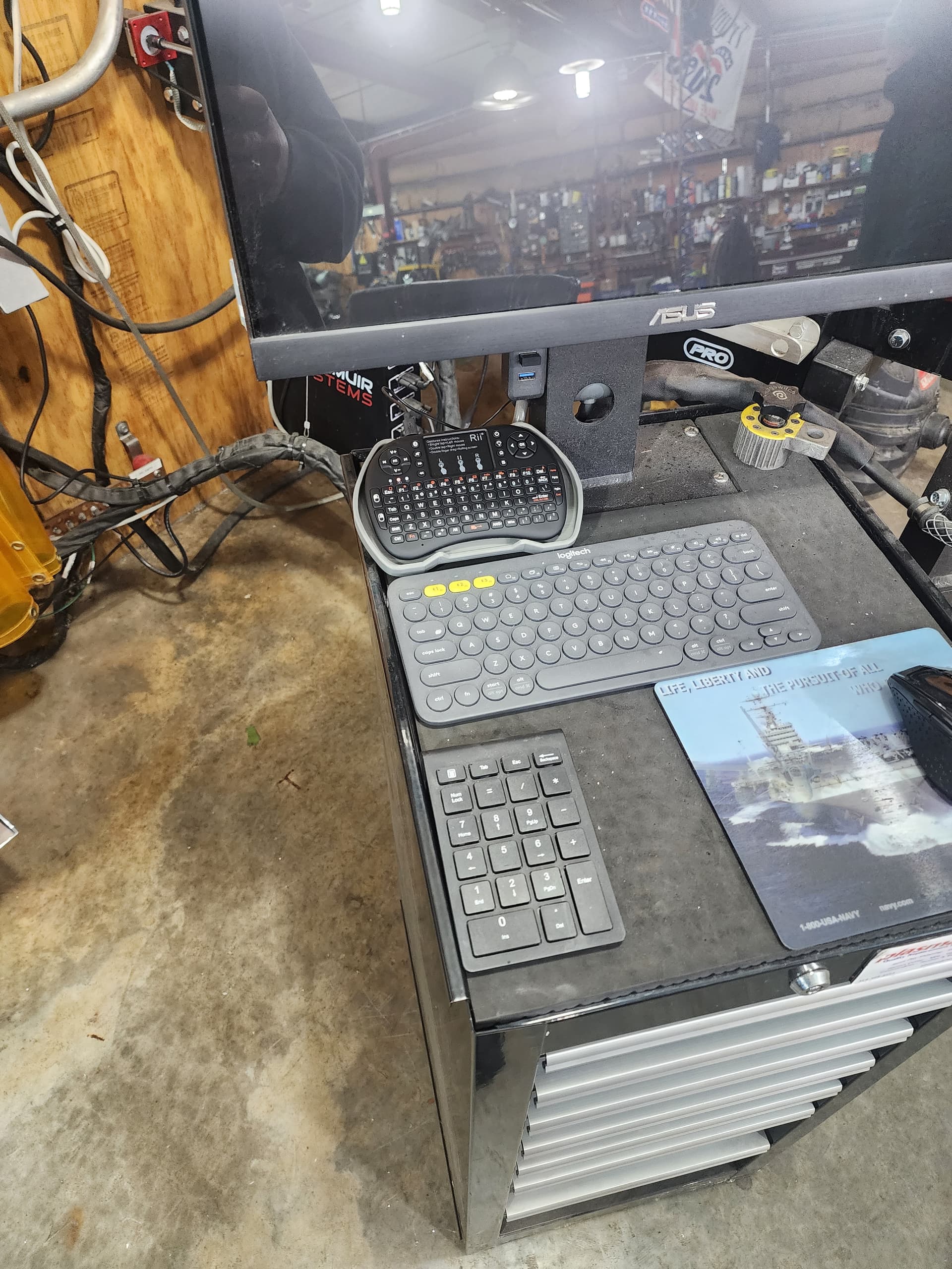

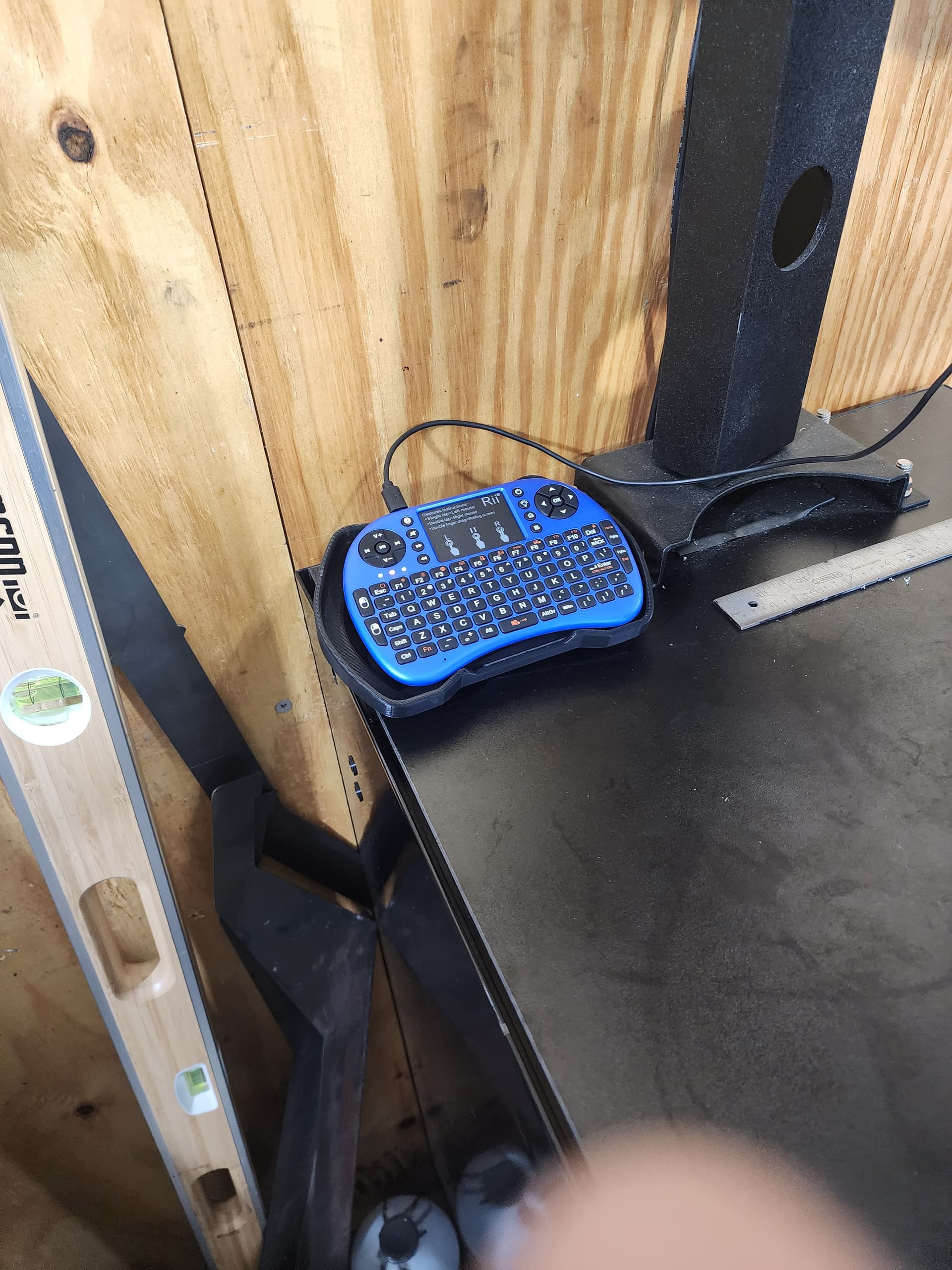

A random thought that occurred to me while looking over cut control and the keyboard shortcuts. I think the specified mini keyboard will have it’s place but I would like something with bigger buttons.

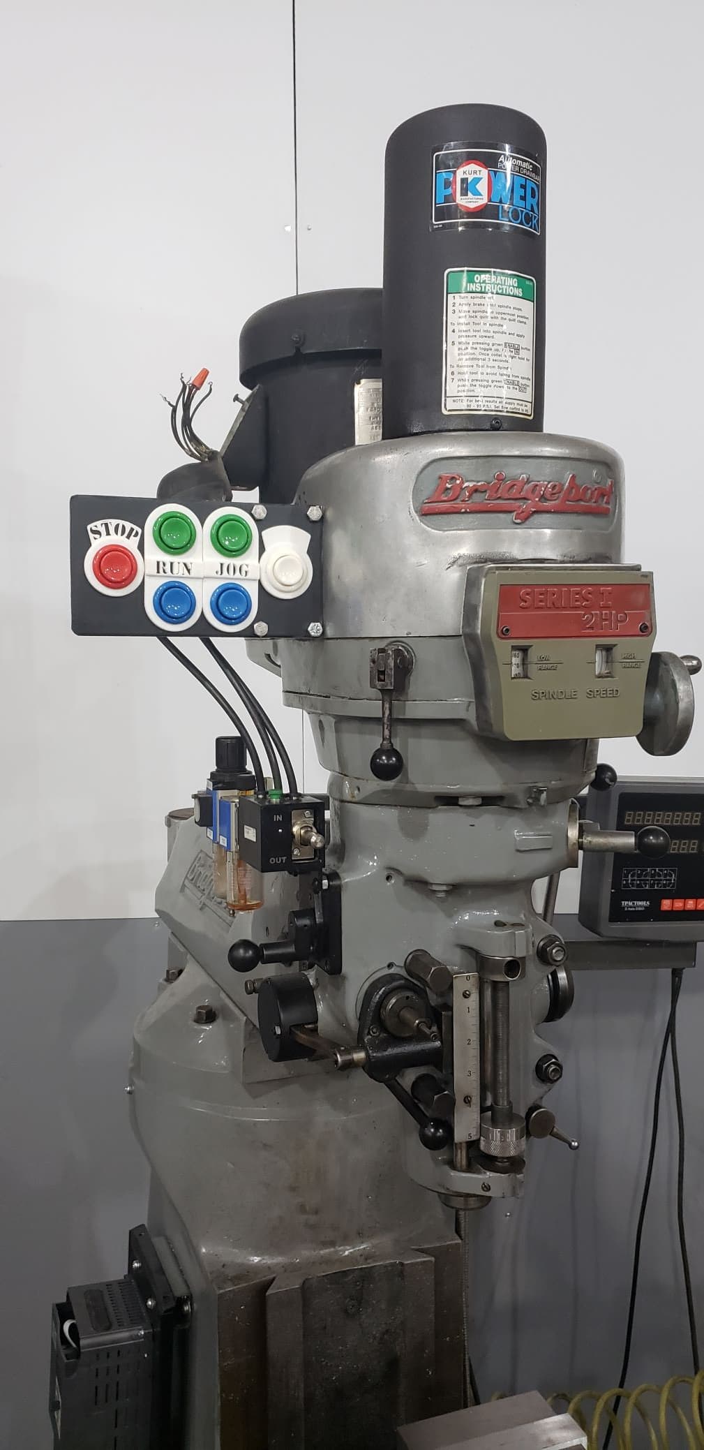

So what about arcade controls? Very cheap, usb interface, configurable for what the buttons do. I’m thinking of a small mounted panel with a joystick for X-Y motion and buttons for Z+, Z-, start, and stop.
Using a kit like this: https://www.amazon.com/gp/product/…
Or maybe something more plug and play: https://www.amazon.com/Arcade-Joystick…
arcade example
Some might scoff at using this in an industrial application but I say why not. I did something like this on my Bridgeport using a VFD and it’s awesome to use.
Thoughts?

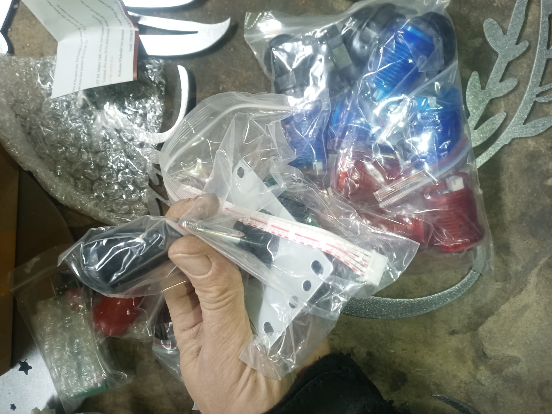

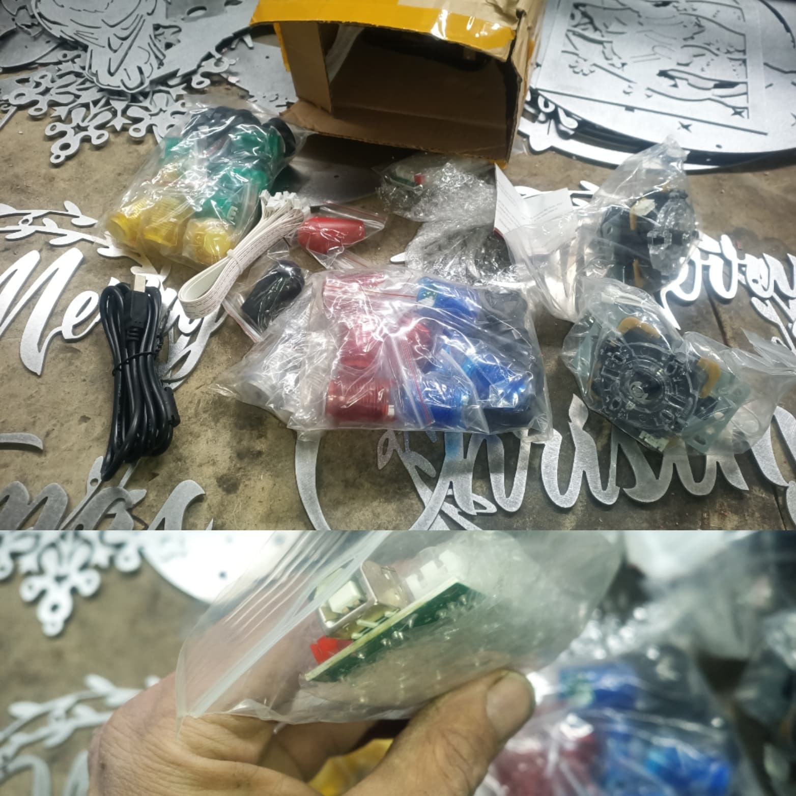

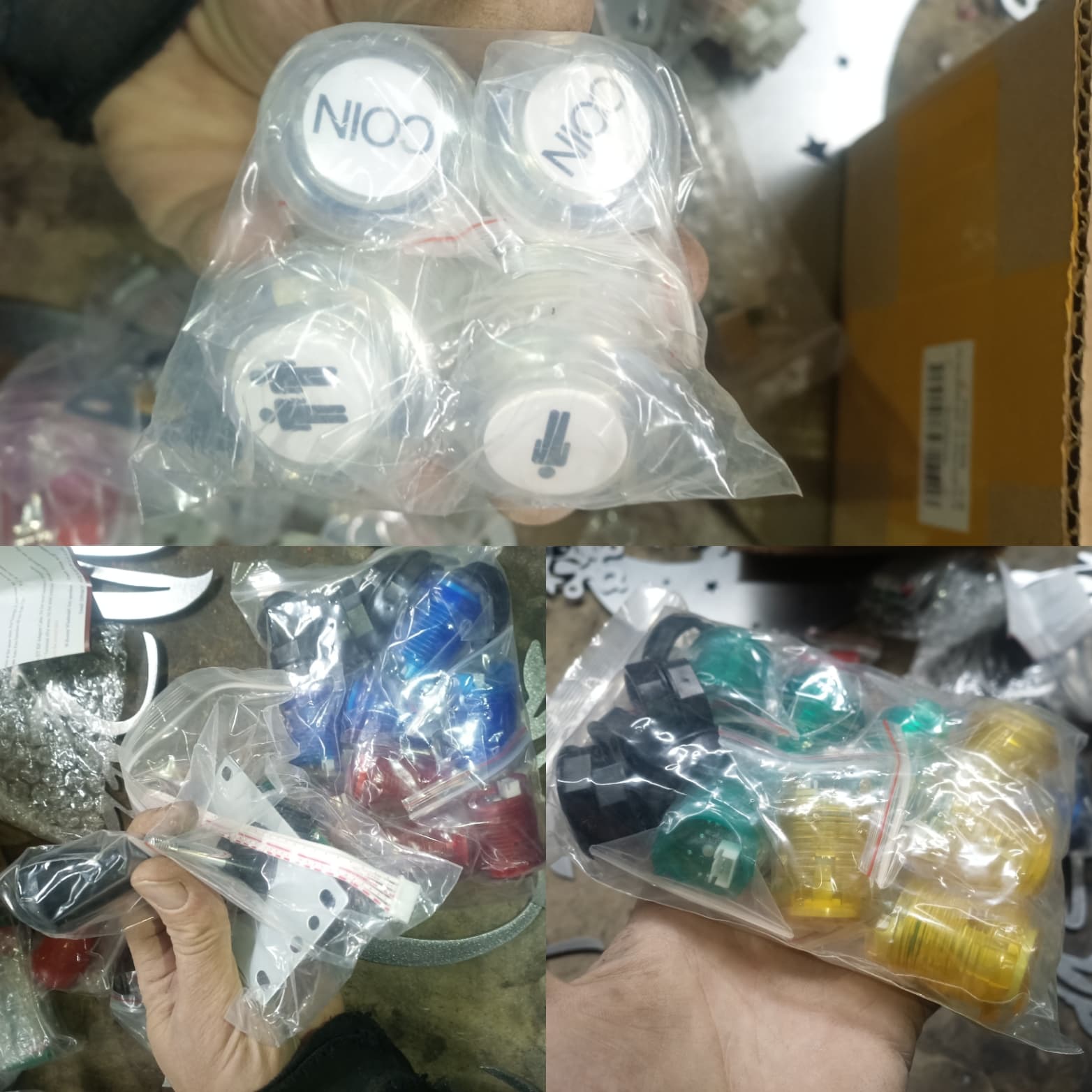

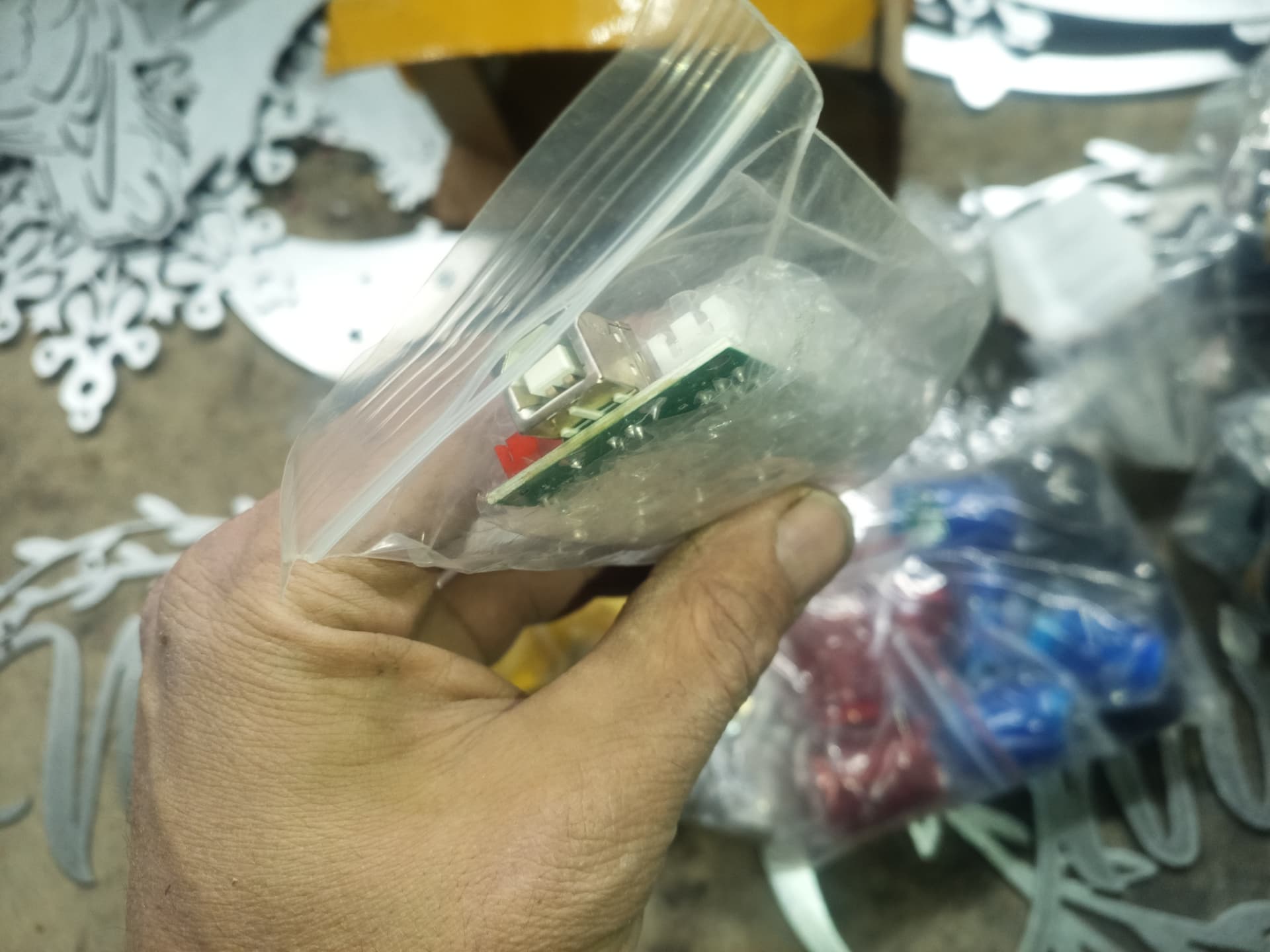

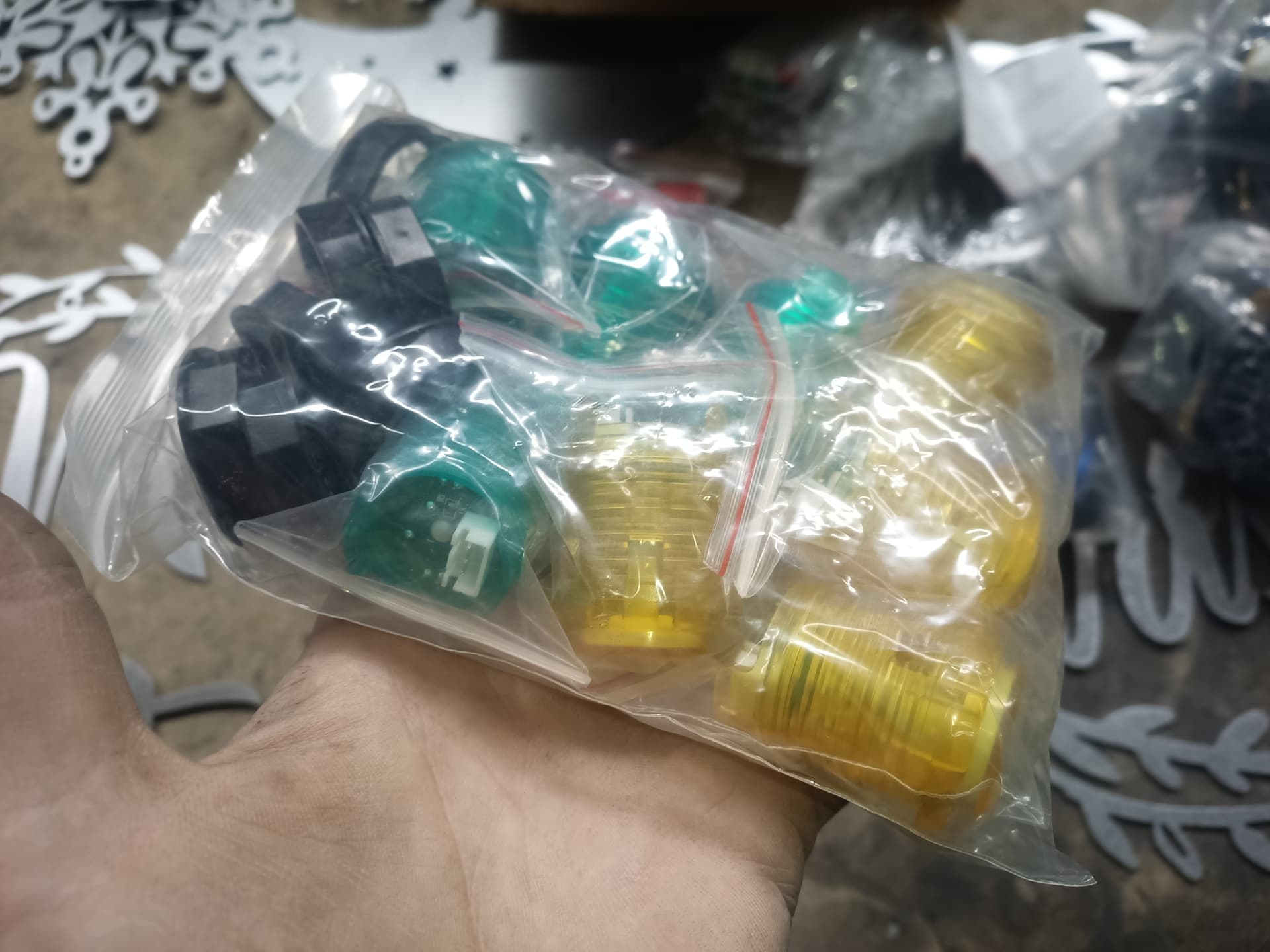

I have a couple box of goodies to go through for just this very thing.
Arcade joysticks too
It’s exactly the same kit as you linked above

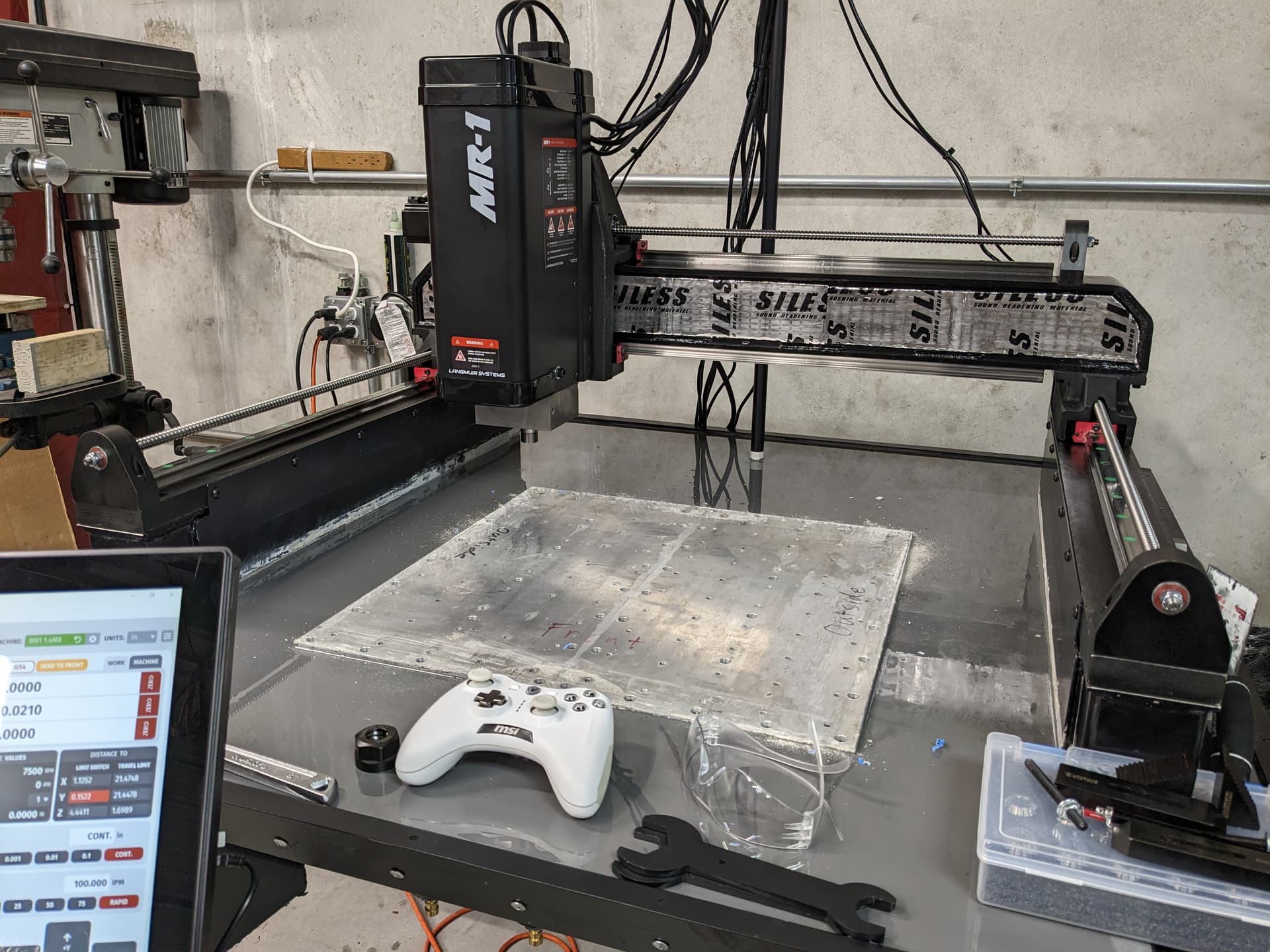

I did similar with my old grizzly and an Xbox controller. It was unbelievably helpful!
Brilliant idea. I was going to just get a simple MPG set up but your idea is pretty cool.
The x box controller is pretty cool! Another option to consider now ha
It went off Mach3, someone had already made a plug in for it to use the controller as a pendant.
But I bet with something like PP Joy, you could easily map out the axis and use them as “key strokes.” But that’s kind of conjecture as I haven’t actually had a chance to checkout cut control yet

I’m not a fan of the pendant keyboard either. Battery contacts were broken upon arrival. I used a wireless Xbox controller and mapped (Joy2Key) a joystick for XY control and the D-pad up/down for Z and left/right for tab, etc.

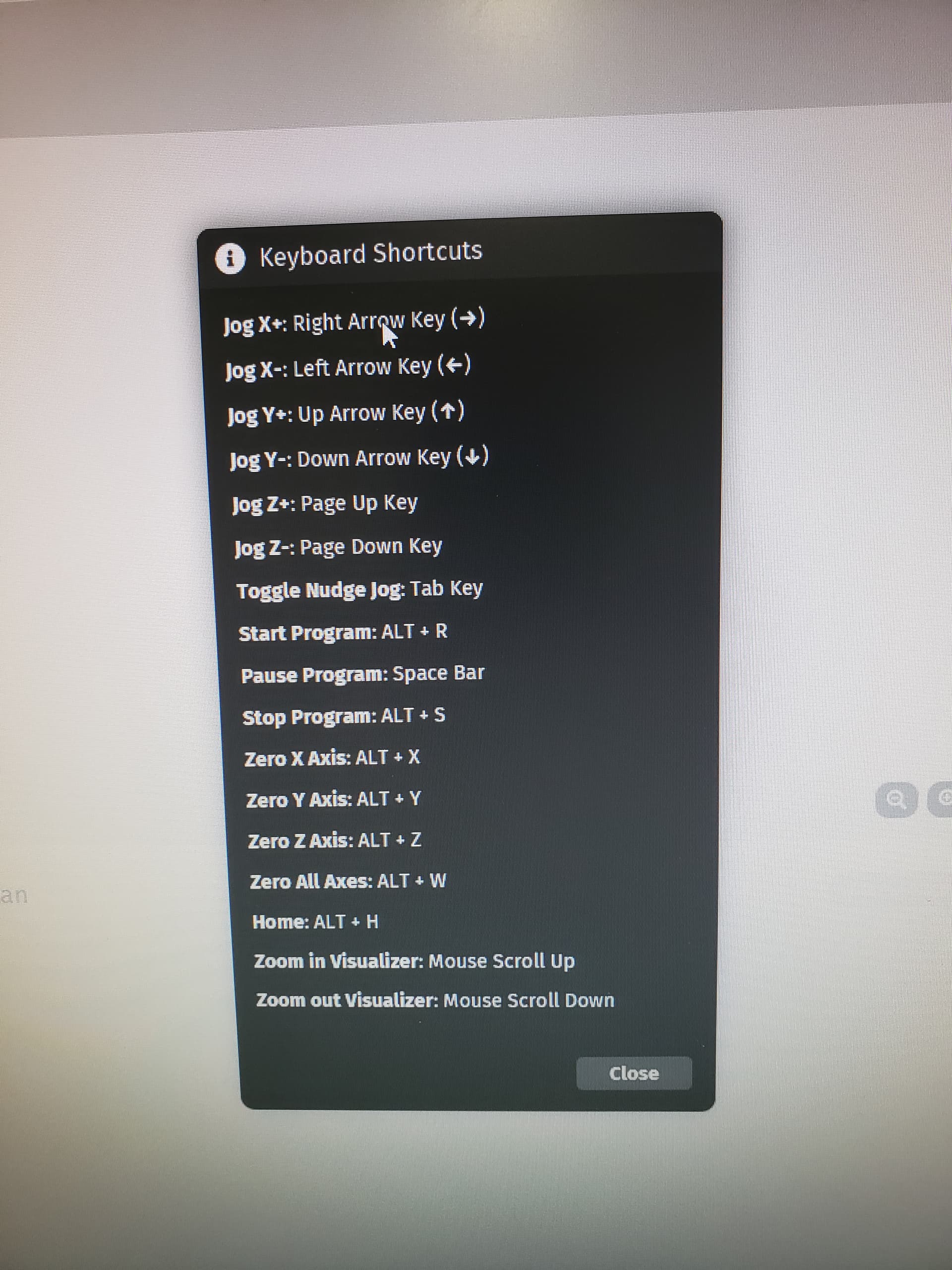

And yeah, @Rotator definitely interested in seeing if you can get that pendant to work for you. Those definitely have a lot of nice options. Unfortunately, with the way the software interface works, I was afraid the biggest hurdle with one of those, is to figure out how to map the buttons without being constrained to the built-in keyboard shortcuts.
