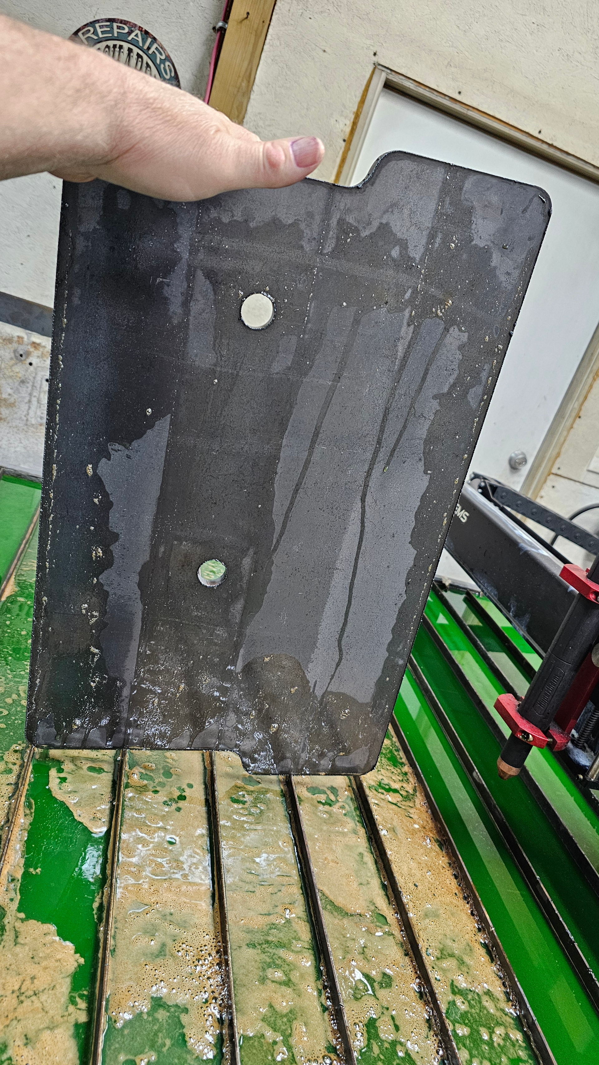

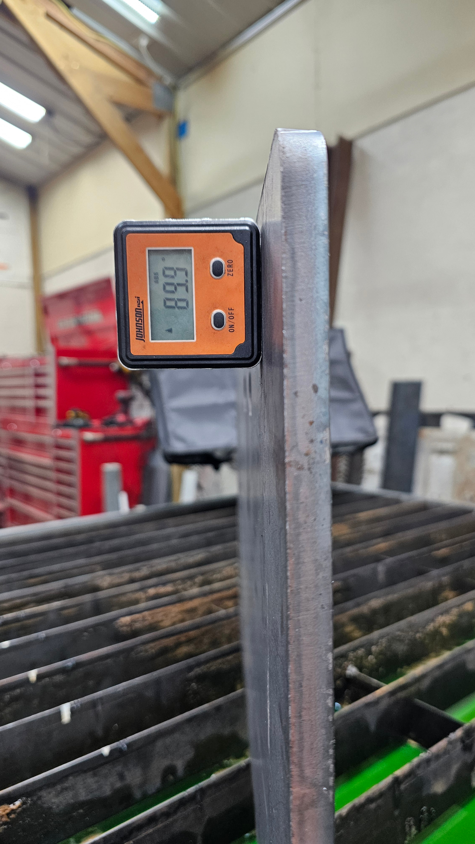

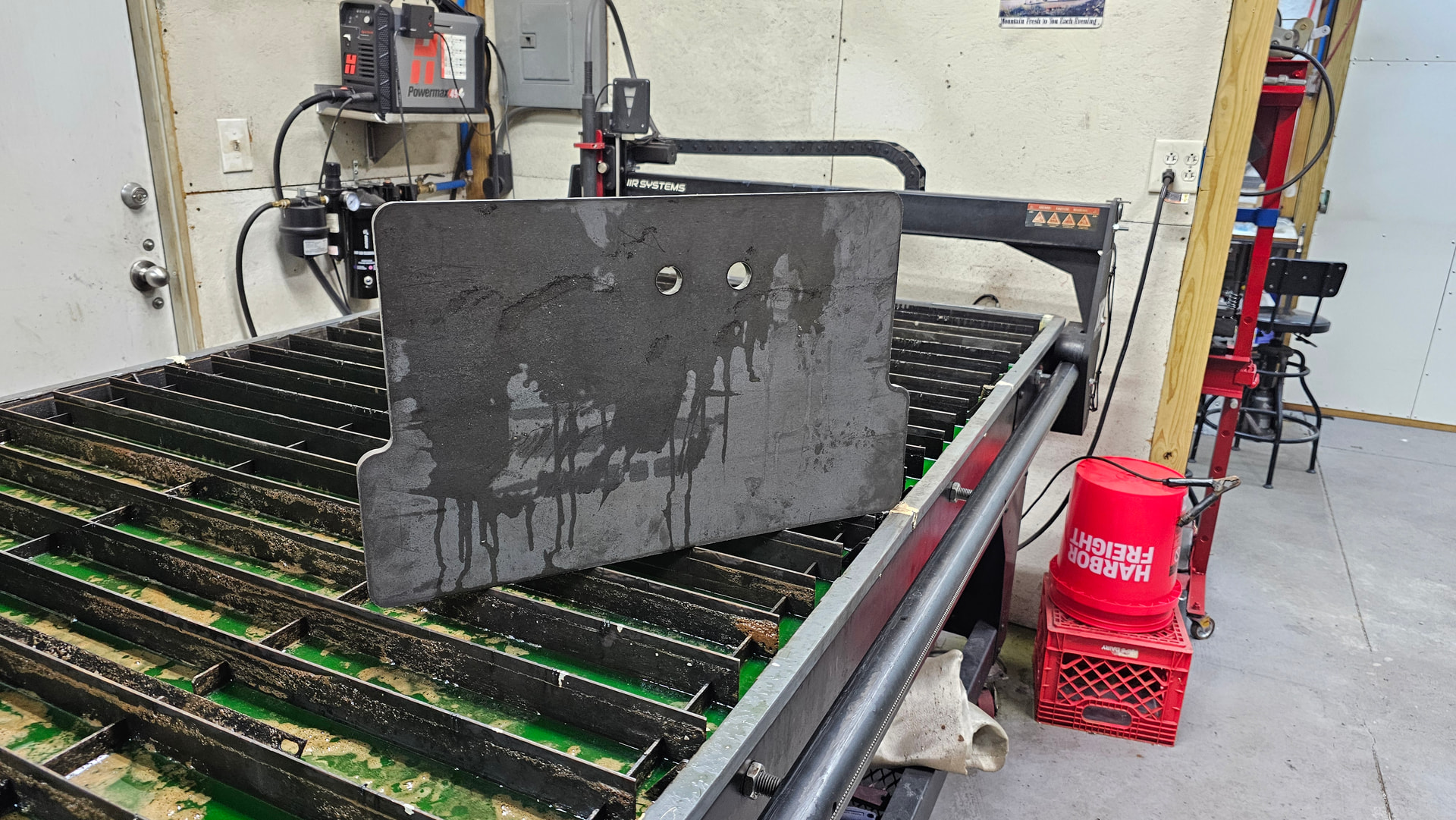

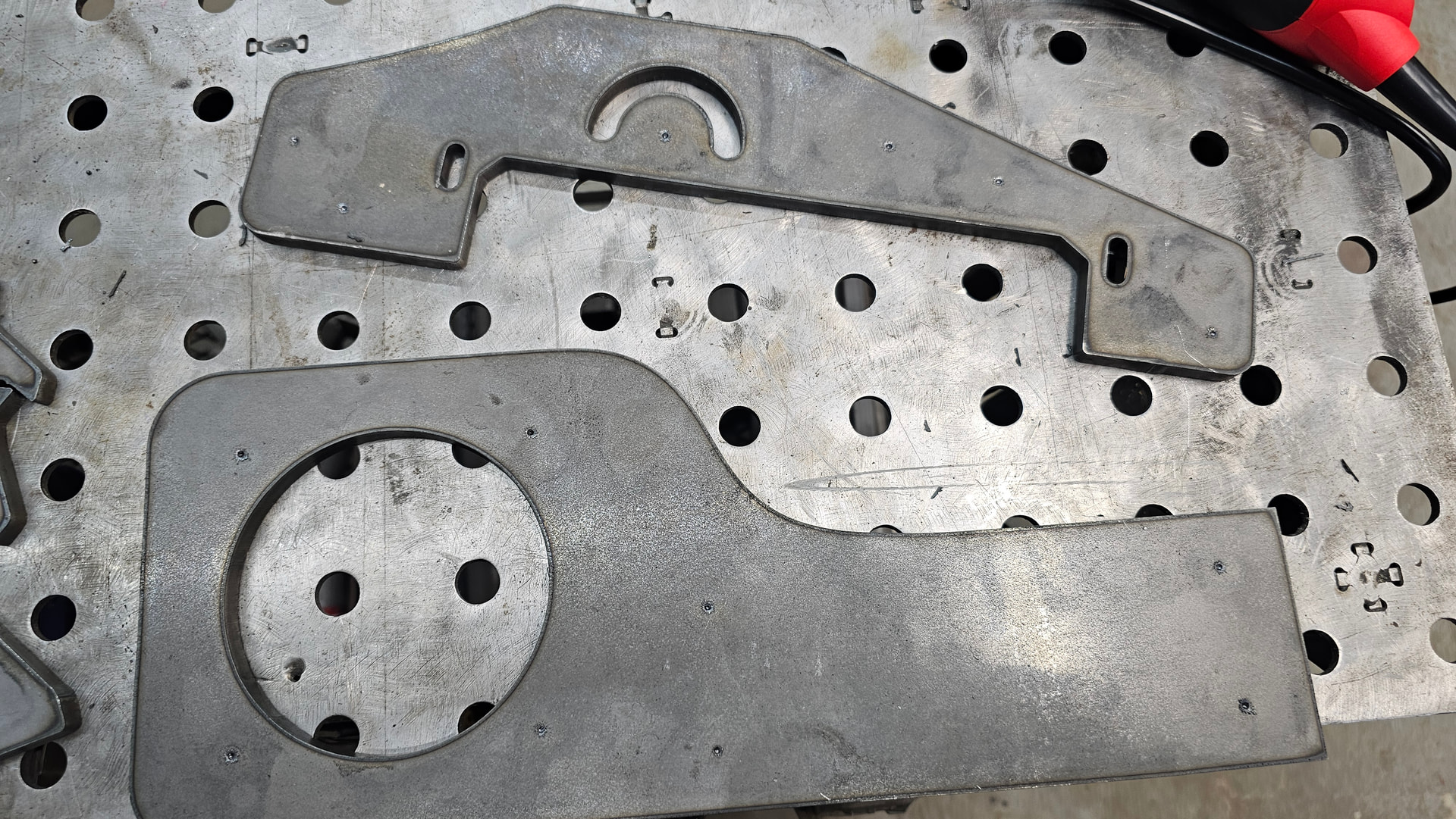

@rat196426 has gotten some of the best quality I’ve ever seen. I know he has some great pics of some half inch he’s done.

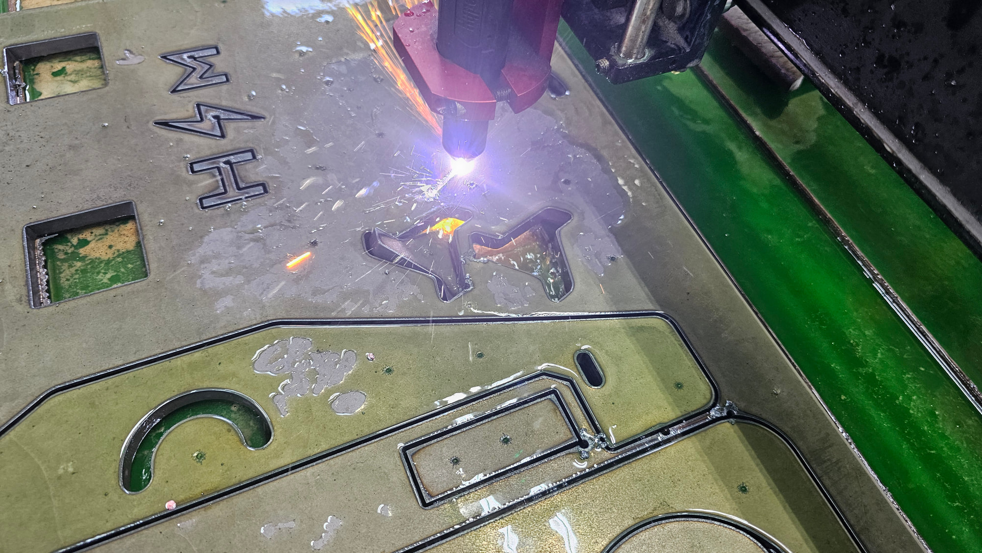

https://forum.langmuirsystems.com/uploads/db6772/original/3X/b/f/bf2530c979b5c44e35ce33e2278523c29473949d.jpeg
You could probably patent that! I doubt there is prior art!
HaHa,just good square cuts .
