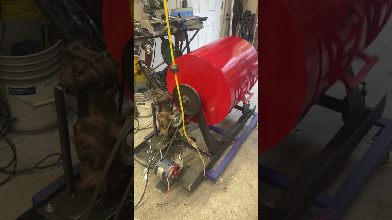

I use this same bowl to deburr the aluminum parts when they come of the MR-1. works great!
mine is almost done…
That’s empty right cause it sure is quiet
Looks good what’s the dim’s?
yup it is empty…I put a few things in it earlier…yup…noisey all right…
so … BIG RED…
the main cylinder is the center of a large commercial compressor that is 24" in diameter made of 3/16" steel…
I capped the ends with 3/16" plate
it is almost 30" long…
1" shaft
it rotates at around 20rpm…
it is run by a 1/4hp 1720rpm motor wish goes through a gearbox I found somewhere that allows me to reduce 13:1 ratio…then with the pully sizes it gets down to 20rpm.
there are 3 paddles inside for tumble action…
gotta a bit more work to do to “Big Red”
