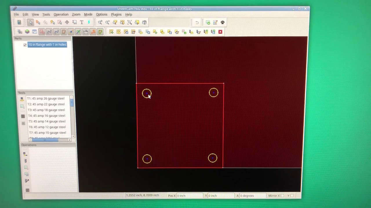

I’m wondering if there Is there a way to mark a hole center on a piece of steel with the plasma cutter for drilling later?

What cam program do you use? Seem I have read in sheetcam you can do a drill operation and just pierce. You could always just do a smaller hole. I believe you should be able to get it dialed in to the point drilling isn’t necessary. I use sheetcam I also start in the center of holes smaller than 1 inch.

I am using sheetcam. Still just getting into that. I would think there should be a pierce something or other. In the Hypertherm manual there is something about “marking”. Not sure what that is about either… When I was testing the torch the other day I plugged in the hand torch and pulled the trigger to see if it would fire. It did fire. It pierced a piece of 1/2" plate about 6" away that I was using as a sort of backstop. Left a blob of steel on the facing surface but the backside had an almost perfect t 1/8" hole. Pretty surprising. Thought it would be a big mess.

Search on here about piercings for drilling. The marking you can search here too. It just scores the material. It takes special consumables also I believe.
Understanding you are using SheetCAM, I believe I’ve seen references to a center only pierce for holes. (Search should bring up the relevant threads.) I do know that the Forum modified Fusion post provides for a center pierce, however I’ve yet to use it.
so what you want to do in sheetcam is use the “drilling” function…
I recently cut and made a Houseworks Generation 5 belt grinder and used the “drilling” function in sheecam to mark all my holes that needed to be accurate…worked like a charm as it pecked the center of each leaving a tiny little mark.
then I went on to drill all the marks I needed to be drilled…easy…

I use the drill function in sheetCam as toolboy suggested as well, here is the marks it leaves in material to be drilled.Doesnt hardened the steel easy to drill holes, marks the centers accurately. The black marks are where hole is marked, looks and feels like were marked with center punch. Ignore two holes on the one plate, I wasn’t paying attention and forgot to pause torch after last hole was marked.

Just tried the marking process. Sheet cam has a marking setting under drilling. I had 16 Giles to mark. The torch fired for the first mark but not for the rest. For now, I made a file for each hole rather than trying figure out how to get the torch to fire again.
