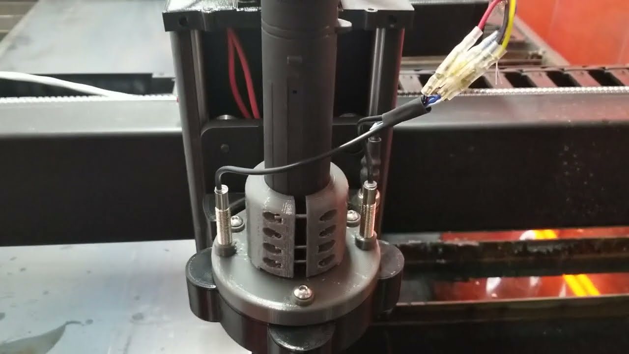

You can use a keyboard emulator to accomplish this. You can also build a collision detection system to pause when it hits tipups. I have built both of these for use on my table. If you do a search you might be able to see some of the different ones I have made. Makes life a lot easier. Here is a video of one iteration. If you search my videos I may have the pendent on there, don’t remember.
Thanks for heads up. Ill definitely take a look.
