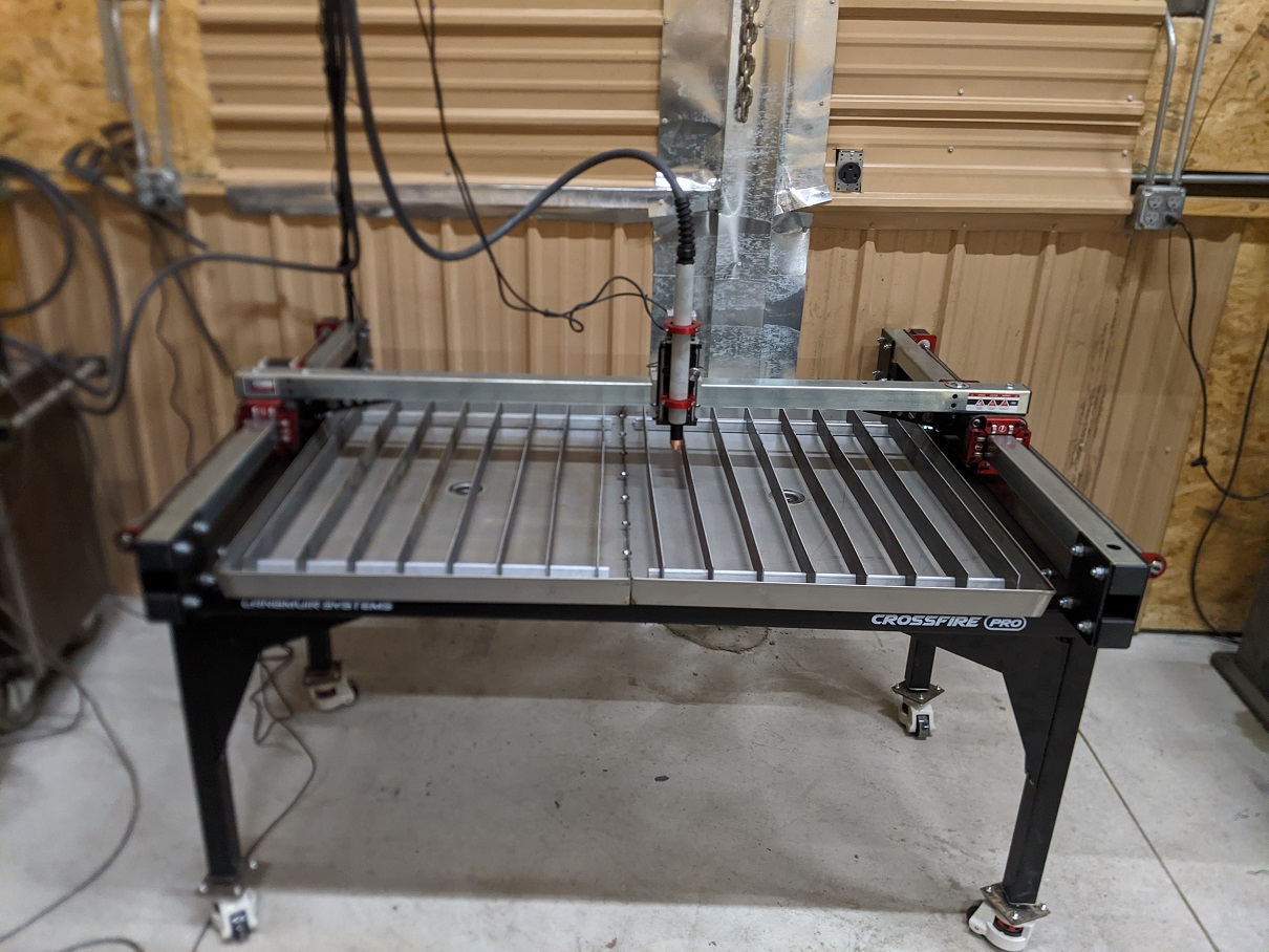

I got the last box on Friday and after removing what had to be a couple hundred staples I did the assembly on Saturday. After much reading of posts here that went pretty easily, I’d say the trickiest bit was the bearing pre-load. Getting it to be just in contact without too tight, but enough pressure so it doesn’t jiggle was tricky. I went back and forth several times tightening, then loosening, but it worked fine first time jogging.

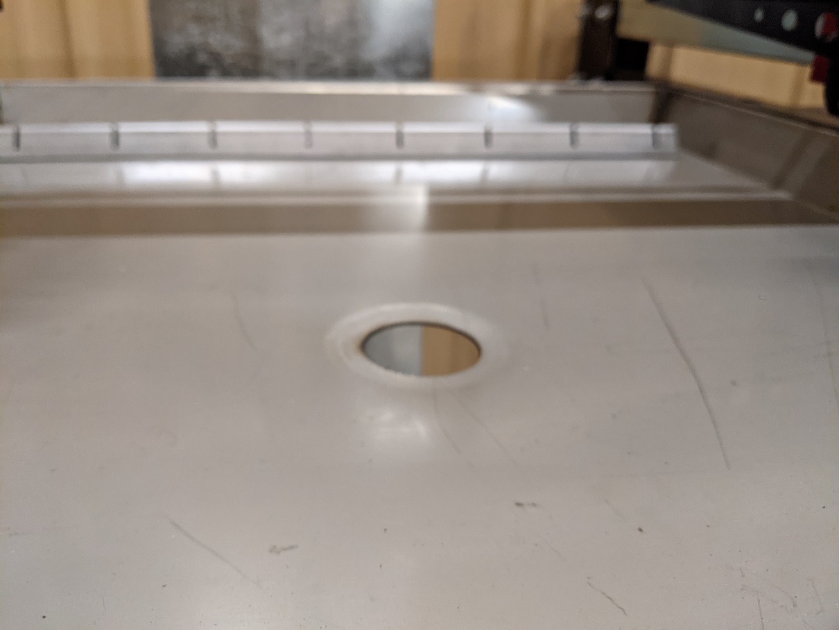

Then the first cut was to enlarge the drain holes for bar sink drains:

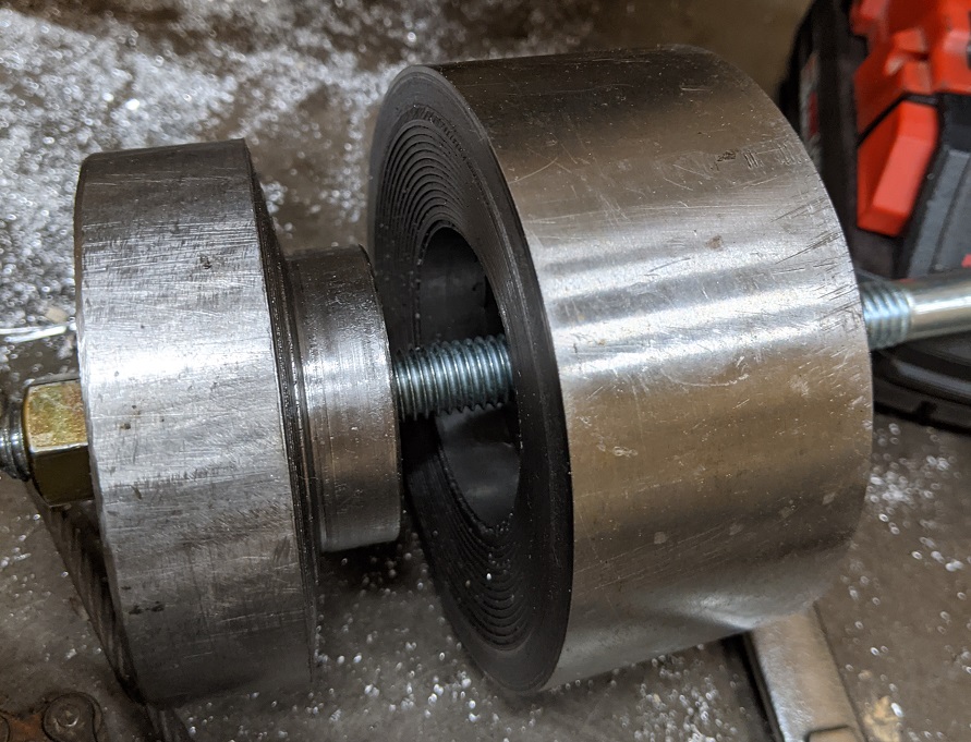

Today was making the dimple die on the old Monarch EE lathe. Cutting the stock on the horizontal bandsaw took a while for the 4" diameter stock, maybe 1/2 an hour, but unattended while I worked on the 3" piece for the other side of the die. All told a few hours of manual lathe work. As I was finishing up stepping the slope out I realized I could have done it all on the bridgeport CNC instead of manual lathe, but I love working with the old lathe.
it did a decent job on the hole, maybe could have been a bit more dished, but should be pretty close to flush with the plumbers putty.

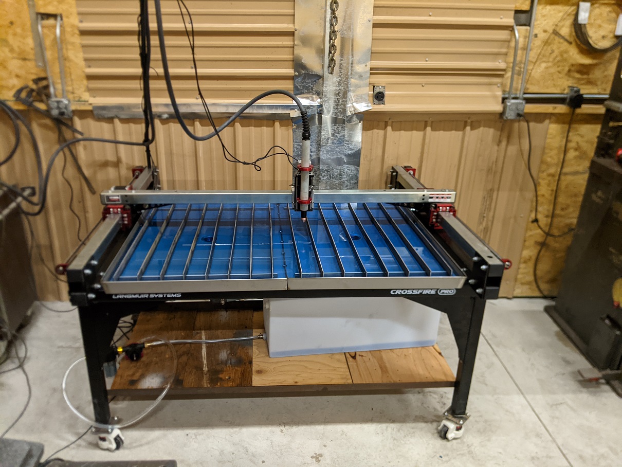

Ready for water (with magic green stuff)
Next is to do a shelf underneath to hold a tank & pump setup so I can drain easily & be able to move it around when I need to do indexed cuts, etc.

I’m not nearly as exacting as @Cletus but I’ve got a tank & pump with filter so I can drain & refill fairly quickly. Just a drill driven pump since it was pretty cheap.
I’m wondering about the wood shelf material, not sure if sparks will reach there and how much fire they would have left. I’ve got some nomex fire retardant fabric leftover from another project I could drape around as a skirt if it seems like a potential issue.
