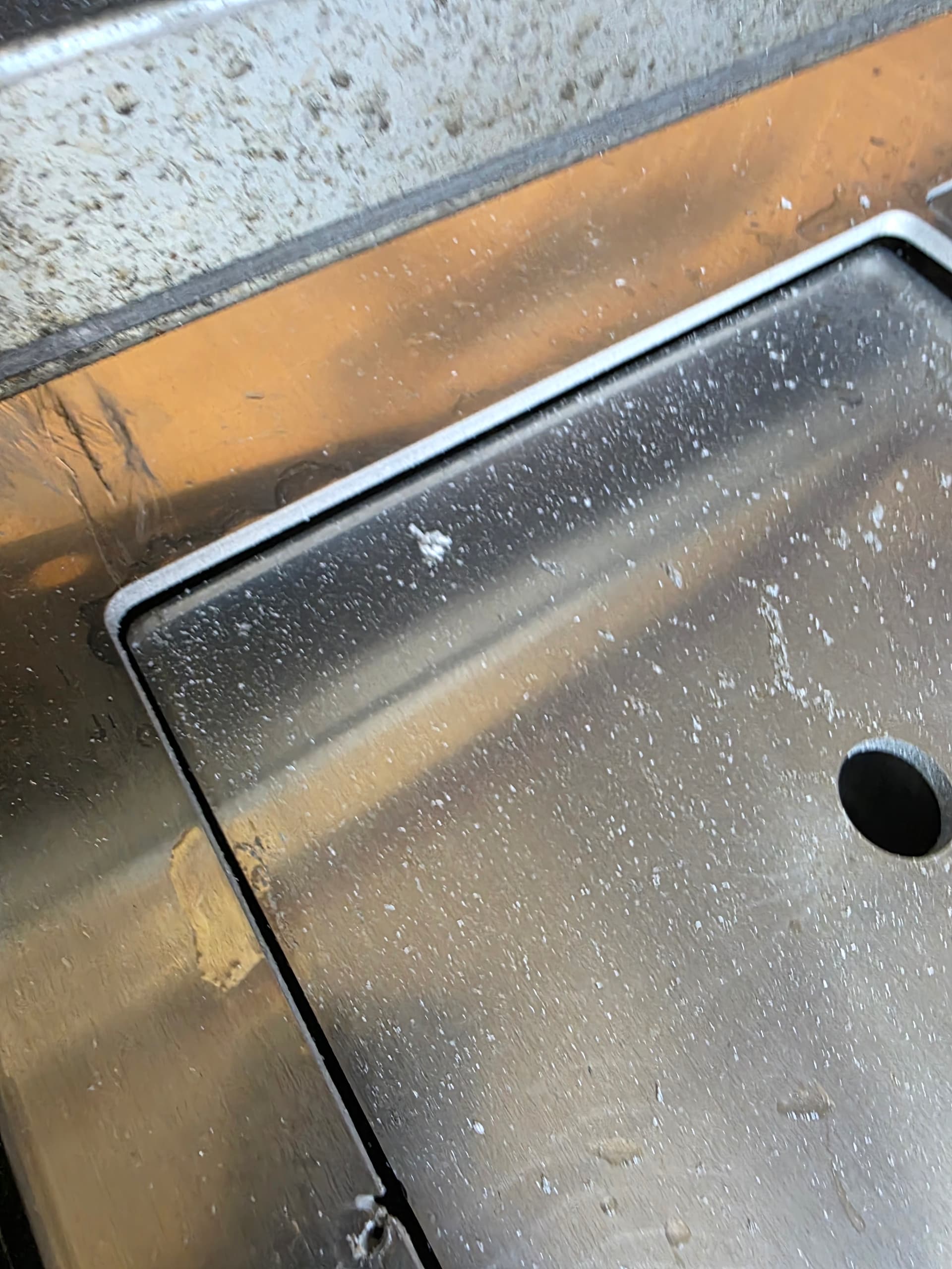

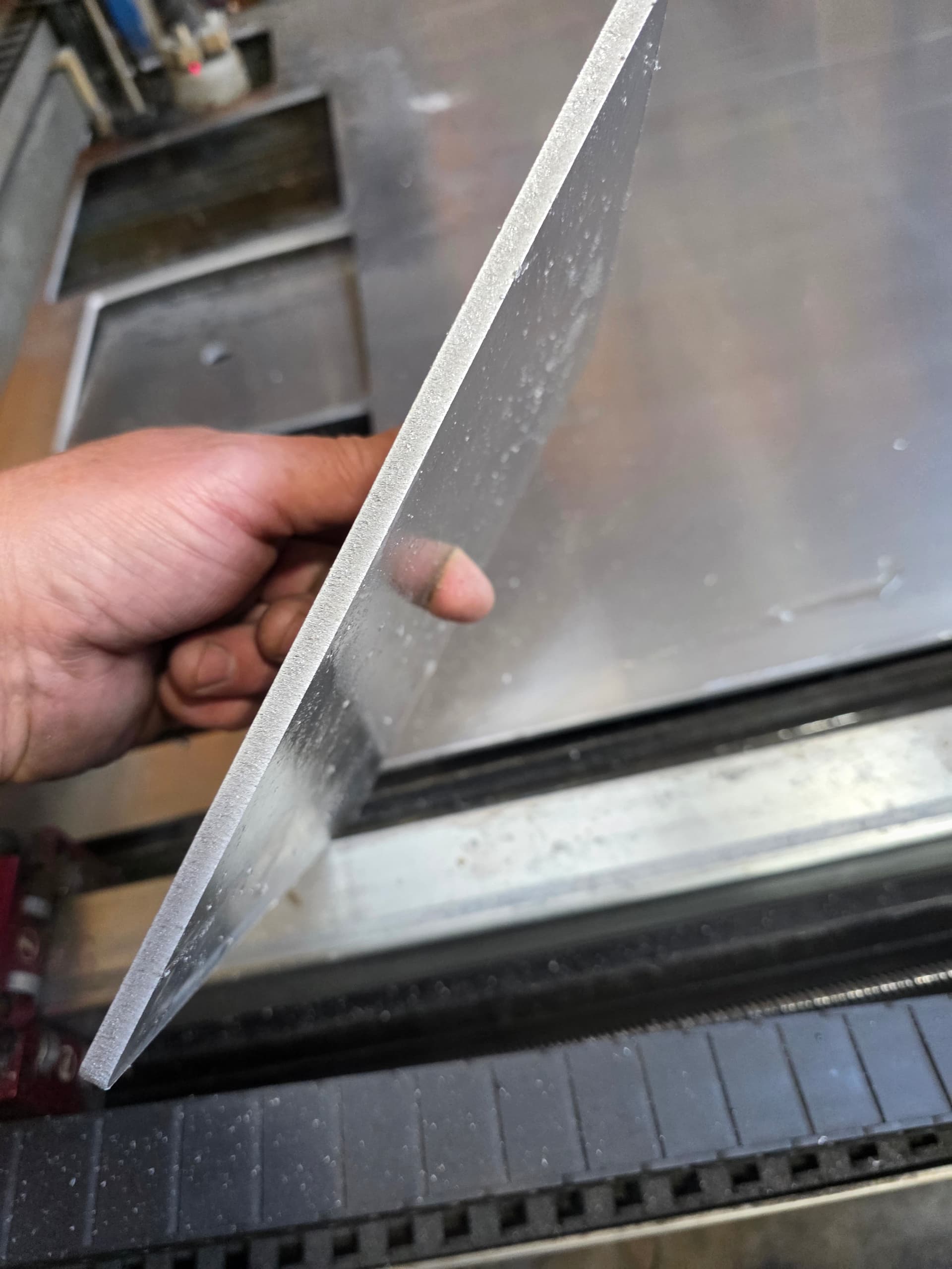

Aluminum cutting with Nitrogen
Everlast 82i with 75 psi nitrogen instead of air.
Now thats how to do it.:grin:

Wow! That is super clean!

Now you just need to wire in a switching valve so you don’t waste the gas during post flow.
Great idea. I have two 3000 Nitrogen bottles and an F5 bottle plumbed into a manifold. It uses whichever bottle I’m using. The nitrogen bottles last a month or so, depending on the amount of aluminum I am cutting. I don’t use it for anything under 1/4 inch. If I want to cut stainless steel, I open the F5 bottle. I have a separate supply pipe and use a quick connect to switch between air and the specialty gases on the wall behind the plasma table. It makes a significant difference on thick aluminum. The main benefit is that it shields the edge of the aluminum from oxidation from the air stream. I imagine argon would work as well, but it is much more expensive, although I have never tried it.
A single manifold with a row of valves, and 2 electric solenoids (NO and NC). One to regular shop air, the other to the manifold output. Wire the solenoids to the plasma fire relay, an an override switch to default to shop air only.

So do you get as clean of cuts if its under 1/4" and just air? Wonder why thickness would matter?
I find zero difference below 1/4 inch. I guess the IPM doesn’t let it oxidize. I’m not sure of the scientific explanation.
