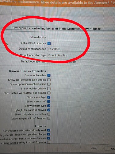

so, i havent used Fusion for a month or so. i have been designing a new piece. went from the “design” workspace to the “manufacture” workspace and it has changed… okie dokie should be no big deal BUT all my saved “Plasma cutting Machines” have disappeared out of the machine library on my computer. i can no longer find them. many of them i had dialed in for the feed speeds/pierce delay and such… has anyone else ran into this?
so i tried creating a new “plasma cutter” in fusion, and now it wants to know “max interpolation mode”, “max block processing speed”, etc etc etc… ugh! it was so simple before. what am i doing wrong?
You can try going to the settings preferences. Scroll down and find “Turn on Library.”

that did it. thank you everyone
