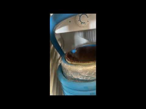

@Sticks Here is a video of my diy refrigerated air dryer. Works amazingly well and super cost effective!! let me know yalls opinions. For the guys that are not fans of pex for air lines…I have already taken those suggestions into cosideration. As always copy my ideas at your own risk…i do use alternative products in unique ways and dont suggest you do the same, however if you choose to be safe and use common sense! This has drastically extended the service life of my consummables!

I completed my air system. Everything works great with a few exceptions. The timer switch is wonky, need to try a different one. It works but the light don’t stay on. Not sure why, because it is wired correctly unless I’m missing something. Two, the AN8 connectors leak. Hard to tighten without twisting the copper pipe. There were no other leaks.
In the pic I added the dissecant can to complete the system. I still haven’t put together my crossfire yet. LOL. Priorities. But I did use my handheld cut40 plasma with it and it worked great.
nice and tidy…my question is what is the inside diameter of the couplings on the blue pipe connectors?
yeah, well, that is a rub. I purchased the ½" kit but the inside diameter of the fittings is closer to ¼", so I guess they market it as OD, not ID. Which is scammy because the other pipe fittings are ½" ID. In any case, I’m not concerned because this will feed my cutter sufficiently and I’m not a production shop. But its annoying.
