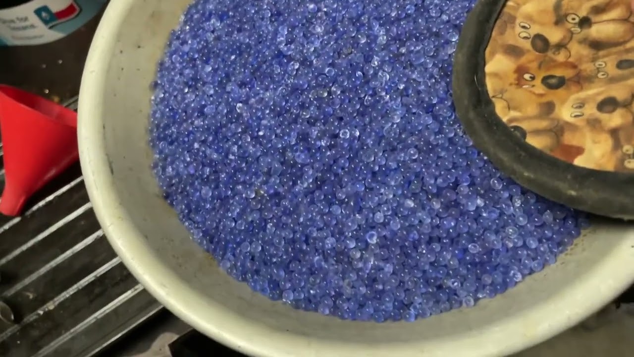

I made a refrigerated cooler using pex and an old mini fridge that is doing a really nice job. And for the record I was a huge proponent of the cooler between the compressor head and tank. It did indeed pull lots of water out of the air, and kept my tank dry. Moisture was still making it to and through my desiccant with A dry tank. And someone on here mentioned extended run times. Sure enough my compressor was running significantly longer each cycle with the inter cooler in place. I temporarily removed it an d tried this diy refrigerator cooler and love it. I use pt60 consumables not exactly know for their longevity and am getting 900 plus pierces now and when I view the inside they are still shiny copper.
How thick of materials are you cutting getting 900+ pierces?
16 gauge. Running a 45 amp harbor freight nozzle for the titanium. (It is on my Everlast machine) I am cutting at 32 amps. About 62 psi with air flowing.
I have a video of the dryer, my desiccant and the inside of the nozzle. I can’t figure out how to load it here.
I host it on youtube and then post a link.
sorry for delay. i had previously posted it elsewhere on here i though. anyway here you go!
