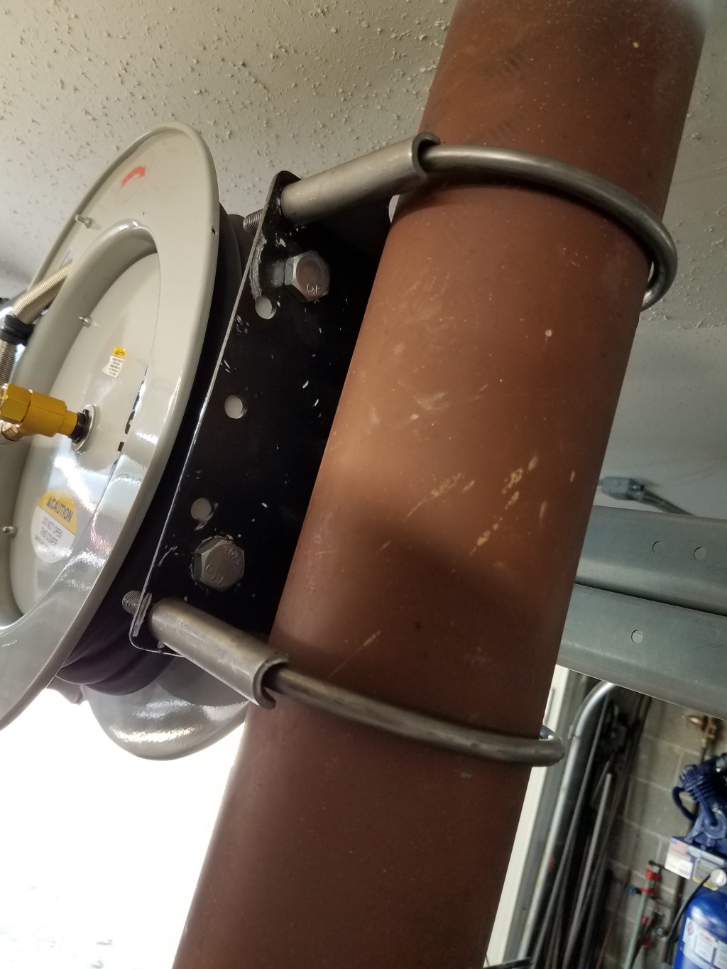

Made a nice 1/8" bracket for my hose reel - about the only place I can figure out to put it is mounted to a 4" support pole in garage. Designed in F360 with some McMasterCarr exhaust brackets.
When the brackets get here I’ll get a shot of it mounted. It has the 1/2" 5x4" bolt pattern for the hose reel and several outside holes for the exhaust brackets.

My 4" exhaust brackets came in today from McMasterCarr. Time to get the mount finished up for the hose reel.
Part Number I used is in the link below if you’re interested in doing something similar. I could have gone down one size I think, but this was what they recommended for 4" pipe.
The original design in Fusion360:
Quick prime and paint job for the plasma cut mounting plate
Brackets and plasma cut mounting plate in place! Solid - not going anywhere!
Fastened up with 1/2-13 bolts in 4" x 5" pattern. All 1/2" holes in the mounting plate were cut oversize to 0.5312 and 3/8" holes to 0.3970. Still it was pretty tight fit up, but no re-drilling required.
Mounted and ready to go!
Northern Tool Part # 62249. I like the cold flex line so far.
Nice simple little shop/garage project that went from concept to design in Fusion 360 to cutting the mounting plate on the Crossfire Pro - ordered brackets from McMaster Carr and installed. I like it! ![]()
