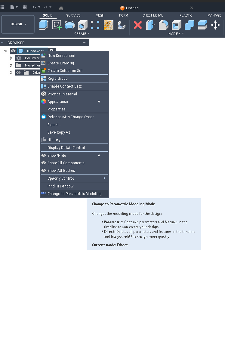

the other thing I would suggest is when you start a new model make sure that you’re in parametric mode instead of direct modeling mode.
This can be done by right clicking the first component in the browser bar on the left hand side scrolling to the bottom of the menu and change it to parametric modeling.
The benefits of this is giving you a history to work with which makes changes and navigating far easier later on.
