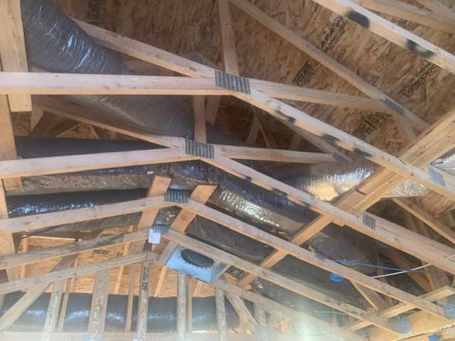

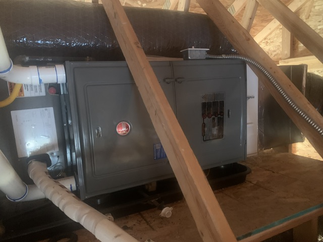

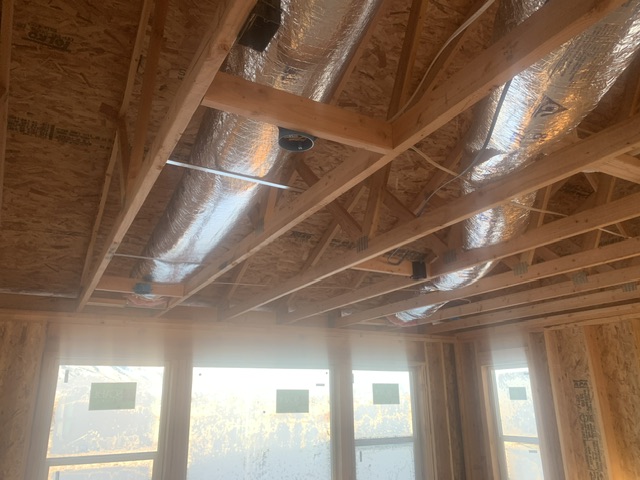

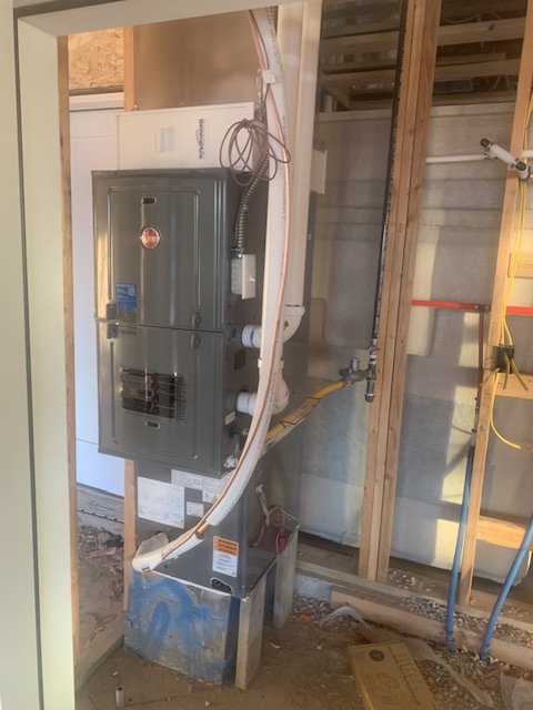

Some pics of the hvac install. AC units are still in boxes sitting in the garage. It’s still to muddy to pour the pads.
I have more pics if there is something specific you want to see.
More pics

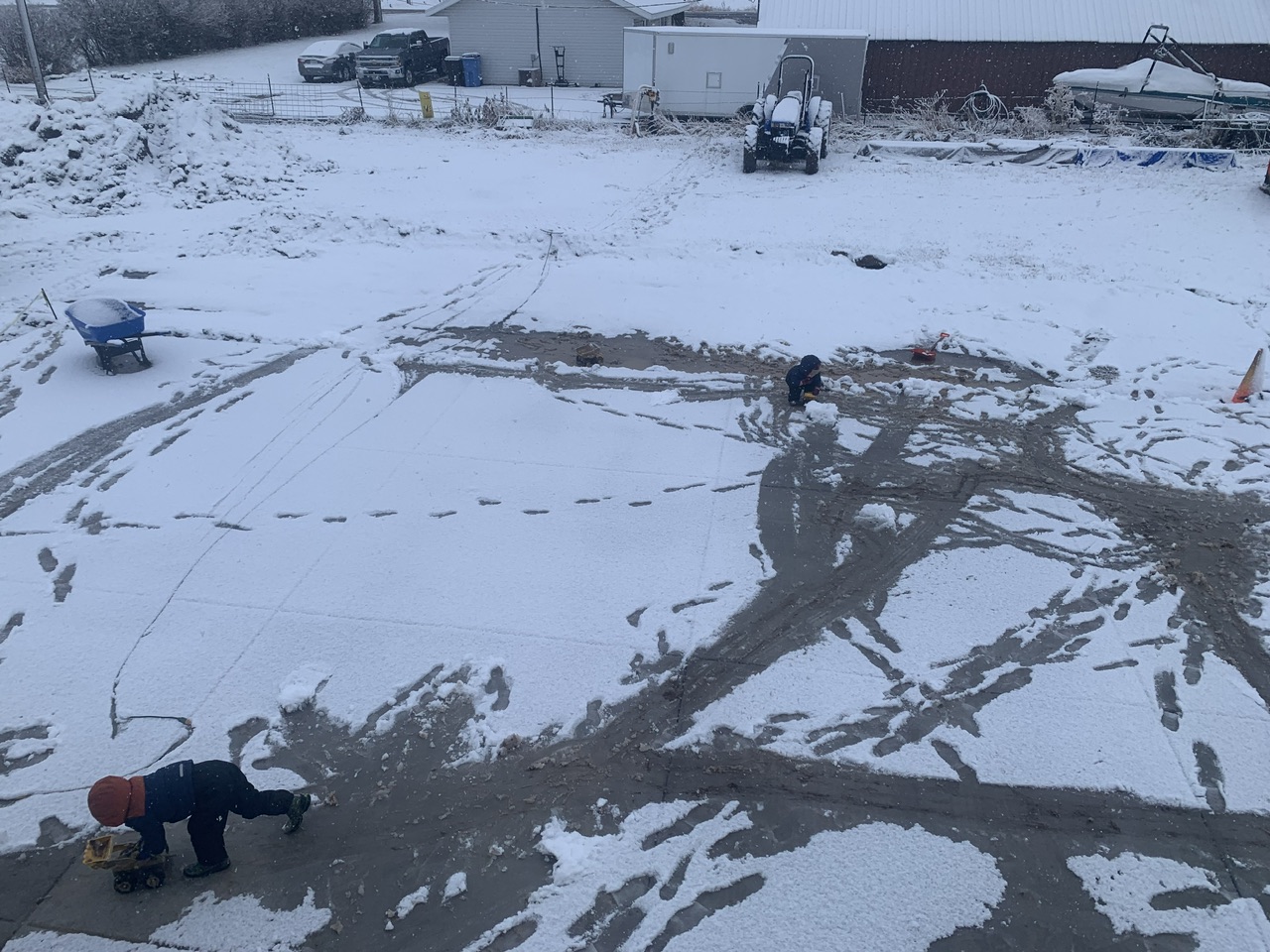

Boys clearly snow off the driveway with their toys!

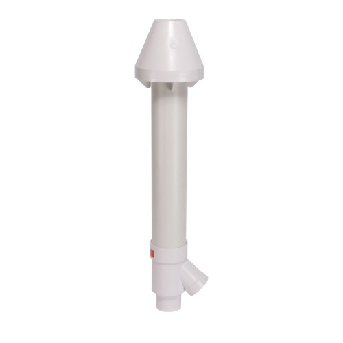

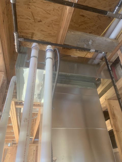

It’s not a coaxial vent on the furnace?

Is that downflow unit go to some underslab ducting? In Canada we get quite strict on having ductwork in unconditioned spaces like the attics. It’s looking good. Lot of different ways of doing stuff.
I do a lot of the rheem modulating equipment with the heat pump for dual fuel systems.
Yes, it is a slab on grade, the ducting for the main floor is underslab. I think I got a picture, but I couldn’t find it. After they installed the attic furnace, they insulated around it.
It’s hard to tell in the pic I posted but after the door was installed in the mechanical room you couldn’t get the filter out. They had to come back and modify the duct so they could slide the filter housing over a little. Now the filter barely slides out if you hold your mouth just right. :stuck_out_tongue_winking_eye:
No, it’s not. I haven’t seen allot of those around here. They seem like a good idea. Not sure why they don’t do it more.
BTW thanks for your help fixing my grammar and misused words. I need to do a better job proof reading before I hit the reply button. :grimacing: :stuck_out_tongue_winking_eye:
I’m sure the pipes are costlier, but it seems more efficient and safer. Maybe @TinWhisperer has some info on Coaxial vents vs conventional.
Well on most high eff furnaces they can be vented in two or three inch plastic pipe.
Depending on your region that will either be PVC , true ABS or S636. This two pipe system may come coaxial together as it exits the house or it may not.
I think most of the coaxial systems are envisioning would be off older style trailer furnaces or different styles of new on-demand water heaters.
With a furnace whether you go to coaxial or not is a matter of convenience where you terminate to the outdoors.
Here in British Columbia we basically operate under the most stringent code in North America so all PVC type S636 for us.

Is the downflow unit a r97mv and the upflow unit in r98mv? Or are they both the r962V 's
You should let me know the model numbers of all your components so I can match them up to an ahri directory to see what kind of combined packages they’re putting together for you.
Another thing I would do is buy yourself a cheap manometer to check static pressure after the fact. It’s sad to say but about 80% of the industry does no type of commissioning after installation just turn it on to factory settings and let er buck…
(Here is an example of our commissioning sheets)
You should see what kind of commissioning they actually do this is an example of a mandatory commissioning sheet for us here in British Columbia. It also includes having to submit a CSA f280 report which is the same thing as as United States’s ACCA manual j and then the duct work would need to run through the manual d ACCA calculation.
If you want to make your HVAC contractor cry ask him to provide you with the manual d and manual j calculation for your home it’s one of the reasons you pay good money for mechanical contractors.
This is what I have in Maine. Steel pipe, one inside the other. The fresh air comes in on the outside ring, exhaust on the inside pipe. The cooler fresh air cools the exhaust, while the exhaust preheats the intake air.
