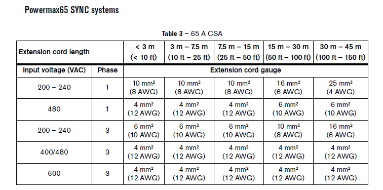

The other alternative would be to install the correct length cord on the machine and not have to deal with the extension cord. There should be a chart in the cutter manual that lists the appropriate cord size for a given length.
Here is the chart from the Hypertherm 65:
